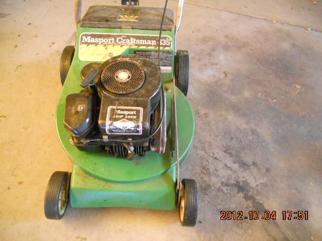

Joined: Sep 2012
Posts: 27
Hi Guys
here are video ans pics.[Linked Image]
Ok so what you have is a briggs and stratton 4 stroke smile
Straight fuel goes in the cap under the red circle.
SAE30 engine oil goes in the little screw in dipstick in the yellow circle.
If all the oil is drained these engines take 600ml from empty, check the oil level against the markers on the dipstick add some oil little by little until it is on the full mark, try your best not to overfill it.
I just read your pm that you are from wagga area, if your ever over this way let me know and I can fix it up for you, provided the engine itself is okay it shouldnt take very long in the workshop and will be inexpensive.

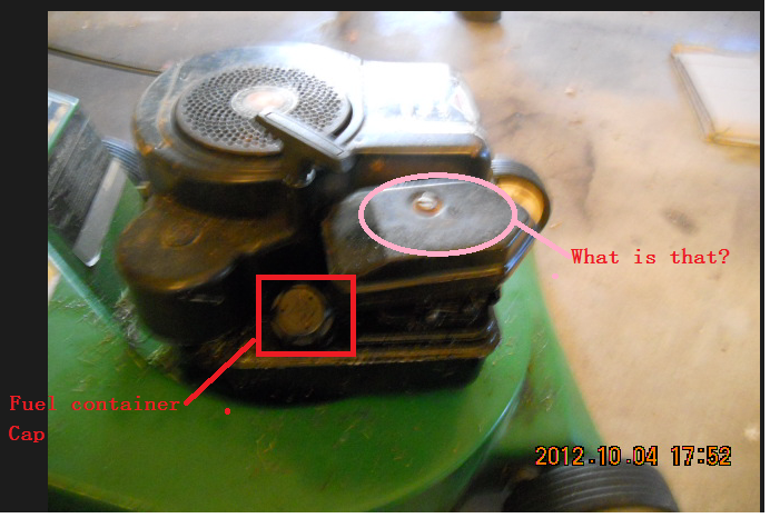

Joined: Sep 2012
Posts: 27
Hi Rodeobod
Could you please tell me which one is the oil Sump(see the pictures)? There is a fuel tank at the right of bottom (see front).
Joe, you produced a typo: Briggs and Stratton 4 stroke, not 2 stroke.
Leo, the fuel tank is screwed to the underside of the carburetor. It has a metal screw-on fuel cap on the top of the tank. You can't see it in the picture because the air filter is in the way, but it is near where Joe put the red circle, in the middle of the tank edge, straight down from the air filter. I have no idea what you mean by the Sumo of engine. Does this engine wrestle Japanese-style?

Joined: Sep 2012
Posts: 27
Hi Grumpy
Thanks for your reply. I could find the fuel cap, and I will check the yellow circle Joe mentioned tomorrow since I do not remerber what is near there.
The mower is made in New Zealand. I want to say is that I could not find the oil sump.

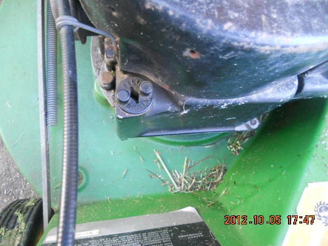

Joined: Sep 2012
Posts: 27
Hi Mark, Guys
I found the oil sump fill (see photo), and the question is that how to fill the oil into this small hole?
Hi Mark,
Should I loosen the screw to get the stick shown at the bottom of your photo?[Linked Image]
Joined: Feb 2011
Posts: 510
Leo, undo the oil fill with a screw driver in the slot, or use the knobs to lever it around, until it is loose.
Use a funnel to get your oil in.
If you dont have one, make one out of a soft drink bottle.
Remember, not to overfill it with oil.
