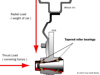

your happy medium is best once you have done it a few times its easy as you know , they kick back if they are loose and they lack power if they are to tight . the wear i believe is caused by the force on standard ball bearings, take car wheel bearings for example its designed with "tapered" bearings to take radial load as well "thrust load" where as a standard ball bearing is only suited to thrust although i must say it isnt taking the weight of a car like a wheel bearing does, it may just be a symptom of over tightening the belt. if a full crank does this imagine what a power torque will do... i was totally gobsmacked that the muffler was full of swarf from the crankcase.
cheers,mitch [Linked Image]

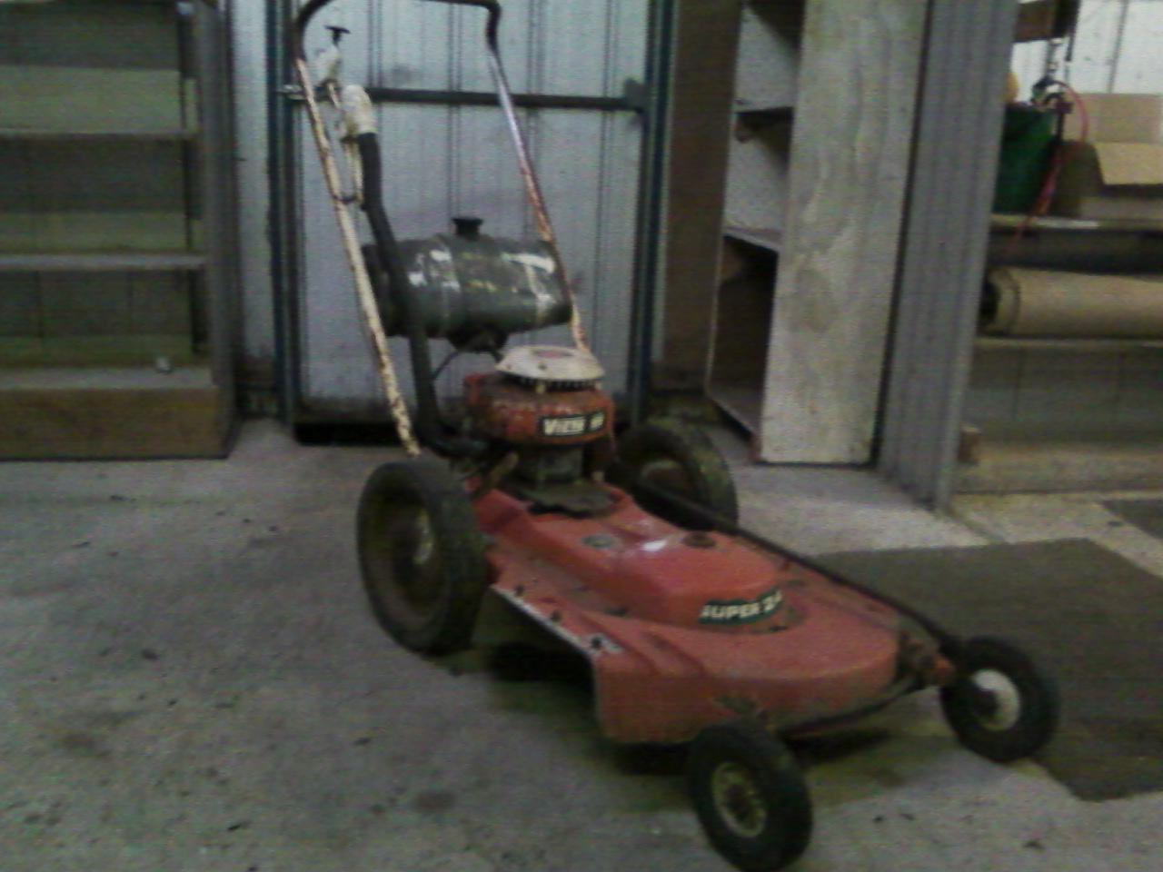

no longer have that one it was a vc160 motor. i have 4 original super 24's however all but one are at home at the moment ( moving house ) stand by for a picture of an original pre restoration . smile
Joined: May 2012
Posts: 467
got this one last week going to restore this one for the collection.
