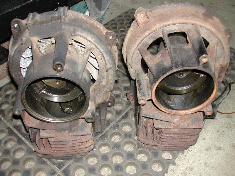

Hello.

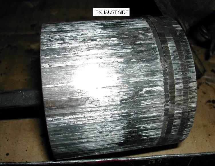

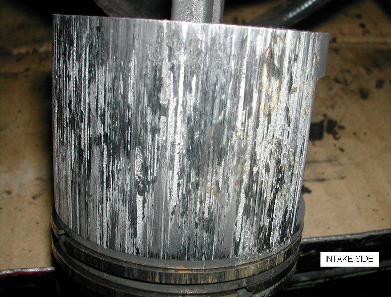

Have pulled down a power torque engine, piston is gone.
My question is:
Can I hone this bore?
Also
Can anyone tell me the difference between these two blocks.
I have always wondered.
Thanks much.
The difference between the blocks is one is a later model type where they used just one casting for the keystart/non keystart type, essentially the same engine though.

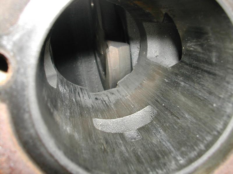

That bore would probably hone okay, as it would be mostly alloy on bore from the piston, if its cratched more than that though I would personally hoik it into the scrap bin.

Personally I would just get another block.I'm not sure honing will save it.It is more of a re-bore,then the cost would come into it.I have tried to hone one that wasn't as bad as that and it couldn't be saved,by all means try but I don't think it will work.Good luck though.

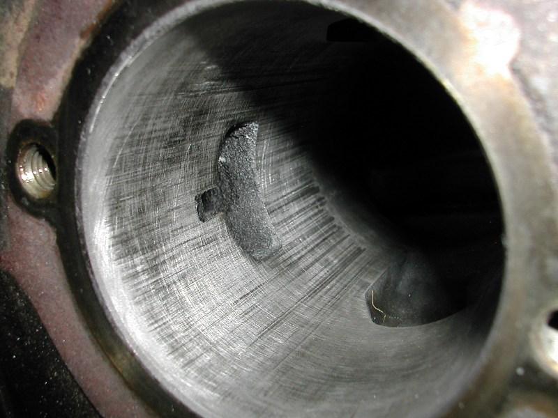

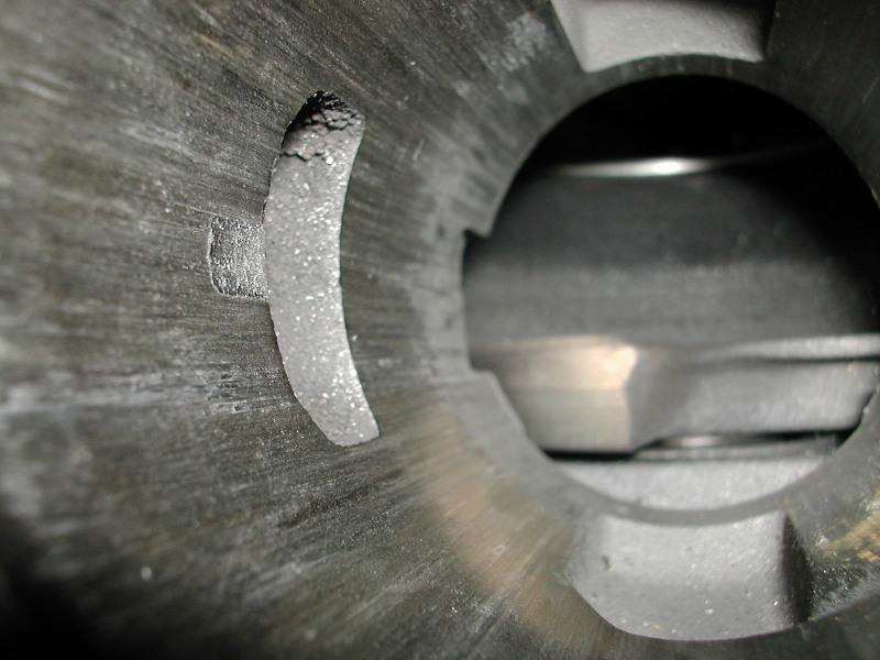

I gave it a light hone to see what I was left with.
I hate to say it but its cooked, but around bulk pickup time there will be one on a nature strip near you!

Well I tried, I will put this block aside.
Yes I didn't think it would work.Doesn't take much to destroy them.
