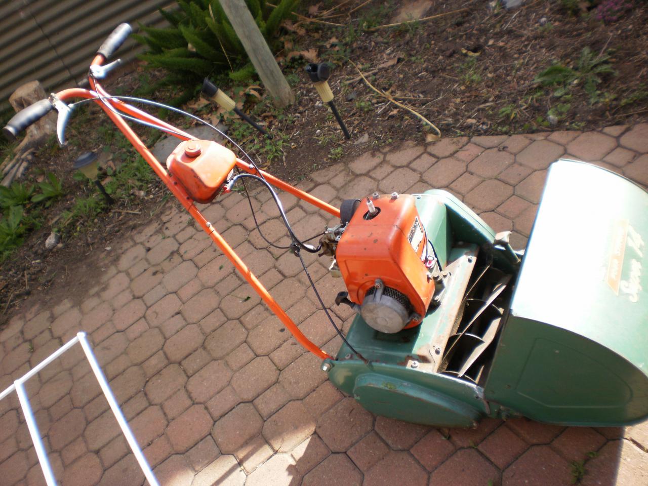

Hi Grumpy, Jason and Michael, the Qualcast Super 14 uses a Suffolk 4 Stroke engine, from the UK, and may have (from memory) a centrifugal clutch. It is quite a large engine physically and may have a completely different mounting specs than that of the Honda. Here's a pic:

I think any collector would prefer it with the original engine. Substituting an engine that was never an original equipment item for that mower, has a negative effect on collectibility. If the mower was a rare one (which yours is not) it would be important to make the substitution without drilling any holes or making any kind of modifications, while keeping the original engine stored for later re-installation.
