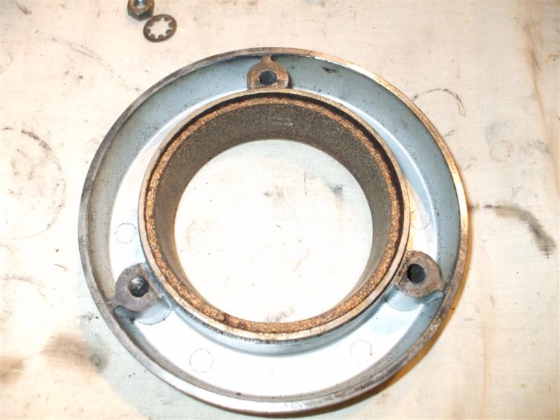

Below is one of the outer clutch half showing the cork clutch lining....all good here.
