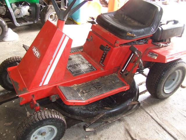

Hi all new here, I have a rover ranger xc model 252707 type 0224-01 code 82020111. I am trying to locate the lay out diagram of the drive belt, including the idler arm from the motor pulley to the gear box,also the lay out of the blade drive.I am not sure about the belts I have at the moment, could any one help as if the belts are A or B and what number should be fitted

Thank you for your assistance, I will work from your diagram and see if I can relate it to my mower, I replaced the drive belt , not sure if I replaced all parts correct,the main prob is the main drive belt will not disengauge when I used the brake/cluch,I have the same prob with the blade drive I think I have the wronge ajustments on all

Allan, I'm not finding the diagram easy to follow, mainly because I don't have the machine itself here. The owner's manual says that the wheel-drive clutch operates by tensioning or releasing the drive belt: you push the pedal to declutch, then pushing it further applies the disk brake. From the parts diagram, this seems to be done by a push-rod that attaches to the pivoted link on which the jockey pulley is mounted. It sounds as if you may need to adjust the length of that push rod, so that the pulley slackens the belt when you push the clutch down, before the brake is applied. The owner manual tells you how to make the adjustment. Unfortunately the photocopy in the manuals section was made in black-white, not grey-scale, so the pictures are useless. However the words make the process fairly clear. My current interpretation is that there should be a clearance of 3 mm between nut 67 and block 78 when the clutch pedal is not being depressed.
Please post some pictures - it will help us all to understand the system, and will improve our archives after your problems are solved.

Thank you for your help, SUCCESS yes after playing around with the ajustment rods ( idler arm ) and clutch/brake I finally got all working.
I have added some pics but was unable to add captions
Pic 3 blade engage/disengage lever
Pic 4 blade drive brake ajustment
pic 6 brake clutch engare pedal
pic 8 main drive and idler arm this has a rod running up to the front where the ajustment is made also for the disc brake this was where my main prob was as they work in conjunction with each other ,thank you once again and hope pics help other members

Glad it has worked out Allan. It sounds as if the clutch pull rod adjusts at the front, not the back as I had guessed.
I'm having trouble sorting out the mechanism in my mind, from some of the pictures - the pull rod attachment to the idler pulley pivoted link, and its attachment and adjustment at the clutch pedal end. I also think two of your final adjustments look as if there is an assembly problem. The huge amount of slack in the blade engage adjustment does not look right, and its nuts seem to be free to rotate, changing the adjustment all the time due to vibration. Another adjustment seems to be screwed all the way to the end of its thread.
