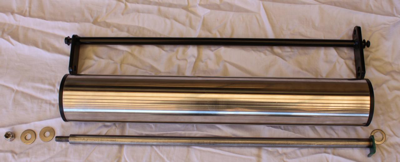

Hi Dee Jay heres a picture of it. I cant help but think that having a true front roller has got to effect the end quality of the cut.
Would love anyones thoughts on the attached. As the front roller I had was so sloppy.
Jason
Hi Jason, and thanks for the pic....it is an excellent looking piece of kit...I will send you a PM for some details...please check for a flashing envelope in the top toolbar next to 'My Stuff'. grin
You are quite correct in your assumptions re a sloppy front roller and the quality of cut...it just depends on the amount of wear present; if the end caps have been replaced and the shaft is not worn to excess, a little play is not so important....however, if all is badly worn and falling apart, the quality of cut will suffer as you say.
A new front roller shaft from the OutdoorKing Online Store is $84.07 and a replacement set of end caps $20.86...Total $104.93 plus freight.....I wonder how that will compare with the stainless steel version. wink

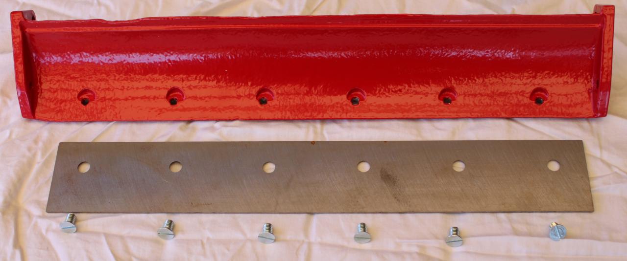

Sole Plate Sandblasted and powder coated in Flame Red as well new bed knife pre fitting and grinding to new cylinder
Jason

New Front Roller Assembly Model 45 - Stainless Steel Front Roller with Bearings. Roller Frame Sand Blasted and pwder coated in Satin Black. All New Axle, washers and nut
Jason

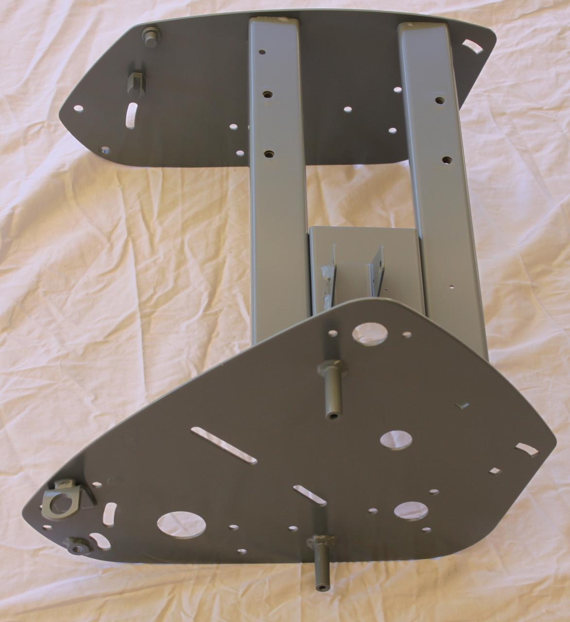

Sandblasted Model 45 Chassis and Primed in heavy duty Primer ready for spraying Hammer Finish Green
Jason

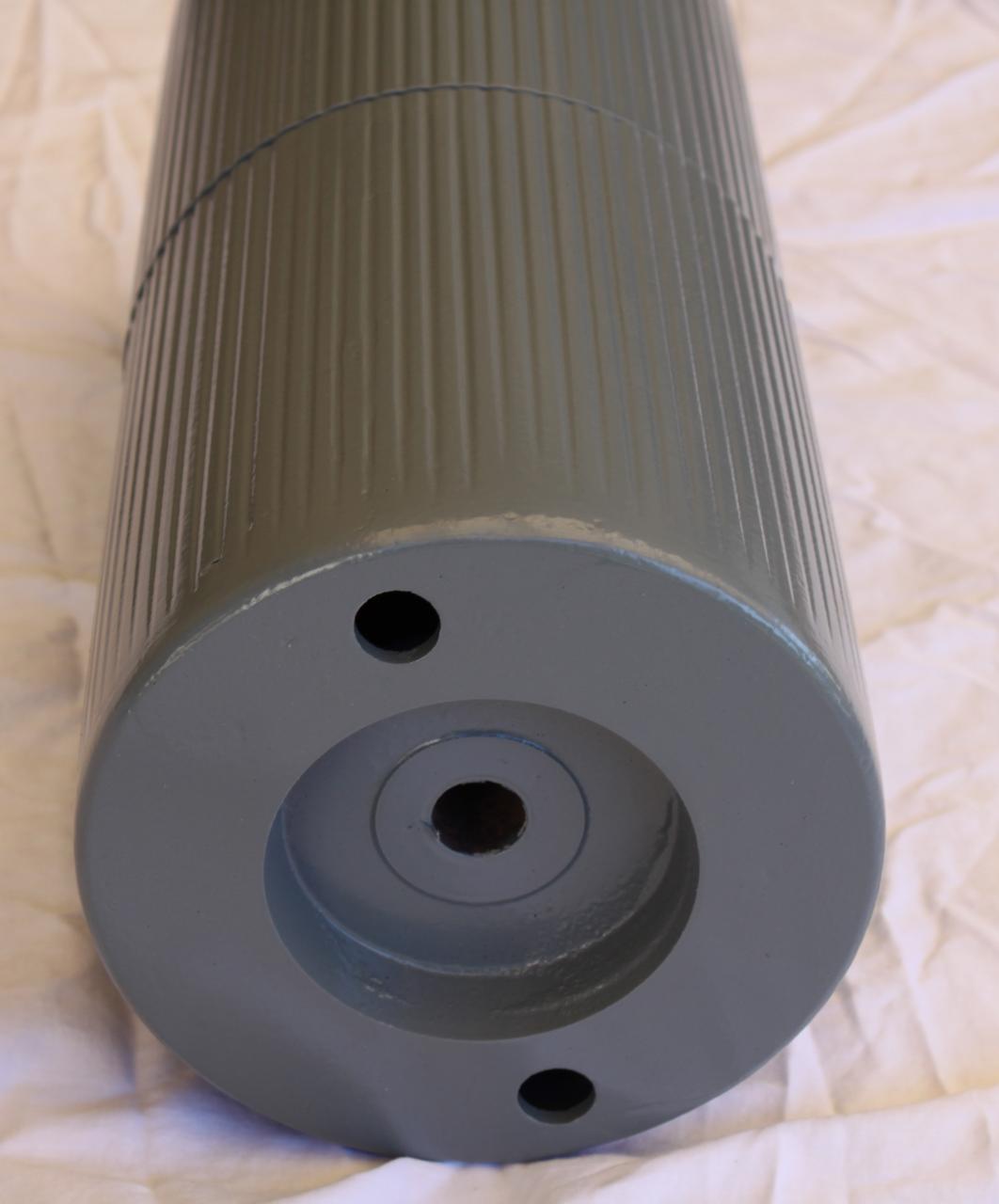

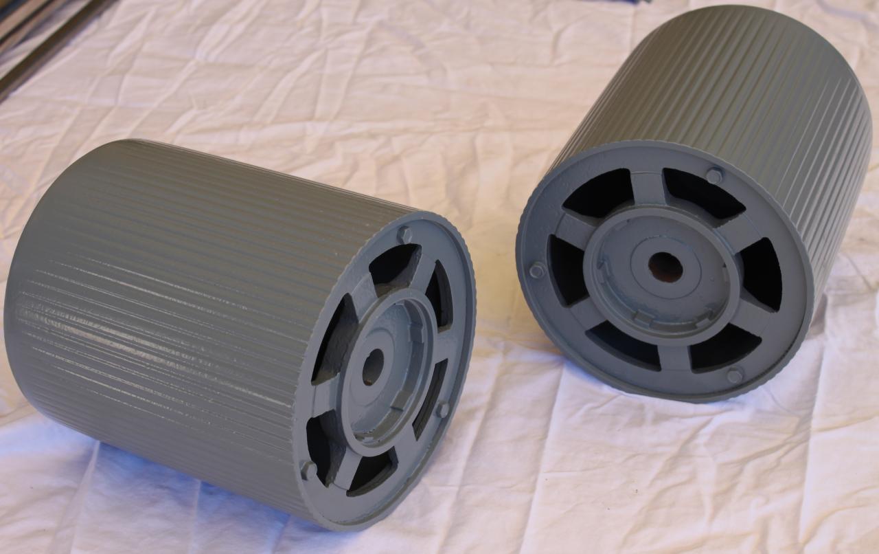

Rear Rollers Sandblasted and Primed in Heavy Duty Primer ready for sparaying Photo 1
Jason

Rear Rollers before Spraying Photo 2
Jason

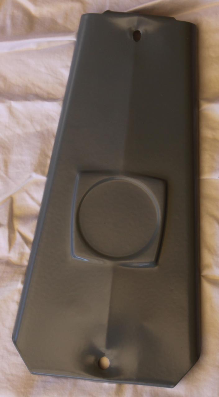

Handle Bar Face Plate Prior To Painting Hammer Finish Green
Jason
