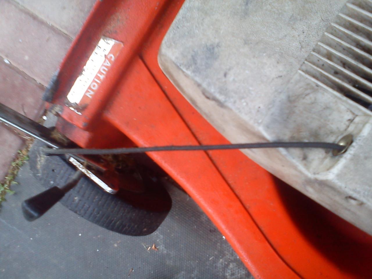

Thanks for all your input guys ,here are a few pics as requested and engine number ,also,when i hit the primer fuel just leaks out im sure im missing something but not sure what ta Jay

I had the same problem wit the G3 carby on my 1972 Super 24. The brass pin at the end of the throttle cable gets jammed with dirt. Spray some Q20 inside so that the pin can move in & out. The ignition then shorts to earth via the throttle cable.
jaykel1 #38378 18/07/12 08:34 PM
So here we have a G3 carby (not one of my strong points, anyway the pin can get dirty and stiff to move (little brass bit that the throttle cable connects to) that can be cleaned, I would suggest against trying to disassemble it though, the plastic would be getting close to 40 years old and probably getting a little brittle, some compressed air and some sort of lubricating spray may help though.
The pin when you push the throttle to the stop position gets pushed in a little bit to make contact with the brass part that the little black wire (pictured) connects to, if the pin gets stiff in its holder it may no longer make contact.
Alterntaely if that is not the issue the throttle cable may be out of adjustment, not allowing enough pressure be applied to the kill switch. cheers joe.

OK, So the two most common Issues I find that cause this are the kill mechanism, and the throttle cable.
Try cleaning out the throttle assembly, and that may help, as they fill up with muck, and can't connect properly.
However by this age, I usually find the throttle cable itself is not performing at peak, which means it can provide enough movement to give you most of the throttle range, however it just can't give enough pressure to connect the terminals.
I would suggest in this case, cleaning out the cut out very well, and making sure the contacts are clean, then when you want to stop it, apply pressure to the throttle control lever with one hand, while jiggling the throttle cable about 2" from the carby.
If that fails, stick your finger in, and push the kill switch, or the end of the cable (Hook).
As for replacing the cable, that's not always easy, they are no longer in production, so it's about finding stores with stock, or watching eBay.
I'm working on a restoration method for them, involving removing the inner cable, and replacing it with a similar wire, the hard part is replicating the twist at the end.

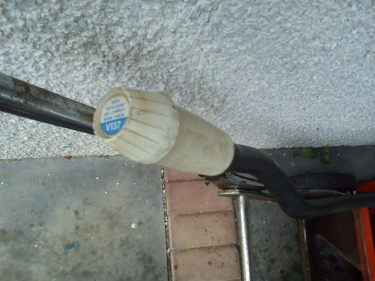

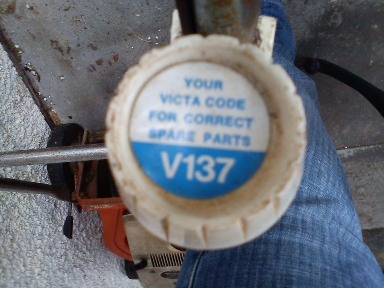

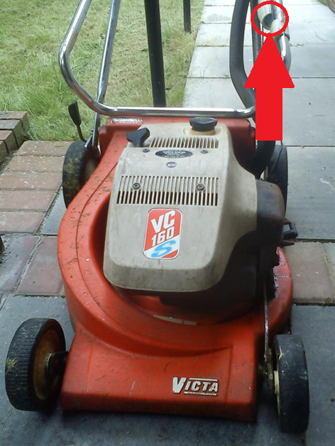

Jay, can you do me a huge favour, can you put up a photo of the "Parts Code" sticker on top of the cap for the air filter canister? It's a blue sticker with a number, and I would love to know that number.
I've never seen a VC-160 "S", nor have I ever read of one, so I'm curios as to if it was one of the export only models.

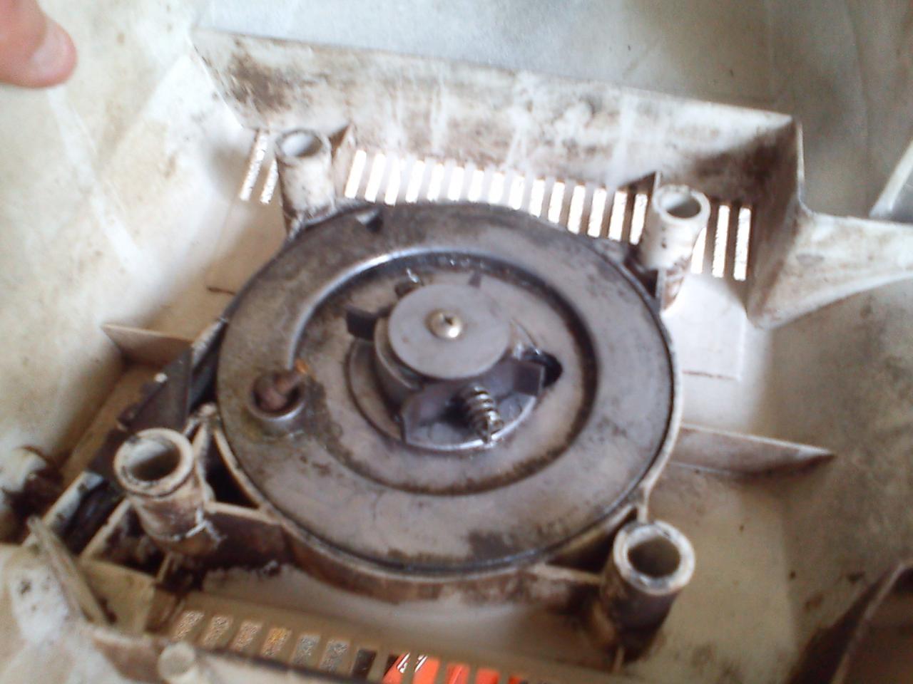

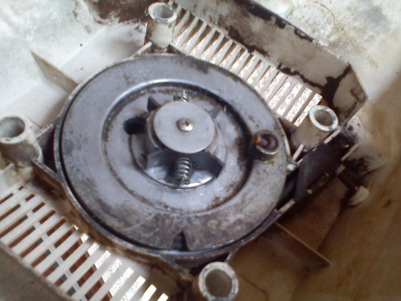

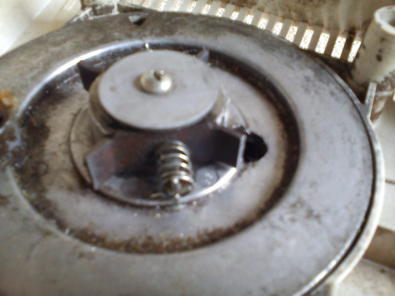

jaykel1 #38491 23/07/12 10:33 AM
If you put up a photo of the underside of the recoil, we can have a look at the condidtion of the pawls, they may just be dirty/oily, or they may need to be flipped or replaced.
The sticker I'm refering to is on top of the lid to the white cylinder on the handle bars, the one that connects to the carby with a black hose.
Inside this box is the air filter that prevents dirt getting in and destroying your engine.
The sticker is here:

Here are the pics you requested Mr davis
Thank you ..jay
jaykel1 #38570 26/07/12 09:16 PM
Wow that numbers sounds very familiar.
jaykel1 #38572 26/07/12 11:00 PM
OK, first, a rather curios point, I was expecting that V-code to be one of the ones listed as Export, but it's not, that is the V code for the first series of VC-Sports!
And on to point two, the pawls don't look too bad to me, but you could see if rotating them helps.
Remove the centre screw, and pull up and out the device with the 2 little springs on it, then rotate the 2 bent rectangular plates under those springs 180 degrees, then re-assemble.

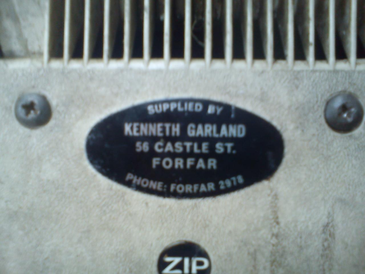

Iv been told by the previous owner,he bought it from an ex forfar (rural county in scotland ) council employee who purchased it from a local supplier ,shown below,im afraid thats where the breadcrumbs end.

Just thinking, that machine was sold and possibly serviced by Kenneth Garland in Forfar...he or another distributor may have imported it from a another dealer here in Oz, not from Victa themselves; that would explain the different code on the air-filter cap. Or, Victa might have simply run out of the export stickers and stuck on what they had....Which ever way, it was definitely imported into Scotland. wink
