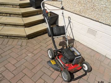

Just thinking, that machine was sold and possibly serviced by Kenneth Garland in Forfar...he or another distributor may have imported it from a another dealer here in Oz, not from Victa themselves; that would explain the different code on the air-filter cap. Or, Victa might have simply run out of the export stickers and stuck on what they had....Which ever way, it was definitely imported into Scotland. wink

I think it's likeley that this model is exactly how victa intended, IE, the stickers and location are correct.
The export only models may well relate to machines that were very spe3cific to their export markets, and required different parts codes, however this mower is practically identical to a VC-Sports, aside from a couple of slight variations that I have found relate to the export version of the sports.
I Imagine that for the export version of the sports, they felt no need to re-catagorise the mower, they simply added the export requirmentrs (One of which I have found, is that interesting spark plug boot, it contains a supressor) and gave it a different sticker.

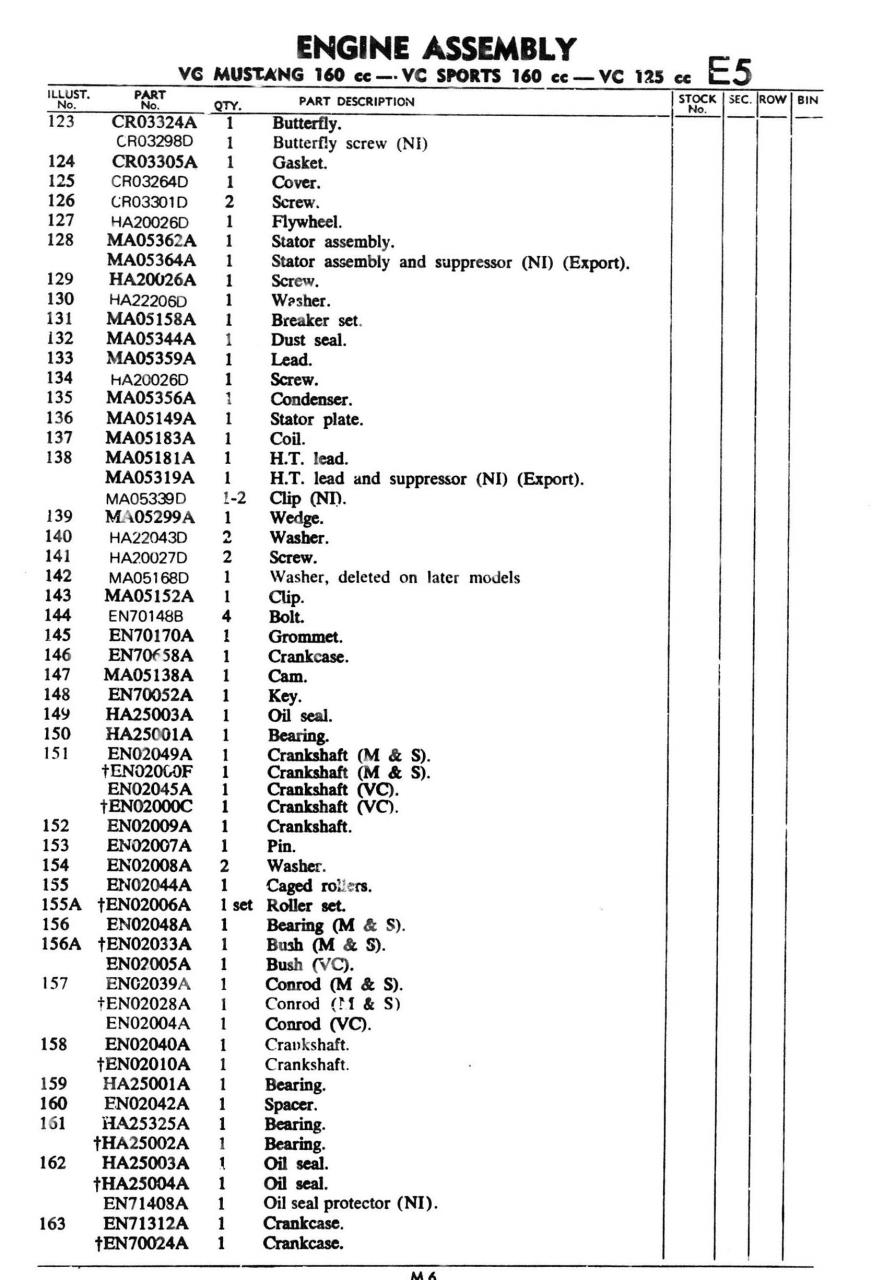

Here is one of the pages of the parts list for the 1973 VC-sports, this is the only part of the list where I could find reference to exort modifications on this model, and one of them, the HT lead with supressor, seems to fit the pictures above, where the boot seems much larger than we would normally see on this machine.
So my theory is that we are looking not at an export model Victa, but at an export version of the VC-sports, which has simply been re-branded for export, possibly to help promote the engine size in the name, where the mower would not have been as well known as it is here.
