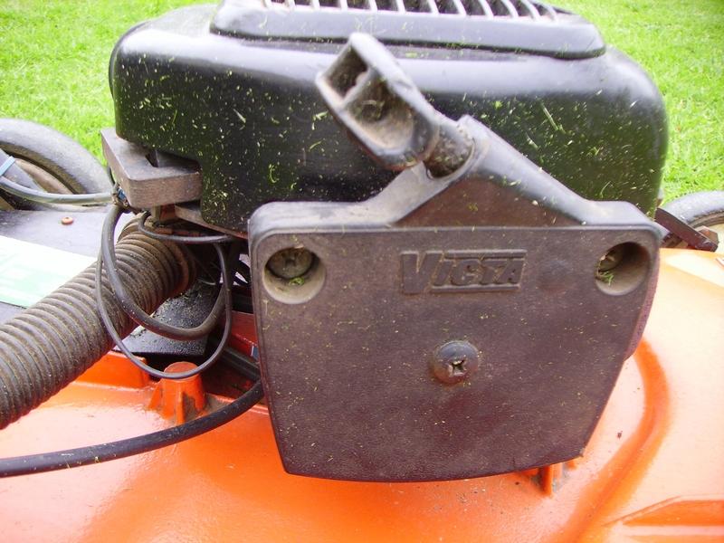

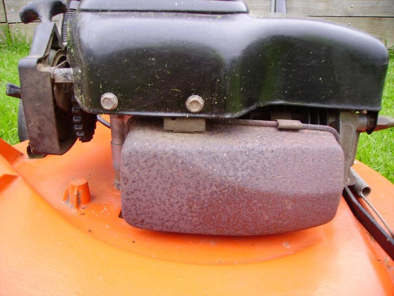

A friend of mine has an early victa 550, wants to get more power (he's a contractor, recently aquired it). I have the same base/engine and have assumed that all that can be done is to rebuild the engine (is this the 125 or 160cc?) there are mouldings in the frame that suggest perhaps a different engine could (??) fit?

the last 2 images show the stub mouldings

I'm the owner of this prime piece and I appreciate your input in regards to improving the performance of the engine.
One thing however remains a mystery...can anyone advise as to what the two raised castings are for (Shown in picture 2 & 3) they are drilled out from under the deck and have only a mm or two left to break through the top...I assume they are additional engine mountings, if so what engine are they for or do they have some other use?

I hope someone will be able to help you out there, I have the same model and to be honest, I wouldn't have a clue really what they are for!
I would hazard a guess that they may have had something in mind for a later model, or that model, which didn't make it off the drawing board...Maybe one of the Victa GURU's on here can provide some insight..

I cant say ive noticed those cast lugs on mine.
It is possible that they are mounting lugs for a 4 stroke or even possibly a power torque motor.
Easiest way to tell is to pull a power torque off a mower, grab the metal plate that goes under the motor and lay it on the lugs to see if it lines up.
Youd have to pull the full crank off of course.
Are there 3 or 4 lugs.
The 4 strokes mount on 3 in a circle.
The power torque mounts on the same 3 but has a 4th one off set under the carb, so the same spot as the carb thats on it, is there a lug there???
You could make the SP work with a 4 stroke. Just a matter of buying a pulley the right OD, then getting the ID machined to fit the shaft and working out how you are going to make it stay on the shaft.
Youd need a 4 stroke victa crank boss, then workout the height from the one on the full crank and work out what goes where.
For unlevel or hilly terrain its hard to beat the full crank.
