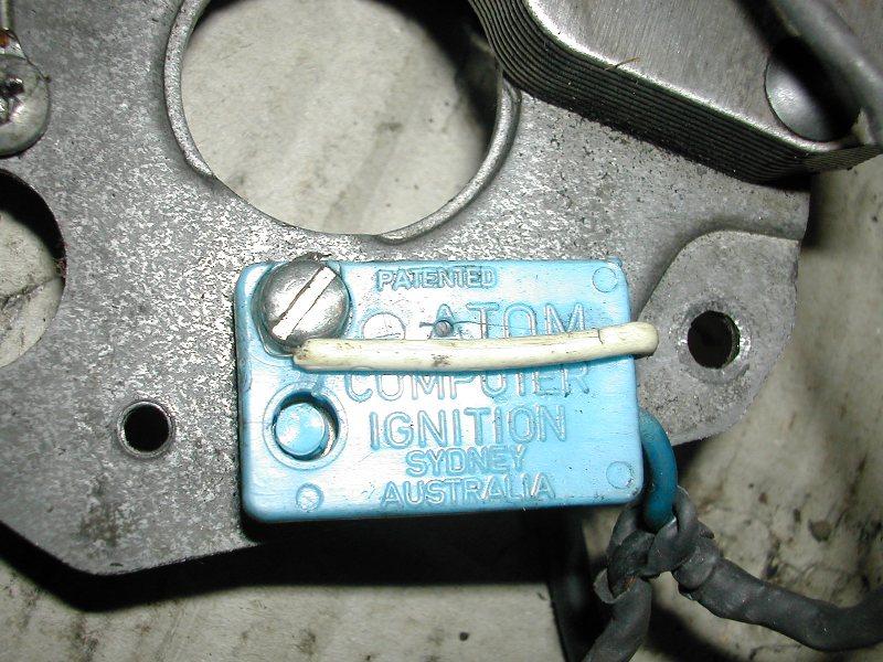

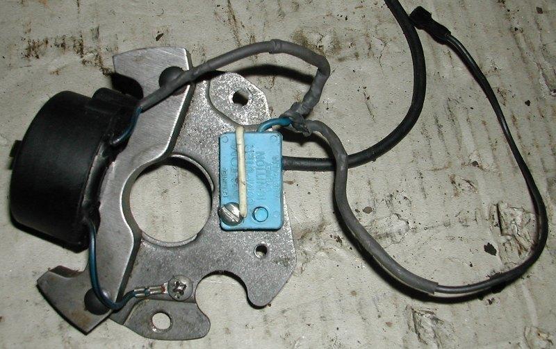

I am fitting an electronic ignition to my VC160 and it won't kick over now.
I have posted 2 pics to see if someone can see what i've done wrong.
Advice would be appreciated. The 3rd wire goes out to a kill switch as this motor is used on my VictaProject GoKart http://www.victaproject.blogspot.com.au/
I have used the old point bracket to mount things but perhaps the module etc needs to be outside the housing/flywheel ?
thanks in advance...

I got a Blue Atom and it is now working. It is wired up the same as yours but my module is outside the flywheel which is what they suggest. They also say blue to earth but mine only worked (correct timing) with white to earth. It still sparked but was ATDC instead of B4TDC.
