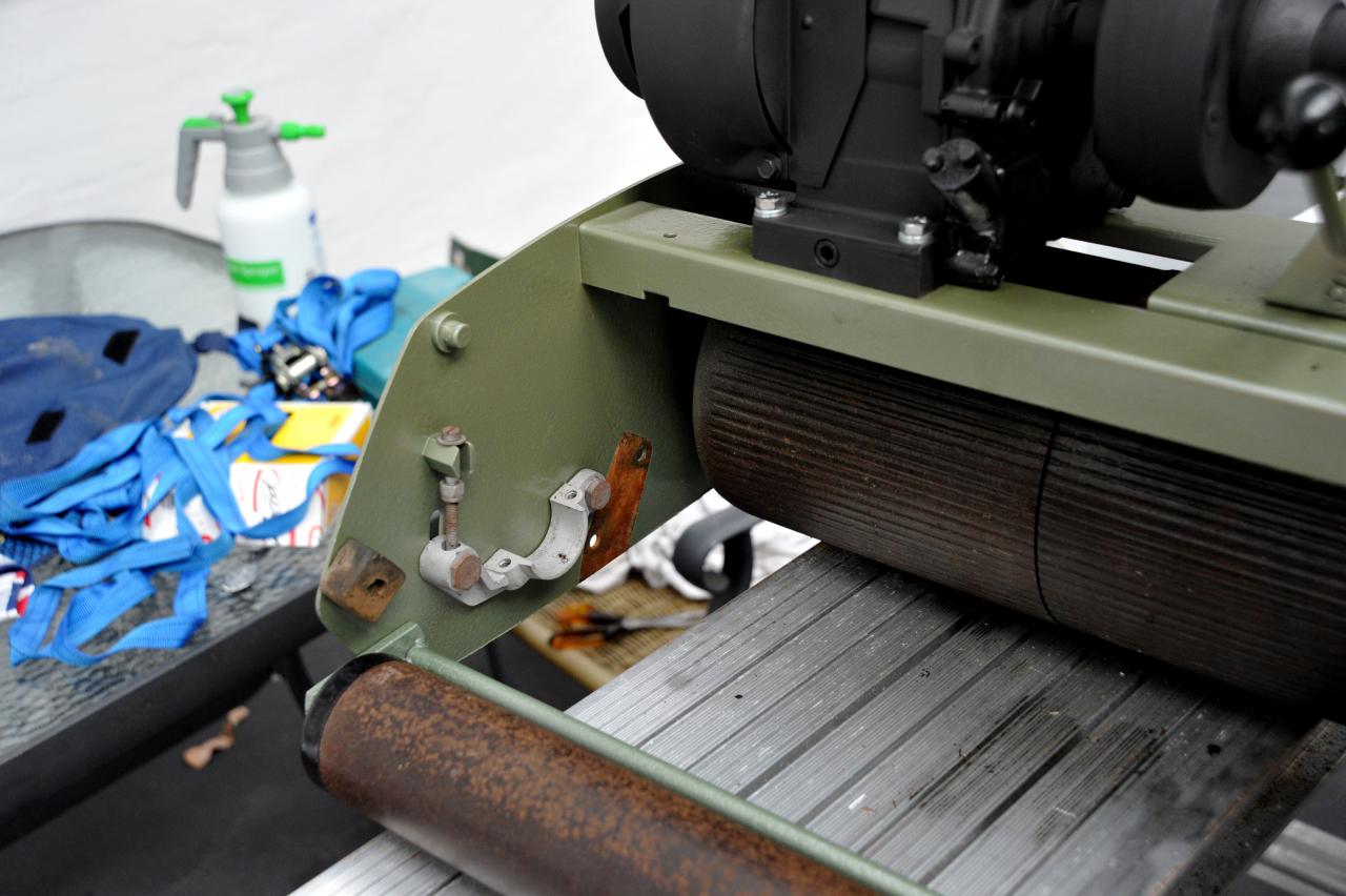

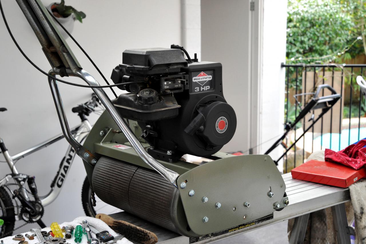

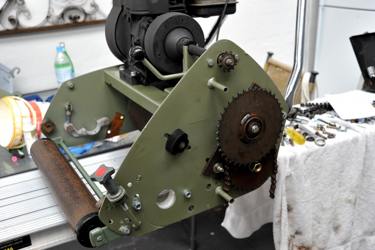

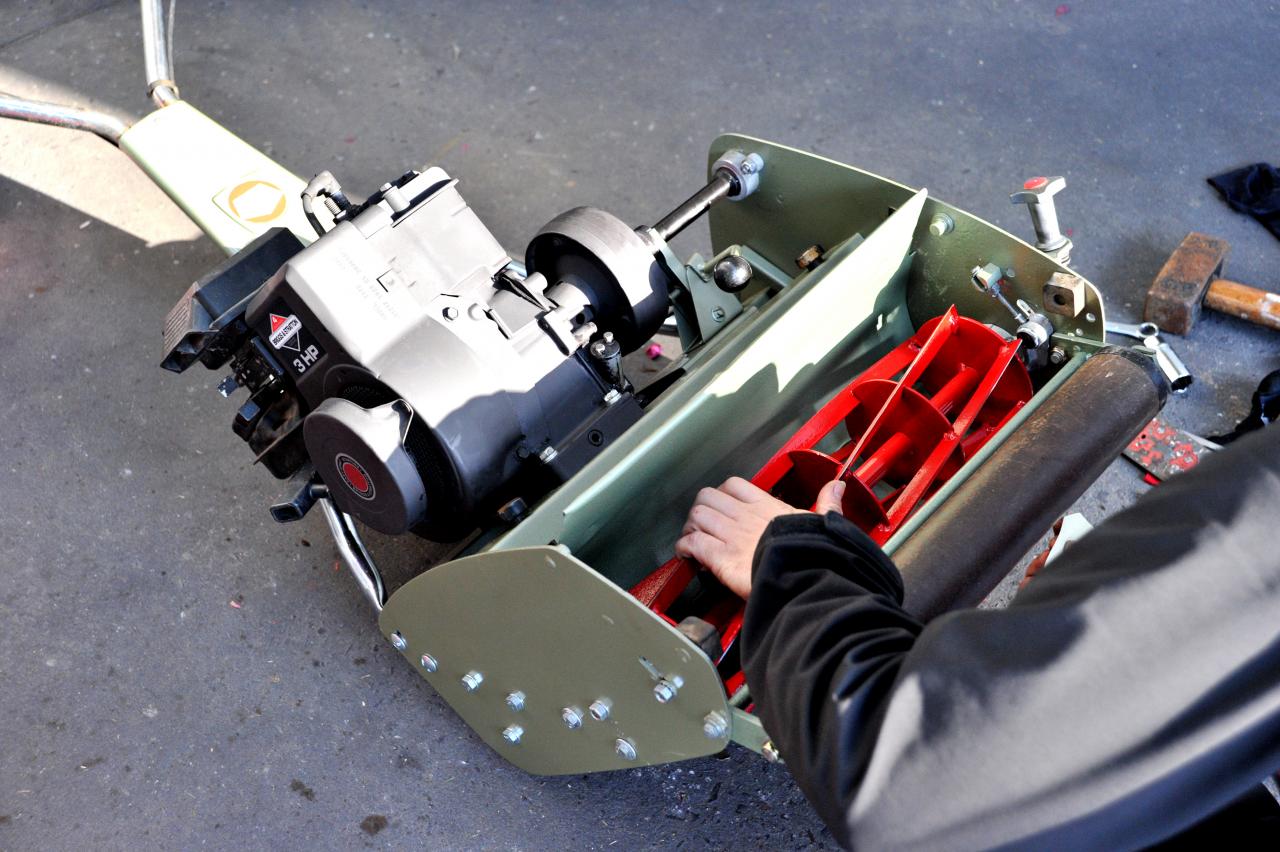

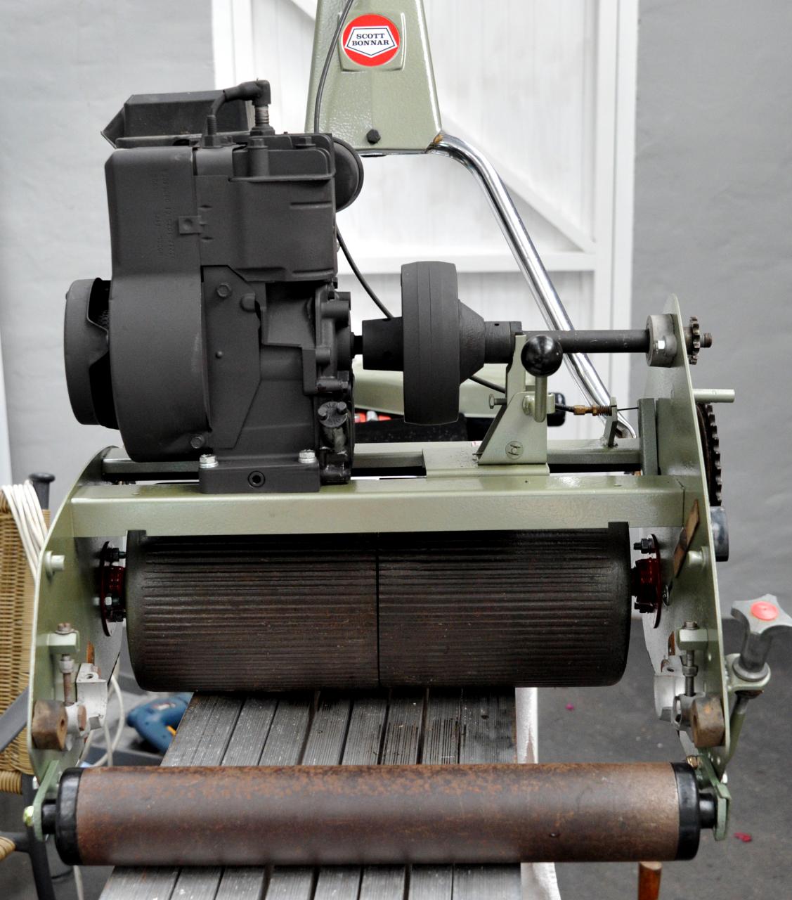

Here are some updated photographs.
The reel and bedknife went off to be sharpened last week and it will be coming back to tomorrow. I will havesome assistance in putting it completely back together and setting the cutting surfaces correctly.
I have it mostly back together except for a few items that need to be replaced or added and those are coming tomorrow.
Here are some pictures of it today.

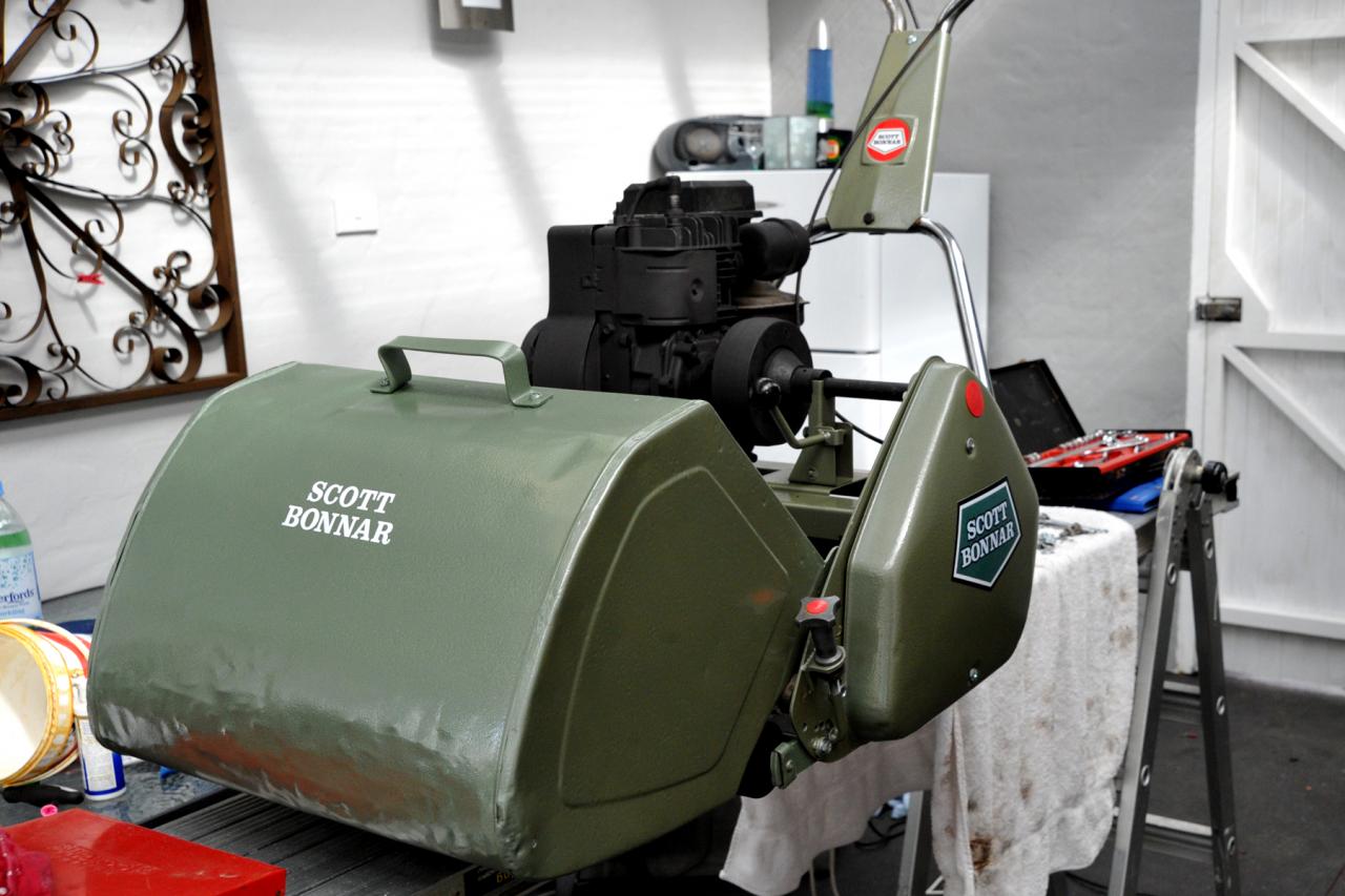

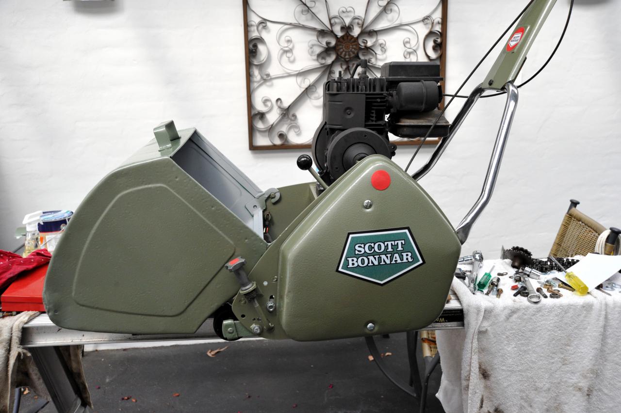

Hi Wilsoac, coming together nicely, are you going to put some silver paint on the front roller tube? It would really set it off nicely...and just a heads up....the Scotty sticker on the chain-case and catcher are the wrong way round....the shield design goes on the catcher....here's a pic [Linked Image]
Here is our guide to re-installation of the reel and adjustment procedures.....Click HERE
Looking forward to seeing it completed, mate. grin

Thanks Darryl,
I had looked at the pictures you posted before and I thought I didn't like them that way so I decided to put them the other way. Now that I've done it I kind of wish that I had put them on as your image shows above. Oh well! I cant really pull them off now as the text sticker is individual letters and I would wreck it in the process of removing it. I guess I could buy another set as they were inexpensive but I'm not sure I could be bothered. They will probably be damaged by tomorrow lunch time anyway!!

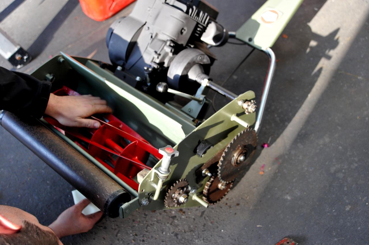

I will attach some photos of the mower after we put the blade back in and had just finished back lapping/adjusting the blades. You can see the test cut with a post-it-note, the thing is razor sharp even after one cut of the lawn.
I'm looking forward to cutting the lawn with it tomorrow.!! [Linked Image]

2. Back lapping was done using a 3/4 socket attachment/adaptor on a battery drill running the blades backwards against the bed knife, a medium paste was used. As far as why I back lapped it; I had a fellow here to help me (he sharpened the blades) who is a senior contractor for many golf courses around Sydney, including the exclusive NSW golf course, he was the one who recommended this course of action to me.
He explained it was required as the two blade surfaces can never really be ground to each other absolutely perfectly while they are not bolted into the machine. Due to this the blades were lightly back lapped to ensure the perfect alignment of each blade to each other. You could hear the little burrs being removed by the process and when it was done you could hear that the blades were perfectly honed and aligned to each other, the sound was sensational as the two blades came in together, it sounded damned sharp!!
3. Yes, VERY slight contact. The blades are far enough apart to allow the cutting of a post it note, no less, no more.
