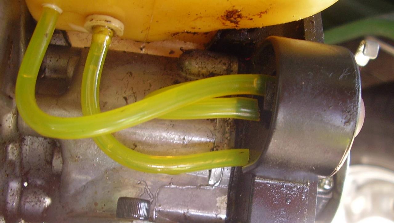

I have a ryobi trimmer model RST131ES which had buggered fuel lines,i though iknew where the lines went but alas im wrong ,when i prime the primmer bulb goes hard , i though that it was meant to pump fuel into barrel,so what happen is that i burst the primer bubble and find service guys are hard to find ,i will have to get a new primmer assy from bunnings ,they seem to be the agents for roybi,have attach 2 photos of fuel lines where i have them ,must be wrong,come on guys help me please. [Linked Image]

Perhaps the lines on the primer are the wrong away around, if memory serves me right they have a one way valve built into them. Primers are available here on the online store as well.

Just try the primer on its own, with one hose at a time dipped into a cup of fuel. You'll easily find out which one sucks and which one blows.
