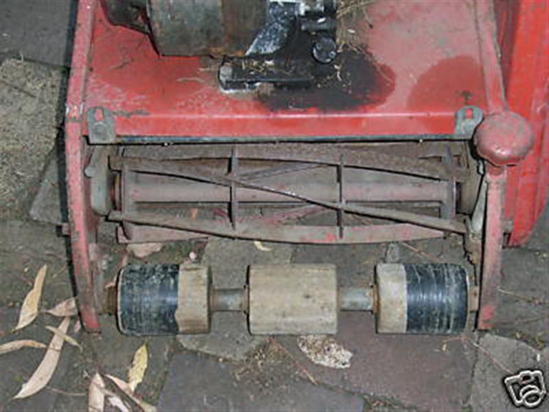

If it is belt drive it is not a Model 45, or 33. If there is no chain at all, just a belt, it is probably a 430 or 590. We have a number of threads here about both - you might find them informative.
It would be helpful if you post a picture, which will show whether it is a 430 or a 590. Most parts are difficult to get for both, but the most crucial ones should be available.
Hi Chris and grumpy....we need photos here guys to identify the machine.
Its definitely not a Model 430 or 590; as they were only ever built in 17" cutting width with a 3HP and 2.5HP B&S engines respectively. The Diplomat series was not introduced until late 1976.
Chris, pics please, from different angles and specifically of the chain case, and belt set-up grin

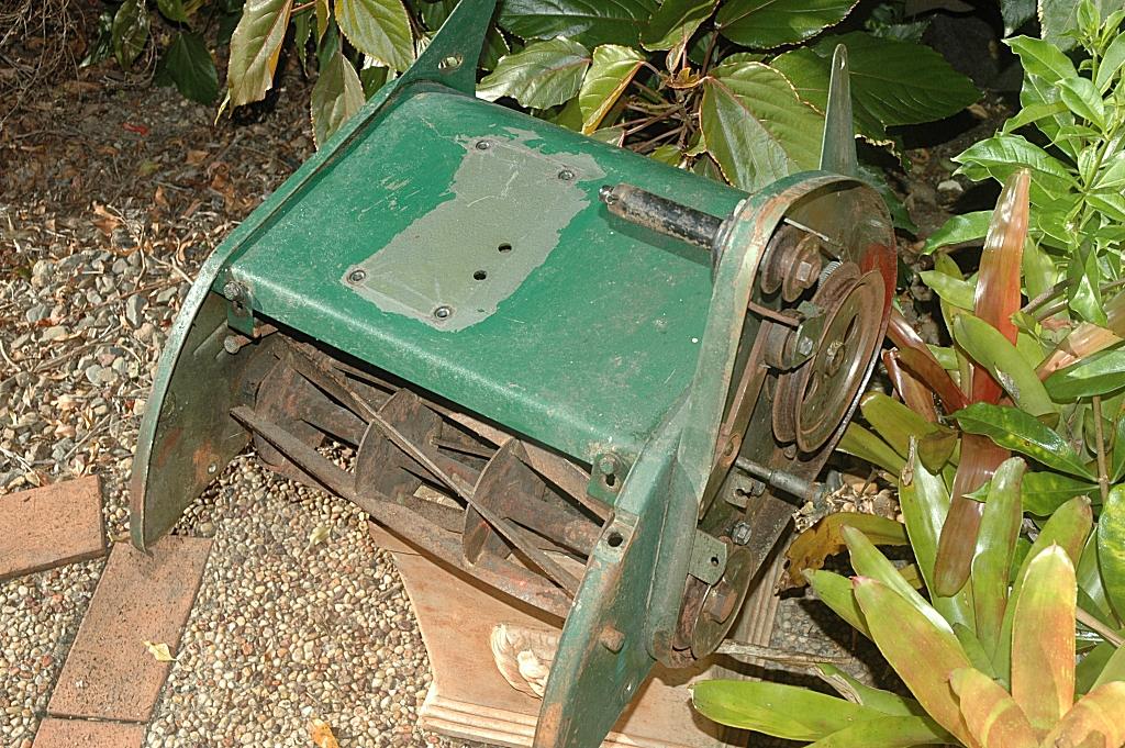

I've had the mower for a couple of weeks and have dismantled it, taking lots of photos along the way, though unfortunately, not one of the complete machine frown
I've rebuilt many B&S engines over the years and have stripped this one - it is in quite good condition and will rebuild without any problems.
However, my experience with SB mowers is limited to watching my Uncle mow when I was a kid, so I'll need your kind guidance and assistance.

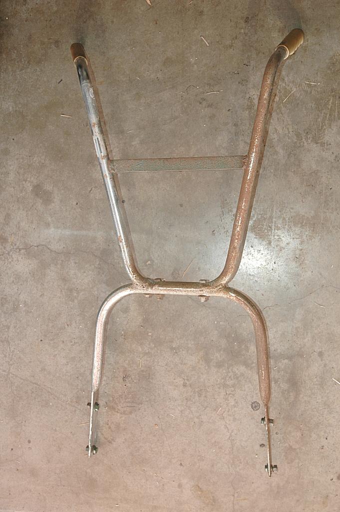

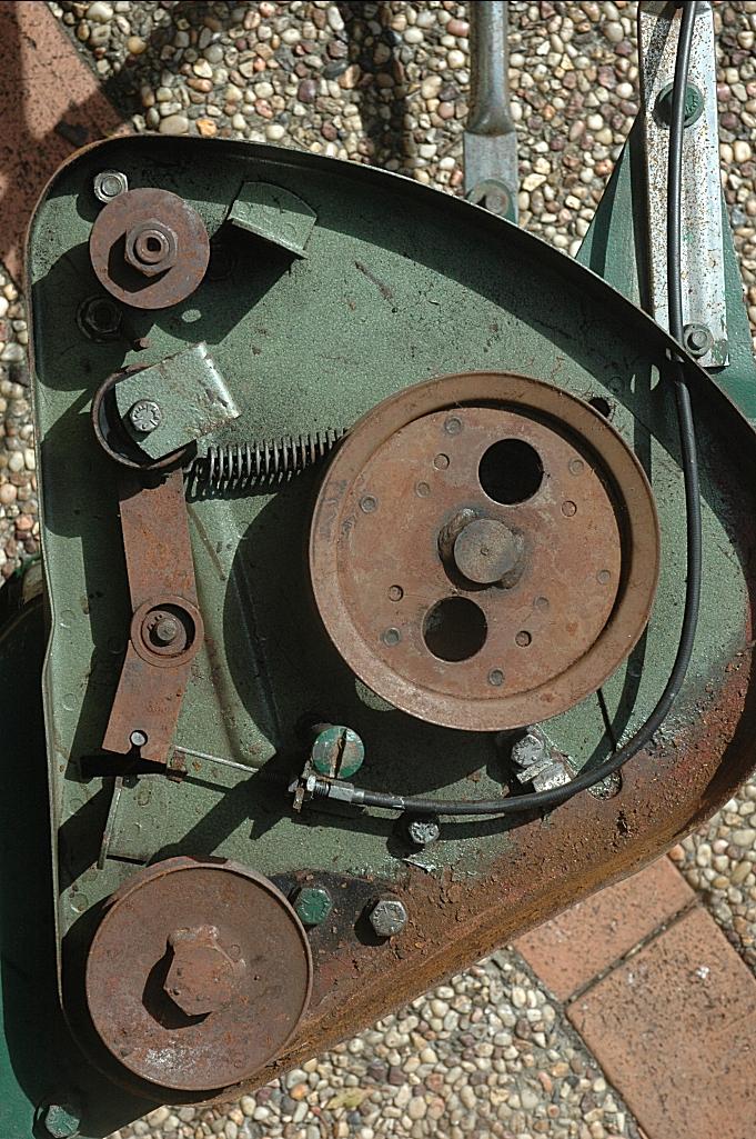

I've attached various photos of the bits of the mower that may assist in identification.

I haven't seen one like that before, and as Deejay said, it obviously isn't a 430 or 590. Deejay is the SB guru, I'll be interested to see what he makes of it.
Hi guys, I was almost tempted to say in my first reply this morning, that I suspected that Chris's machine was not in fact a Scott Bonnar....what sparked this idea is that as far as I know, Scott Bonnar did not manufacture a cylinder mower in Adelaide that had a 2HP Briggs factory fitted.
Also the belt issue had me tossed; though the Model 33 had both belt (primary) and secondary chain drive.
The machine is actually a Morrison, made in Hastings New Zealand and badge engineered as a Scott Bonnar.
This machine is also badge engineered itself; it started its life as a Victa Imperial! grin
[More is known now about this machine. It started life as a Ransomes!]
Here are some pics;

Hi Chris, yes mate, I think it is worth restoring.
To remove the cutter pulley, place a piece of wood through the reel helix to stop the reel from rotating, place the correct socket on the nu welded to the pulley, and it should unscrew by applying gentle force in a clockwise direction. (This is a left hand thread....ie in the opposite direction of the normal rotation of the reel)
You do not wish to damage the reel by applying too much force on the piece of wood....

I figured it to be LH thread as the rotary motion will tend to tighten it under load but it was nice to have it confirmed prior to attacking it.
Now to find someone to sharpen the assembly. I've discovered that the cutting reel, blade and bearings are a single unit made my Ransome. The bearings feel OK, so I may either leave them or gently try to open the housing and repack them.

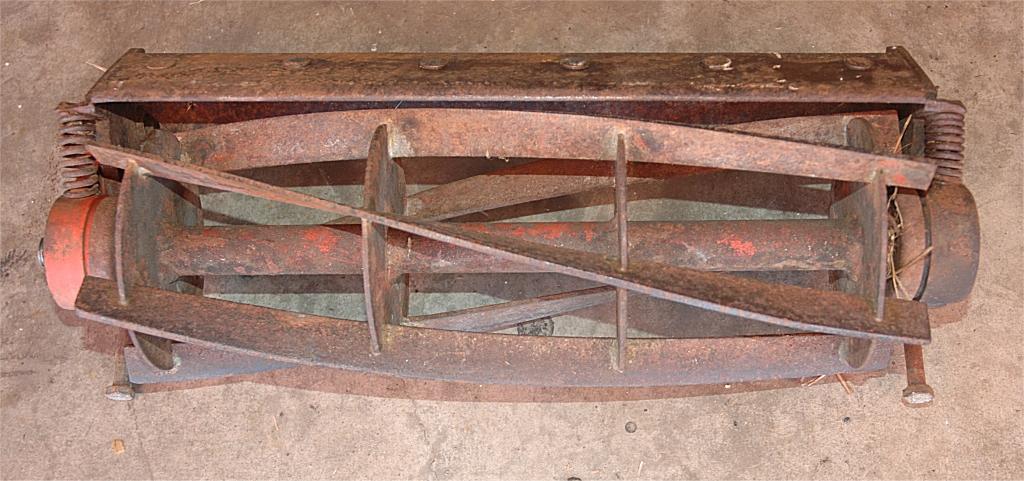

I've uploaded a few photos of the reel/blade assembly.
Cutting adjustment is via a pair of long screws that alter the distance between the reel ends and the fixed blade. If the reel isn't bent, the adjustment should be uniform along the length of the blade.
As to disassembly, the unit seems 'sealed for life'. The blade is permanently riveted to the base of the reel and the reel hubs are similarly riveted to the frame - I've tried to show this in the last two photos.
The bearings are sealed and seem OK.
There is plenty of depth left on the blade with a lot of adjustment still available. If I can get it sharpened, it'll be serviceable for years to come.

Hi Chris, I have done some research on the Ransome cutter unit, and it still appears to be in production on the Masport/Morrison Olympic models 400-500-660. It is not a sealed unit....the rivets on the knife-blade can be removed and are listed as a spare part....the bearings can be replaced also.
Here is an exploded diagram of the unit disassembled....

Hi again Chris....what I was getting at is that both the cylinder reel and the bottom blade can be removed from the assembly for sharpening by the engineer....
Also, don't forget to remove, clean and inspect the reel bearings and re-pack or replace as necessary....these are critical to to the reel to bedknife clearance adjustments after re-installation on your machine. wink
