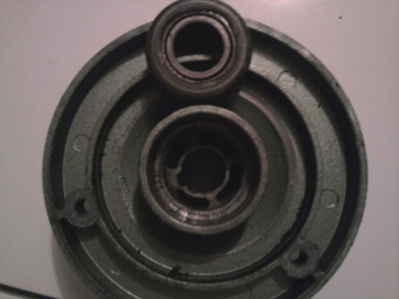

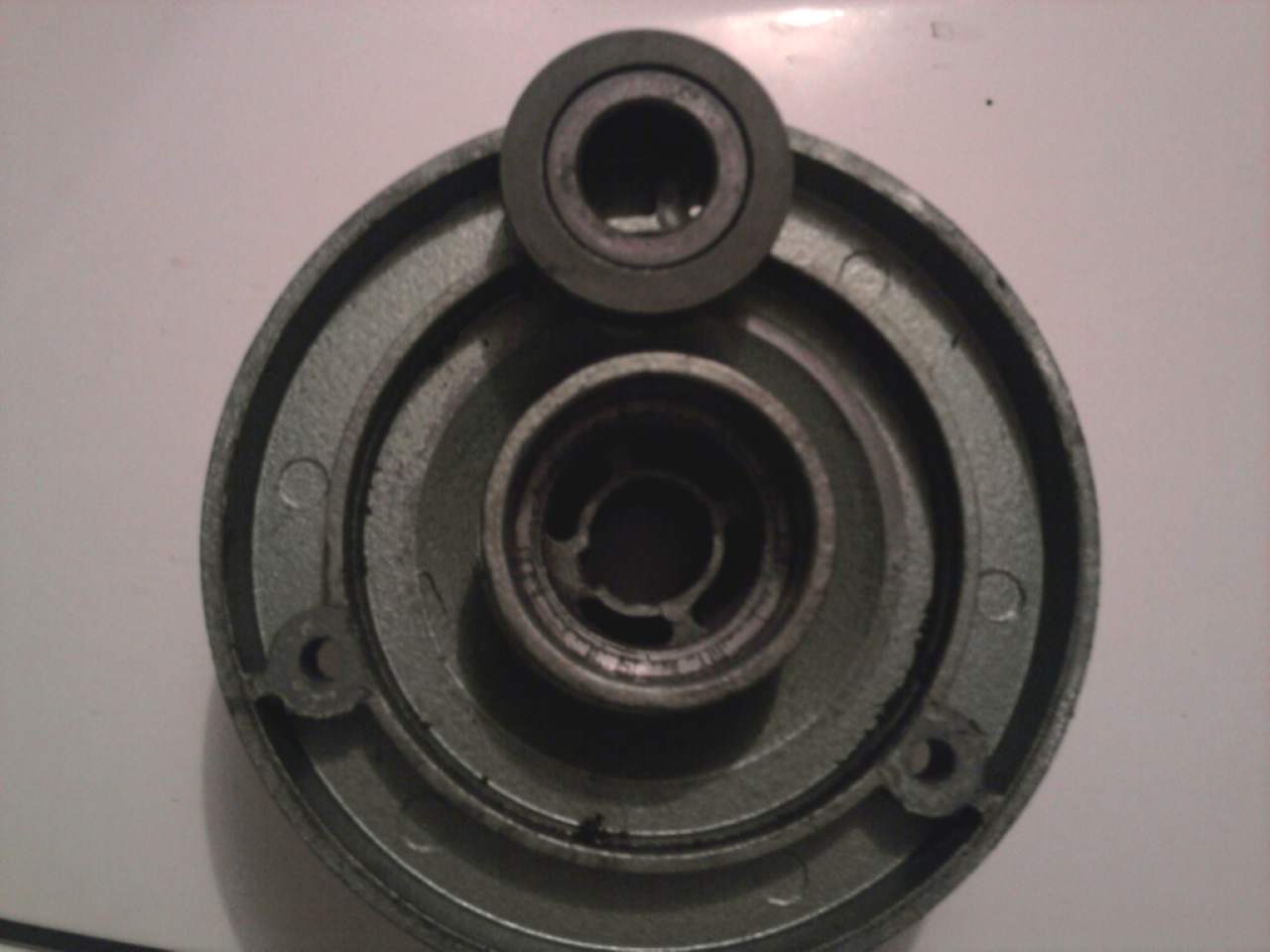

Gents see the 2 pics. I may have originally installed the clutch bearing around the wrong way ? Which way does it go into the housing. Should the "flat" side of the bearing be facing up or should the curved side be facing up.
Cheers Ross

Hi Ross. sorry mate I can't remember which way it goes....I think it has the flat side towards the clutch cone.....You may consider giving Keith a ring at TMS on 0438 357 100, I am sure he would know. wink
This is the primary clutch thrust bearing.
The rounded edge facilitates insertion.
It faces downward on installation.
