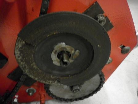

The clutch was starting to show some signs of slippage. And I know from the original tear down the cork was in not good condition. So for the sake of $9 for a new cluch I figured I would have a go at replacing the clutch.[Linked Image]
Joined: Mar 2011
Posts: 80
Looks good. I noticed mine is starting to slow down on up hill climbs.
Hi Jarrad, congrats on getting your machine all ship-shape....It looks good in red, and of course, you could always change back to Scotty green at any time down the track. Thanks for putting up the pics of the roller clutch internals...good for the archives mate. grin

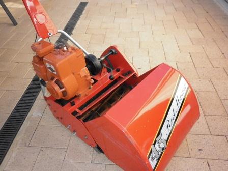

Things change quickly in 5 minutes. Have just won this SB / Rover 45 on Ebay, so hopefully I can pick it up this week.
Will then work out if it's best to swap the good bits off this one onto my Red SB or sell of the Red SB as is and do another restoration on this new one.
The red one presents well, has been sharpened and serviced, so dont think it will be too hard to sell.

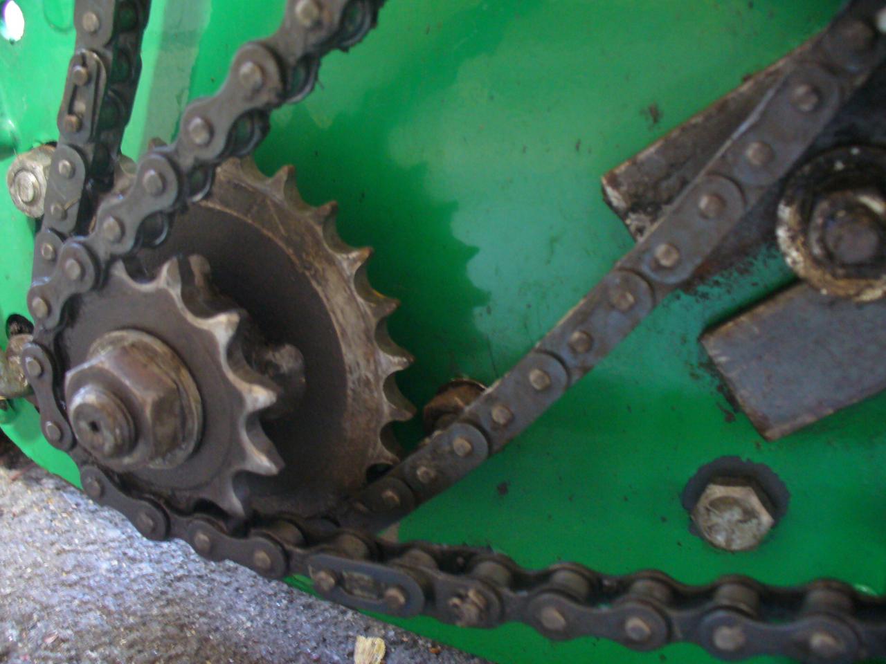

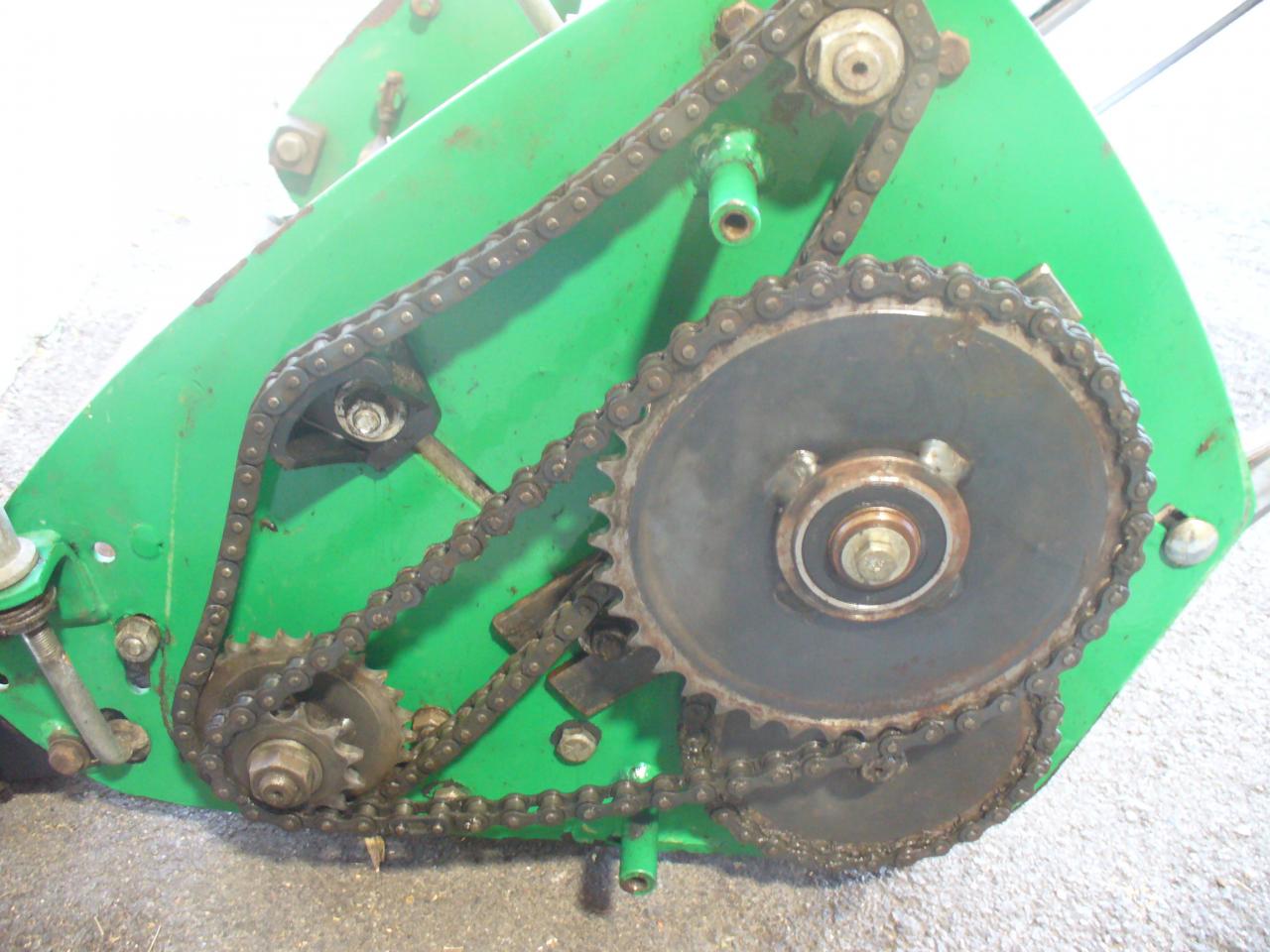

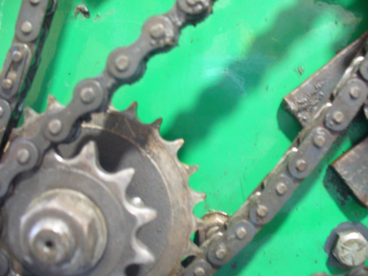

Hope this helps, to me the sprockets and chain look OK. I think the chain would benefit from removing 1 link.
Need to get new seal or complete fuel cap as this leaks. Dont know why Briggs went away from the old fashioned screw type cap.
Will get new clutch cork and chain tensioner on way home. Goin to keep this one and keep all original. So will start strip down this weekend.
The two small sprockets are fairly badly worn, Jarrad, and the damage to them is characteristic of being run with an out of pitch chain. I suggest you do the wear check on both of those chains. If they are as bad as I expect, what you should do depends on how bad the other sprockets are. The large one wears more slowly due to spreading the damage over more teeth, so it might be savable now if you fit a new front chain right away. The problem is that the worn out small sprockets will damage the new chain fairly quickly.
If you post a good, square-on picture of the large sprocket we can talk about whether it is worn out too. It is only if it is already ruined, that it makes sense to drive the whole setup into the ground by continuing to run it.

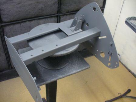

Bit of a progress shot
Chassis and Chain cover have been paint stripped, sand blasted and coated in grey etch ready for a coat of bright green.
Havnt taken a pix of engine, but it's been rubbed back and had a coat of black engine enamel.
