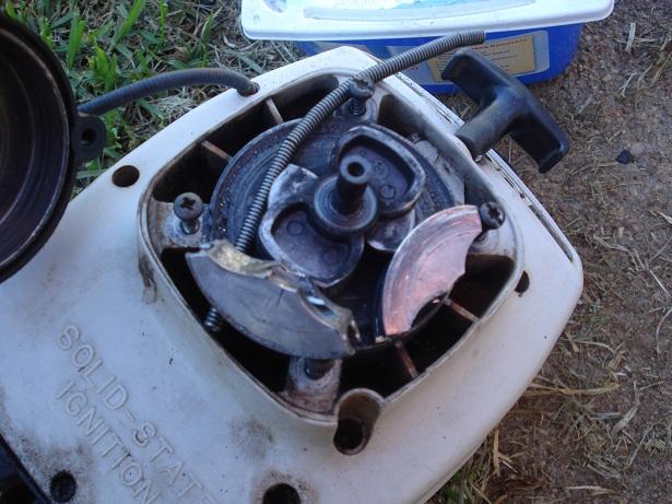

A problem with the clutch is more likely to be a broken spring than anything else, and if you shut it down instantly and replaced the spring, there might not be any other damage, and it is a simple ten minute job with just ordinary hand tools. If you've run it like that for a while, chances are the plastic housing around the clutch is a goner.
This thread shows what may have happened (the Atom edger uses an ordinary Ryobi powerhead)
https://www.outdoorking-forum.com.au/forum/u...rds=stitch+in+time&Search=true#Post32432

Check the picture of what may have happened, in this thread:
If the plastic housing has now been eaten like that, I think your trimmer is probably a goner. You need a whole new upper housing.

Here is what you might expect to find, this one has a problem with driving non stop with no disengagement.
Interesting must be a common issue, as I pulled 3 ryobi machines apart today and 2 of them had broken springs...
If it eats that major housing each time a spring breaks, and the springs are defective, there are going to be a lot of Ryobi whipper snippers on junk heaps before long. The broken spring is trivial, what matters is the collateral damage when it happens. The way the design worked in that Atom edger was just crazy, the machine was a guaranteed write off if the leading end of a spring broke (no real damage if it broke at the trailing end).
