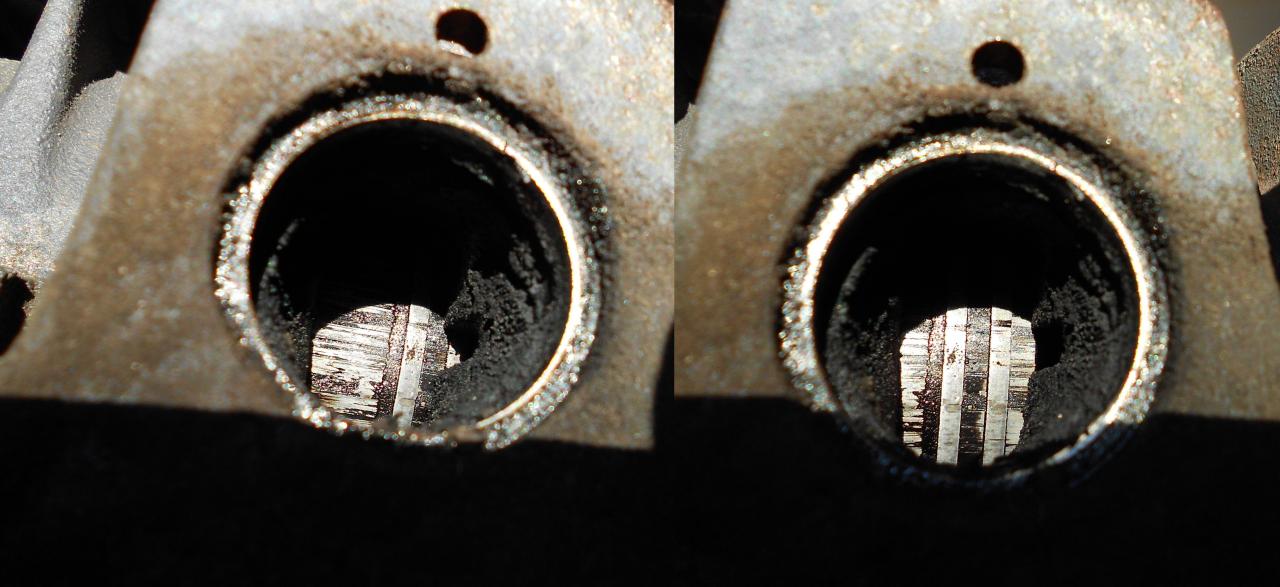

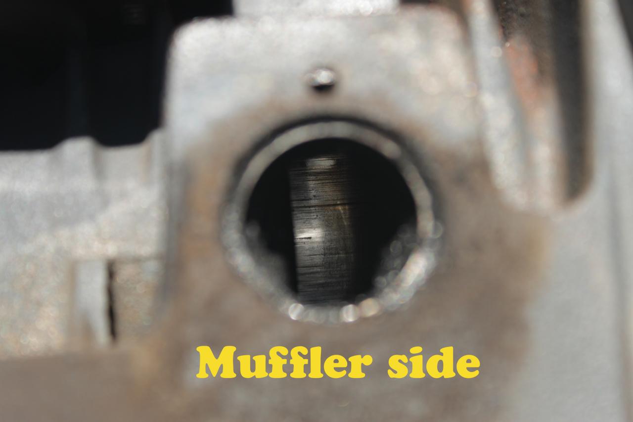

Pull the muffler off and look at the piston.
With a small screwdriver or similar you can poke the rings, then you can gauge their condition. If they wont move thats no good. If they spring but can be pushed a long way into the piston groove they are worn out.
Being a chinese made engine, anything is possible.

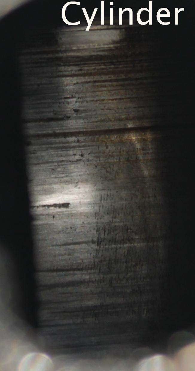

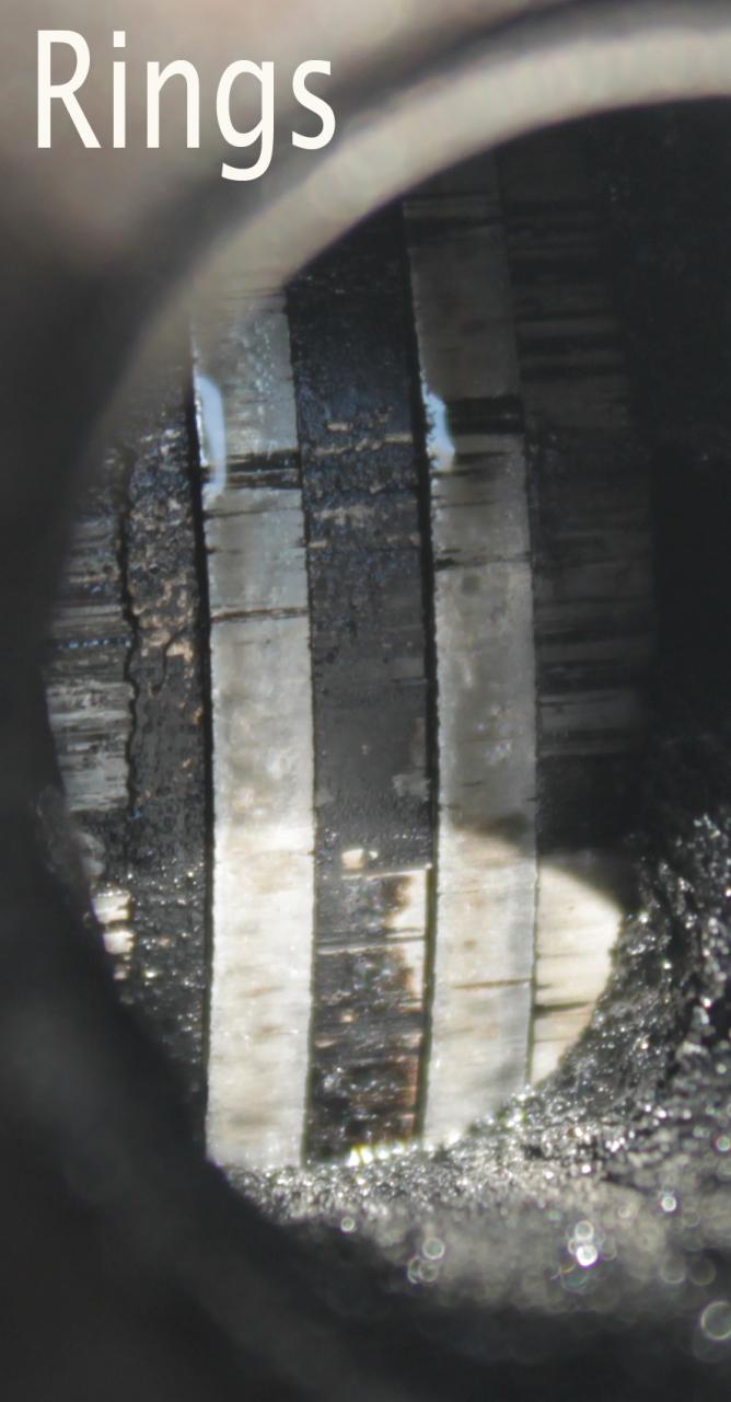

umm well I am no engine mechanic but this dont look good ..and your "not good" I think fits the bill
(no movement I could detect)
What little I know rings are suppose to be slightly above the cylinder
and yesss look at all that lovley carbonized Crud..
Well that was my darkest suspicion but I'll wait for your opinions...still I think this has entered "Project status"...

Well I am a dummy I was kinda looking at this the wrong way Joe
closer look at the photos cleared that up but I'll have to recheck
really
I suppose a compression test...
still I think they arn't healthy..humm anyway Thanks

probably really pointless if it is the rings but rechecking I thing they move a little and spring a bit
still I have my doubts on them
Really more so for reference
but heres a couple of pictures one of the rings and the other of the back of the Cylinder
you might get better sense of depth on them
(that yellowing is torch light I think)
I think rings are the go but I just need to confirm it and if they are..well learning curve
now a question
I could probably manage rings but honing a bore well not tooled and wouldn't trust me
so I hate to do half baked jobs but what the chances of getting away with rings
if the bore is in not too bad shape I say it has some wear and tear just hopefully not too much
Anyway if its rings its a project for me as I said...over time

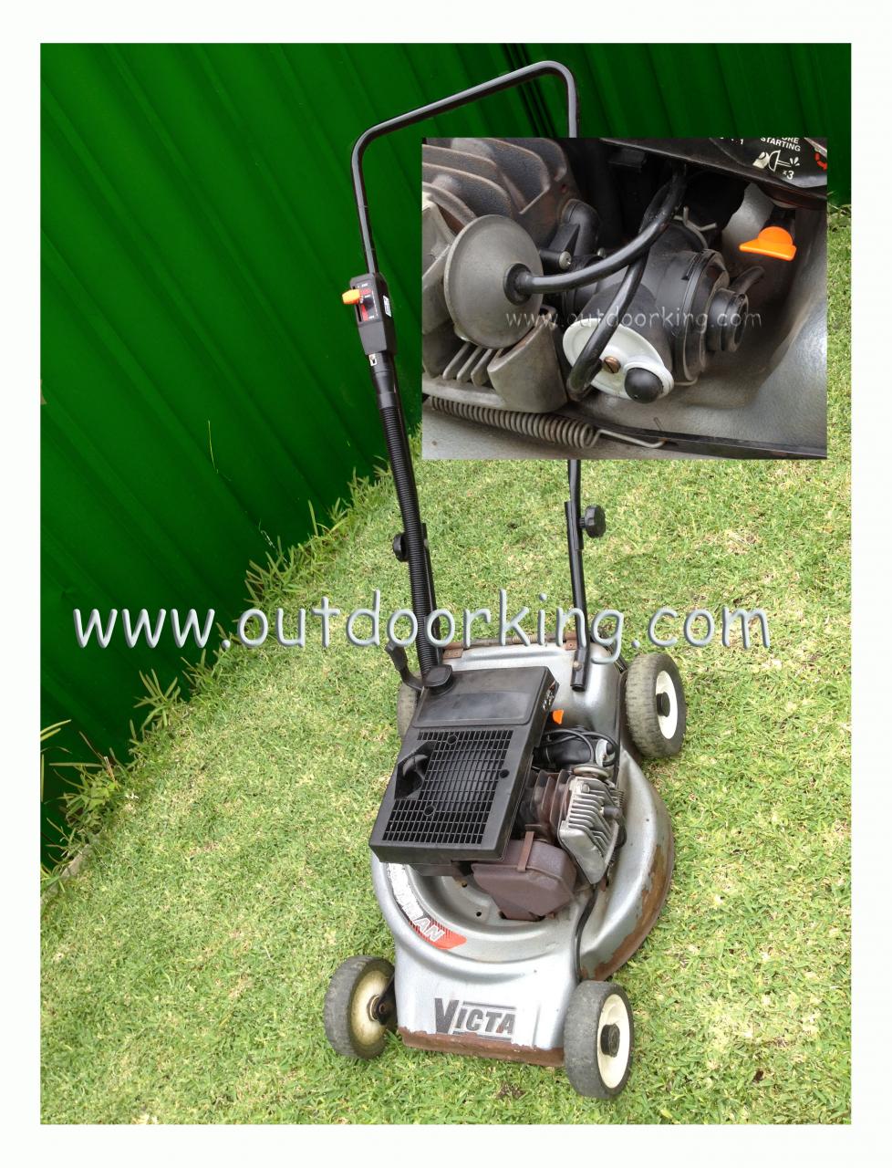

A photo for prosperity smile
(bit dusty just finished testing it)
Yes so it needs a New Paint job...maybe
if I do managed to re ring it, more likely rebuild is the go
(cylinder piston for a redone one but I may attempt it my self..then again costs add up quickly.. bearings etc if you want to do it right
And being non Oz version (sadly frown ), not really worth it I guess so humm)

Looking at those pictures it needs to pulled apart and honed and new rings fitted. You could probably save the piston.
The picture marked Cylinder, is that of the lower part of the piston, or is that actually inside the engine??
Now if thats what its like on the exhaust side, what is it like on the inlet side????
The piston only gets looking like that for one reason, its been run with no oil at some stage. The damage starts on the exhaust side and will get the inlet side last.
Like i said in the other post, they will run on stuff all compression.
From here on in i would say that you are just going to be making it worse.

that "Cylinder" photo is the back looking in from the muffler side
to the intake carby side your seeing
(so yes you are looking at the bore of the cylinder not the piston at all)
this is the full view of that cylinder photo
( EDIT..I wasn't expecting this to look as bad as it did considering I really do try and take care of it but well lack of knowledge dont help matters either...)
