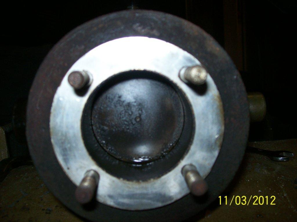

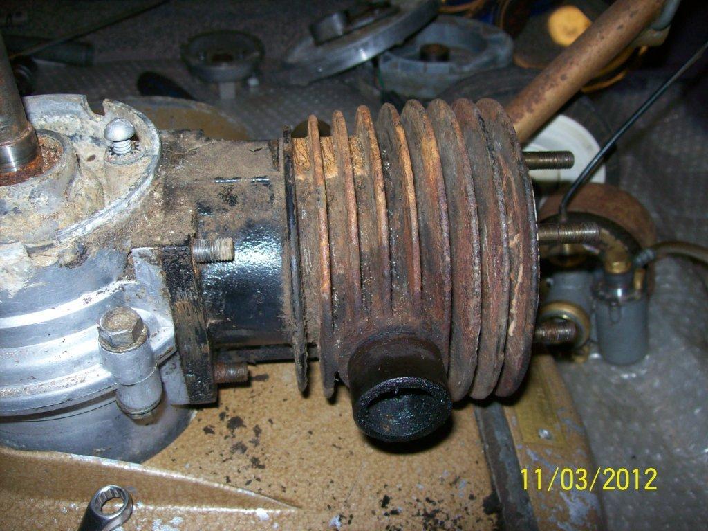

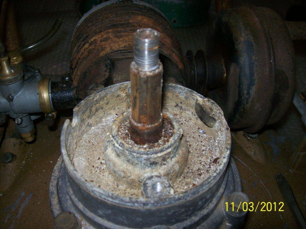

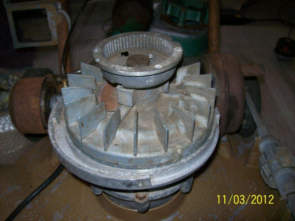

Well I decided that even tough I don't have everything I need to start the restore,that I had better do something with the engine before it does seize up.So I took it apart to see what sort of damage was done.I haven't as yet pulled the crankcase apart,but I will soon.The bearing I think are buggered.I did find some rust in the bore down the crankcase side.
Here are some pictures.
I will put some more pictures up after I have finished pulling it apart.
I'm sure I will be able to work something out with the ignition.
