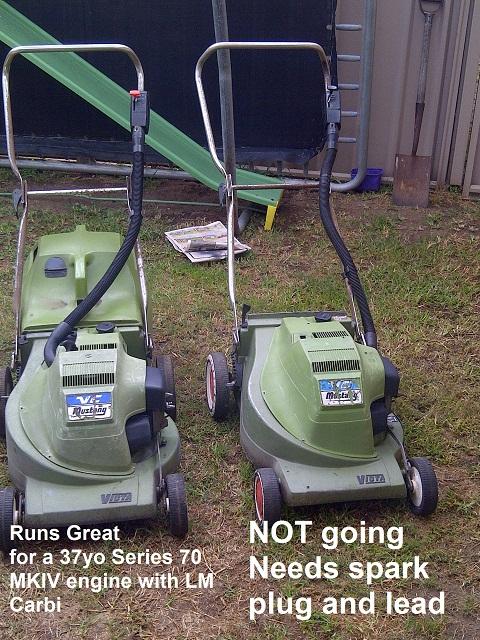

Hi,
well i have 2 Victa Mustang VC 160 - Mk IV 's 1 is going fine after bring it back from the dead had to replace the carbi (pulled a carbi off a power torque - Victa Hurricane, and new spark plug and air filter and fix the starter pull cord and clutch part of it . Anyway that 1 is fine . also have repainted the engine cover and exhaust .
The 2nd Victa Mustang VC 160 - Mk IV isnt as good the carbi has the primer on it and thats shot , so i have replaced it with a newer carbi i got hold of not sure how old but i pulled it down and cleaned it and replace the rubber circle flap thing, and tested it on my other mower (above) and its fine .
Now i need to replace the spark plug and the lead, and hopefully it it kick over and be fine .
Just wondering as anybody else had any probs with the engines ? Is there any thing else i should look at to be replaced and or cleaned etc ? any other issues i should know about ?
Finally - Anywbody got or know where i can get hold of a catcher for this mower as the orginal catcher i got with it was , well lets just say only option was the recycling bin .
By the way when i got both these mower they were chocas full of grass and chaff inside the cowling !!!!!! Anyway i cleaned them down and even steamed the engines and now they are looking great , Not really wanting to paint them just want to leave them original , shows character. Both decks are 97% free of rust , tiny bit of surface rust . Got them from a decaced estate and they had lived in the timer shed all there lifes. Not bad for 37 year old mowers smile
Thanks in Advance smile

The first one is a 1976-1978 MKIII Mustang, using the Series 70 MKIV engine, and the G4 carburetor (The carby you have fitted is actually an LM, but it will do Just fine)
The second is a little older, a 1974-1976 VC-Mustang MKIIA, this one appears to have the original LM, and also uses the Series 70 MKIV engine.
This engine was quite a solid and reliable engine, and given the TLC these mowers are getting, you should be able to get many many more years of reliable service.
Be make sure when looking for parts to get parts for a VC-mustang, not a VC-160, as the VC-160 ran a different carby and engine, and used a totally different chassis and catcher (Not trying to knit-pick here, just don't want to see you run into any troubles)
The catcher I might be able to help with, I should have a trip to Sydney coming up soon, so I will scout out the catchers at the local tip shop, and if I find one, I'm more than happy to grab it for you, the shop charges $5 - $10 for catchers, however, if I happen to be grabbing a mower at the same time, and it does not have a catcher, I'll pop one with it, as that way it's free.
I'll let you know what I find mate!!!
Also, if you are keen on really bringing them back to top shelf condition, I can keep an eye out for a new base for the one with the plate riveted on, but only if you want to head in that direction.

thanks Mr. Davis for the great info and the fast reply. well ive given as much TLC as i can and the 2nd mower , well its just some thing im going to get going over the next few months not urgent.
Yes i am keen for a catcher -pls send me an inbox with your contact details and we can work some thing out. I have searched a few salvage yards and on council dump wanted $40 for me to get in and pick what i wanted from the dump, wtf ????
Anyway the $ you mentioned is fine .
Funny thing is i have both these two Mustangs and i have a newer Victa deck with a Briggs and Stratton 4 stroke on it , and 9 time out of 10 i'll pull the Mustang out and fire that up to mow my lawns lol . Suppose its like car enthusiastic they like their classic car and prefer it over there late model car
the 2nd mower that has what we think is the original carbi on it , well its not the original one as it had the primer button down on the deck , that was shot so i got hold of another and its got a turbo jet style carbi on it.
Now and then the motors blow a bit of smoke but thats the thing about a 2 stroke !.
Somebody said to me when mixing up 2 stroke fuel as the petrol at the servos now days has no lead in it and these motors where built for "Super" leaded fuel , bloke told me to add an additional 10% 2stroke oil in the mix so 220mls to make up 5 litres of 2 stroke fuel . is it worth it or just stay with 200mls ?
Thanks in advance and look forward in hearing from you about the catcher smile

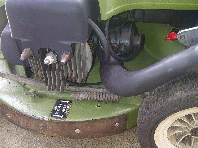

Hi, I have my father’s old Victa Mustang Series 70, 2 Stroke, Mark 4 lawnmower that has served us well however it has developed a fuel leak from the black primer bulb assembly. (See photo attached)
I have tried to get a replacement primer bulb however there appears that the parts are no longer available due to the age of the lawnmower.
Apparently my Victa Mustang has an early version Mark 4 engine with a LM carb and the configuration of the carb and the primer bulb are different to the later versions!
I am now wondering if anyone can please provide any advice on whether I can source a similar primer bulb or a solution to fix my fuel leak?
Cheers, Lecky23

The primer bulb isnt the source of your fuel leak, the needle and seat within the carburettor will be passing fuel and flooding it out the primer line. personally to start with id remove and clean the carb cap (On the back of the carb from the perspective of your photo, replace the rubber o ring and clean the float area (be careful and dont lose the needle) i have had issues with white primer caps over the years but never had an issue with these old remote primer carbs other than a little dirt buildup or the fuel tap being left on and forgotten about.

Yes as Joe mentioned when the float needle isn't shutting off in the carby the fuel level gets too high and starts to leak out
the primer orifice and into the remote primer.
The problem with this type of mower if you were to change the carby cap to a later model with the primer on the cap ,it would be too
difficult to prime as there isn't a lot of room to get your hand to that side of the carby.
I would buy a metal needle and see if that fixes the leak also every old Victa I've had problems with the rubber remote primer ,the problem was the rubber primer had aged too much and the rubber had gone hard ,so you may be interested in a replacement primer for easier priming.
Max.

Thank you, Joe_Caroll and maxwestern for your replies and comments,
I have been told by my lawnmower service centre that if the petrol leak came from the carby, it would be a problem to service the carby as spare parts (eg. Rubber O ring or gaskets, metal needles, ect) could be a problem as spare parts for such an old Victa Mustang may not be available anymore!
I have purchased the red primer bulb that maxwestern suggested and will fit this to my carby and see if this will stop the fuel leaking. If this does not work, I will try and remove the carby cap and clean around the float area and replace the rubber O ring if I can get a new replacement.
