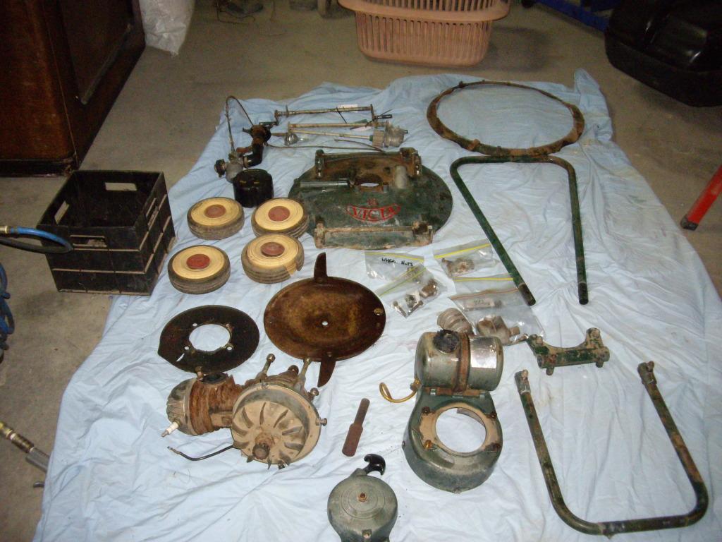

After My Dad past away last year. I decided to give his old Victa a new lease on life. It has a lot of memories attached of him teaching us kids to mow the lawn with it. I hope you guys on this forum can help out with advice and maybe spare parts i need.

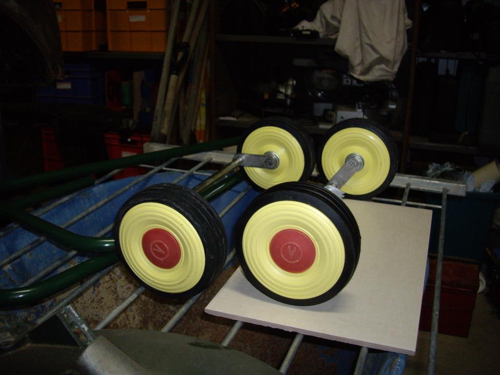

I manufactured new stainless steel axles
trying out the wheels and axles. I need to get all parts soda blasted now. Iam thinking of getting a small blast cabinet

That resto looks like its coming along well. I like the stainless steel axles.
Are the height adjuster gears new or did you salvage them from the old axles??
A few comments have been made about the reliablity and ease of use of the height adjusters.
Posts: 19
thanks Rodeobob. The mini will never be sold. "i dont know if it will ever be finished".
I salavaged the old height adjuster gears and welded them on to the shafts.
I did draw them up on Autocad and was going to make them out of stainless but i thought because they are inside the housing well lubricated it would be ok.
Stainless is good for corosion but is not good for wearing or very strong for the gears. the axles wont be doing much work because it will be a show piece.

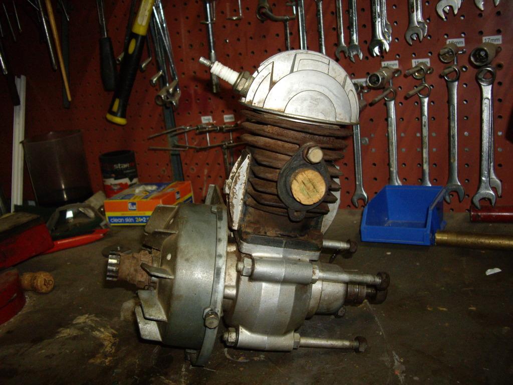

been a while since i have worked on victa but here is the progress.
[Linked Image from i281.photobucket.com]
Cool coming alone well.Keep up the good work.
