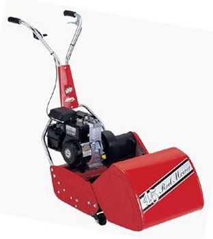

I know someone who has this mower. i assume it a fairly recent one with the black briggs motor (one before the current motor I just got I assume), a rover not a scott bonnar or are they the same thing? Was trying to find some model history on all the 45's for some sorta time line of when what came out.

The colours on that late SB-type mower indicate it is a Rover, not an SB. Rover bought SB and continued manufacture of the model 45 with very minor changes. Deejay can tell you what they were.

The Scotty 45 was continued under Rover ownership and eventually "badge engineered" to become the Rover 45 (solid red and green coloured) but some commentators have questioned the build quality as being inferior to that of the Scotty. I tend to lean that way also. wink
