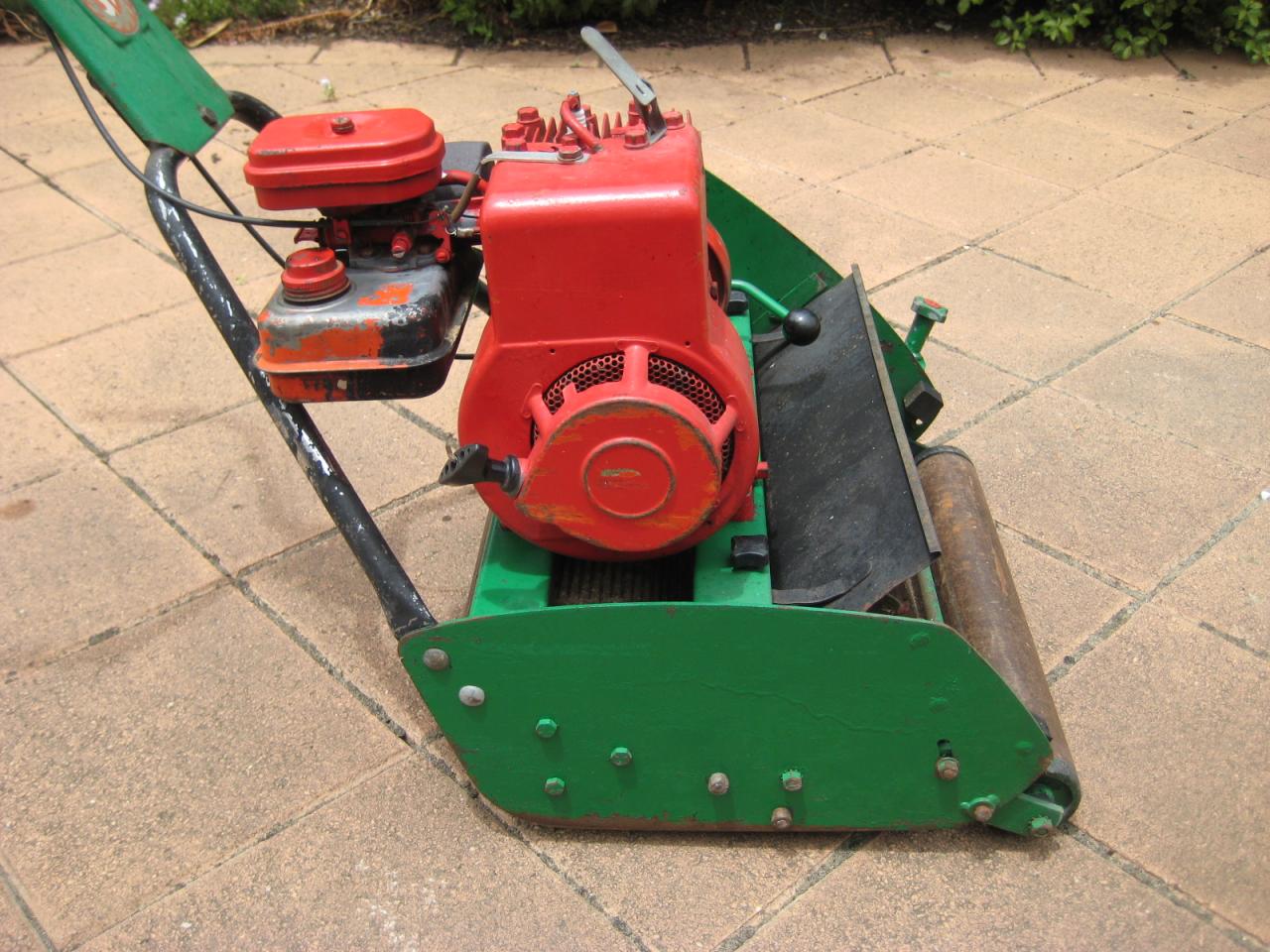

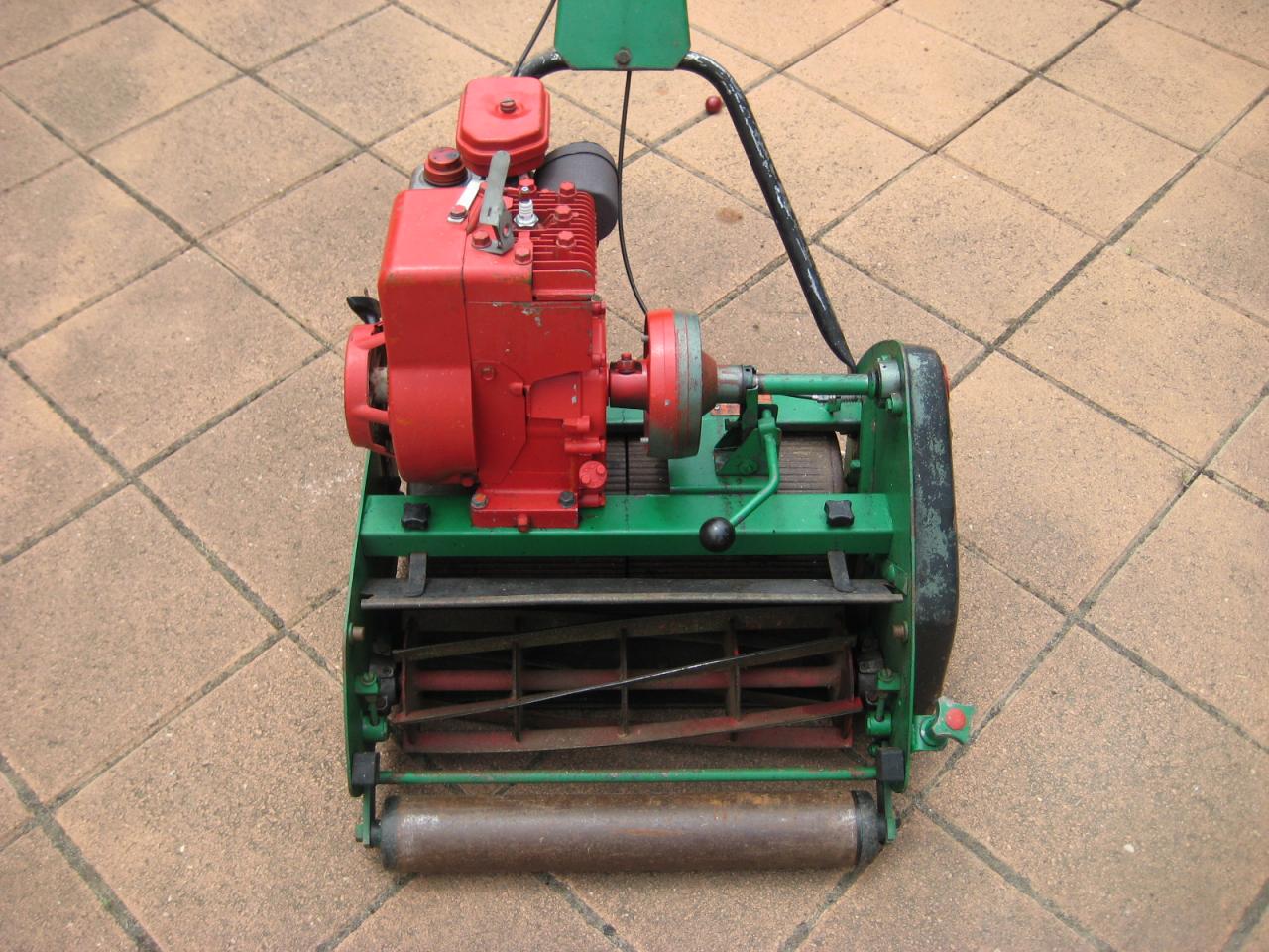

Hi everyone, and thanks for the warm welcome to the boards on the 'introductions' page.
I went to look into a couple of leads given by board members. On closer inspection I spotted some oily, felty looking gunk high in the cooling fins behind the cover. So off came the cover...to my dismay what I saw was just the tip of the iceberg. I blew out what I could with compressed air but it isn't properly clean yet.
Should I spray a bit of degreaser in there and hose it out, or would that be risking damage that I am unaware of? I can't see any exposed electrical parts as this engine appears to have a magnetic pickup for spark timing.
Anyway, the result of this is that I have not started it up again to report what I observe for grumpy's diagnosis. ...I'll keep ypu posted and take a few more pictures for Ty.
Cheers.
Joined: Nov 2011
Posts: 47
By the way, for Deejay's interest (I presume he drops in here from time to time) the numbers on the cover are as follows. They have been painted over and it may be that the 3 is actually an 8:
80102 0230-01 7508150
Beammeup, please re-post the pics of your SB45 in this thread, so it will make sense on its own. While you are doing that, please post the long string of numbers stamped on the cooling air cowl of your Briggs and Stratton engine. That will tell us quite a lot about the engine, and enable us to point you toward an owner manual and illustrated parts list, as well as telling you the engine's date of manufacture. The date will tell us whether you have breaker points (behind the flywheel) or electronic ignition.
You can put some degreaser on the cylinder head and hose it off if you want, so long as you have the muffler and air cleaner fitted at the time, so water can't enter the engine, and you do not blast water at the engine, especially the ignition coil. I suspect that "felt" was dried-up old grass clippings, and they do need to be removed, to allow cooling air flow.

Hi grumpy, Beammeup has posted the string of cowling numbers in the previous post to your last..... wink
Hi again Beammeup, we seem to have posted simultaneously a few minutes ago - thanks Deejay, for pointing it out.
The nearest operators' manual that B&S have (yours is rather a late 80102)is here:
http://bsintek.basco.com/BriggsDocumentDisplay/lrvvA-wU7eL7hAxB91ObQ.pdf
The nearest illustrated parts list is here:
http://bsintek.basco.com/BriggsDocumentDisplay/Z6jmvGVJ1DajI.pdf
(Deejay, as you can see, the spark plug shorting kill switch was normal for the 80102, and the 60102. That series of first-generation engines used a different governor design and had no provision for a kill switch contact on its base.)
Some other details: your engine was made on 15 August 1975. Since that is prior to 1983, it has breaker points, not breakerless ignition. The breaker points are in a little round tin box behind the flywheel. Your engine is 8 cubic inches displacement (130 cc), is the first design generation for that engine series, has a horizontal crankshaft and a Vacu-Jet carburetor, has plain main bearings, and has a rewind starter.
