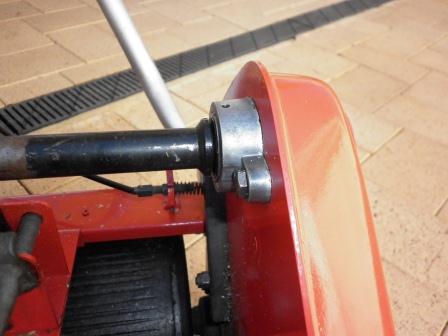

The bearing pictured above. Went to get one last week from local bearing supplies and they didnt have the same type as the original. So grabbed a standard bearing to try. Mowed the lawn today and the housing is quite hot. So would I be correct in assuming there is movement in the shaft from the clutch setup used etc and I will need to use the double roller bearing/self centering bearing type that was originally used?

You need to use the same bearing type that was originally used. If the original was a self-aligning bearing and you have used a rigid, non-self-aligning bearing, getting hot is only the first thing it will do, after that it will all be downhill.
Unless the crankshaft is perfectly aligned with the output shaft's sprocket bearing (i.e. the one you have replaced) the sprocket bearing must be self-aligning, or large forces will be developed on the bearings at both the crankshaft and sprocket ends. The crankshaft bearings are able to deal with a fair amount of that kind of thing, but a single-row ballrace is not. Also, the shaft clutch's alignment sleeve must have some tiny amount of slack, and that creates an additional need for the sprocket bearing to be able to cope with some angular movement.

The old bearing is re-greased and back in for now. It is very noisy and quite harsh when you turn it on your finger.
Got a new bearing on order now

As long as it was self-aligning, Steve, I think that would probably work quite well. The problem Jarrad has was that he put in an ordinary deep groove ball bearing. It was not perfectly aligned with the engine's output shaft - because that was not necessary with the original design. Consequently Jarrad's replacement bearing ran hot and was not going to last long. He put the original worn-out bearing back in so he could use the mower until he gets a new self-aligning bearing.
