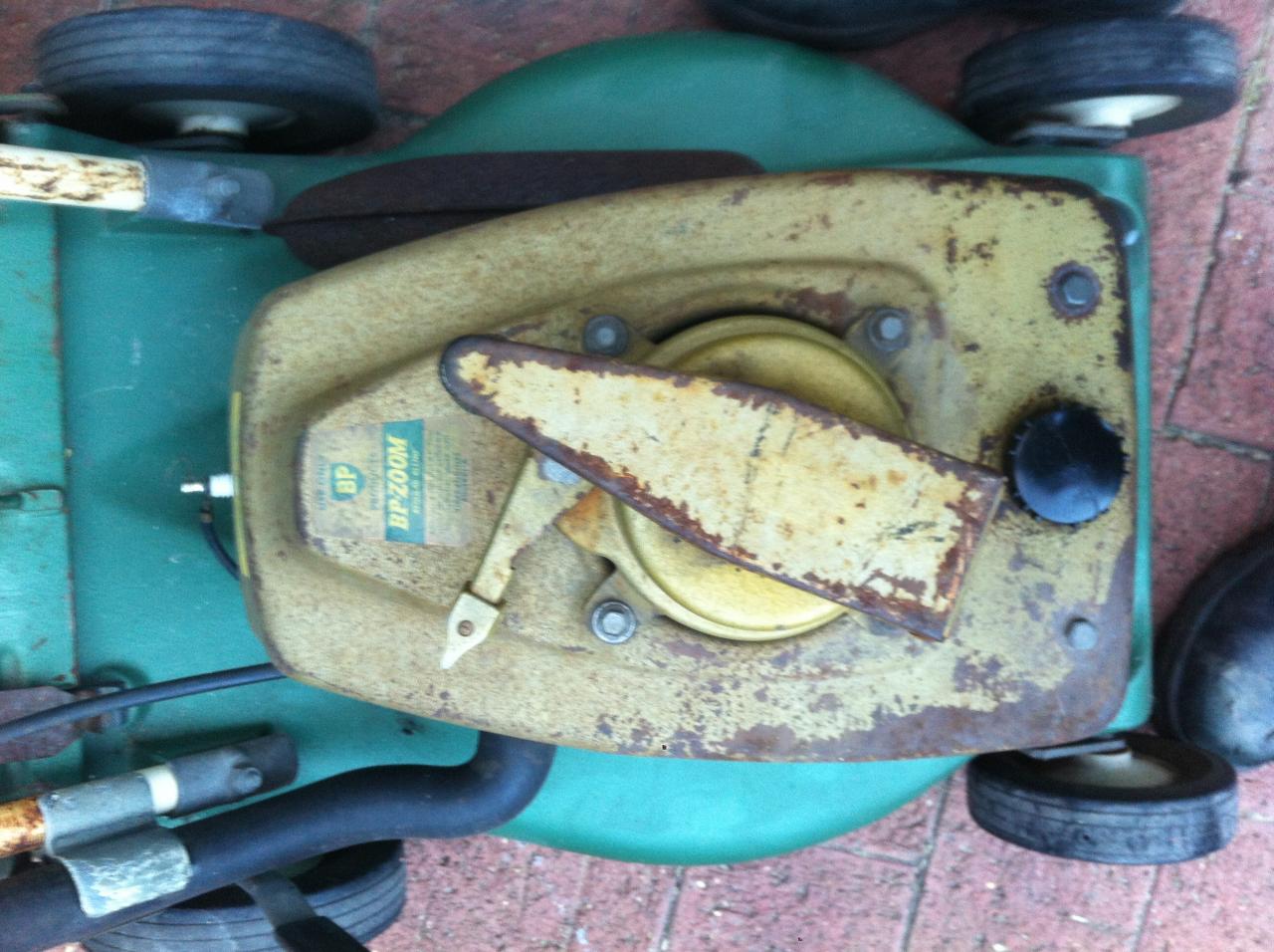

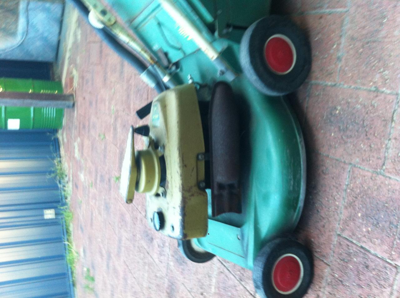

looks like a cortina right? still cool though with the winding start and i like fords so its a cortina haha

Hi Michael, it would be handy to have a larger and closer photo....it would make identification easier.
Could you please upload another pic?
Thanks mate,
OK, what you have there is a real bitsa, looks like a true home made mower to me, or, at best, a mower with substantial replacements.
The base looks to be a 68-73 Store brand base, the cowl looks to be off a corvette, and I doubt it was originally gold, the catcher is of a corvette or Cortinas of the early 60's, and probably does not attach to that base all that well (it will however hold in place)
I'm guessing from the look of things the engine is perhaps original to the base, probably a g3 carby on there, the serial will help ID the engine.
As for the specifics of a value, it's a hard one to value as a whole mower, but I would say $54 for it running is not too much.

This one is actually original, contrary to my assessment from the first picture, It is a 1968 Mayfair Deluxe 2 (V76) Model 559.
125cc Victa engine (Model 3680) With a Victa G2 Carby (this carby is quite rare, and you appear to also have the correct and full cut-out assembly) it uses the 12-189 "Sure Start" trigger release Impulse starter, with no decompression system.
The mower itself is not especially valuable, $20 - $40 i would put it at normally (that's based on what I would generally pay for one, if I was after it) however, with the G2 setup, i would put it more around $50 - $80 depending on detailed condition and running performance.
