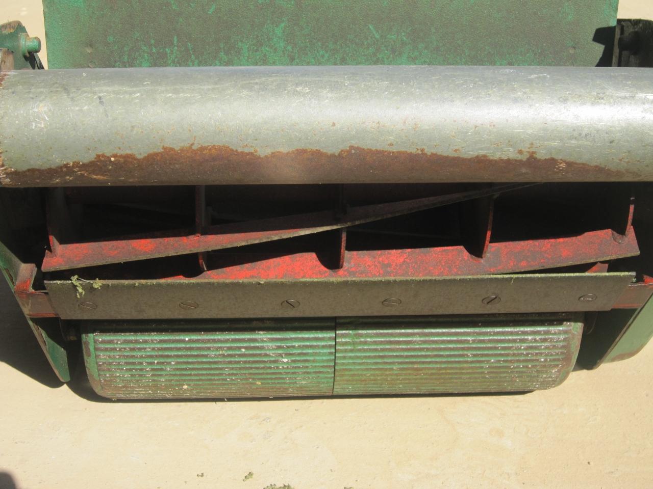

Could you please post some pics of your machine, and especially the reel and bedknife area, so as we can see the condition of both. grin

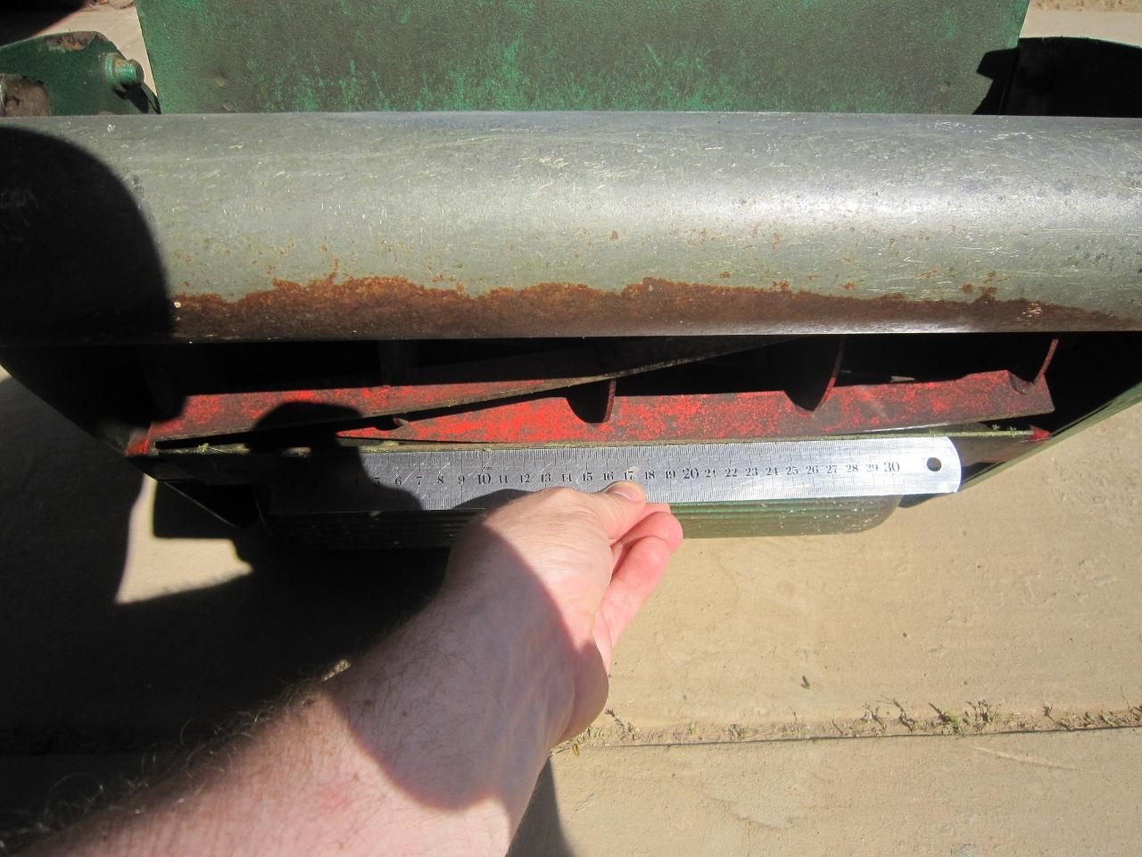

OK - here are the pics of the BedKnife and blade...
After tinkering today I think the issue may be the throttle cable linkage - there seems to be quite a bit of play in it (when I move the throttle handle it doesn't seem to move the throttle linkage by the full range of movement).
Looking at the blade and knife contact - it is definitely contacting 'too much' is my guess..
Any who - feedback welcomed smile
Jeff

Looking at the reel itself, I doubt that it has ever been sharpened in its life.
The same could be said of the bottom blade, I guess..
A good spin-grind of the reel and a grind and lap of the knife blade could do wonders for the cut....makes it easier to adjust as well, as everything is "true". wink
The cylinder reel, having constant contact with the bedknife, would have caused un-even wear of both over time....
If you plan to adjust it, please read my sticky on Scott Bonnar routine maintenance, I have shown the spanner I have modified to make the task easier. You may consider making one yourself. grin
