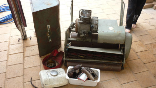

Oops I did it again. Just accidently bought a 24' supercut on ebay for $100 (Thought it would go for more, thatl learn me). I haven't finished my 45 20' yet is still at the sharpeners. I am now in the predicament as to which one to keep/sell whatdya think?
I am considering finishing the 45 20' and selling and putting a brand spankin motor on the supercut. What motor dya reckon? there are 3.5hp B&S motors on ebay for $275 http://www.ebay.com.au/itm/Genuine-...rs&hash=item3f0df816b3#ht_1693wt_952 , would these be OK?

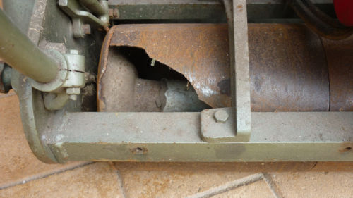

The supercut also has a busted roller. Are these available or should I get the welder out and patch it?
Looking forward to hearing your thoughts.
Thanks, Graham [Linked Image]

I have a 18" Model 17 Supercut electric here that would suit you for parts as most Model 17 chassis parts (except for handle and cylinder reel) are interchangeable with the 24"...It has both rear rollers intact and in fact the mower is in serviceable condition. Yours is a 3 segment rear roller, mine is 2 but my rollers are the same as your 2 outside ones.

Graham, in the first picture the current engine looks like it might be a Honda (because it has a red cowl). It is important to work out whether the mower was made surprisingly recently and that engine is the original one, or the machine is from the 1950s and originally had some ancient British engine. This is important, because the mountings and crankshaft height are likely to be different. Was it made originally with a modern (Honda) engine, or has it been converted? Also I take it that the engine is defunct, or you do not want to rebuild it? Essentially, there are three ways you could go:
Option 1: restore the mower to its original specification, whatever that was. By doing that you make your machine into a potentially valuable collector's piece.
Option 2: repair the mower at minimum cost. That would involve identifying the current engine and then finding a second-hand four stroke engine that is physically interchangeable and has at least as much power.
Option 3: fit a new engine. You would still need to establish what type of engine fits the machine, then buy a reputable engine that is physically interchangeable. It would need to be a 4 stroke to suit the kind of service it will be used for. Between them, Briggs and Stratton and Honda produce the bulk of the world's engines of that general type, and both make excellent engines, subject to some quality control questions in the case of Chinese-made versions of both brands.
So, the first thing you need to do, is decide what you are trying to achieve: just mow the lawn, or acquire a classic mower and preserve it for posterity. The best classic mowers are restored to their original configurations, so you would need to find out its exact specification when new, then make a plan to return it to that condition. Before you go too far with plans, you need to verify the condition of the parts that would be difficult to restore if they are badly damaged. Examples are the drive cover, which presumably has to end up oil-tight, and the gear train inside it. If bad things have happened in there, the Scotty 45 will start to look like a really good option.
With regard to the roller, cast iron is usually regarded as quite weldable unless it is "white" cast iron (i.e. chilled during casting, to make it hard). However to end up with a good quality, robust, cylindrical outside surface is quite a lot of work.

Most of the 17's in service today have had Briggs or Honda's retrofitted as has this one....You can tell by the petrol tank and cowl in the picture...also the reduction gearbox on the engine.

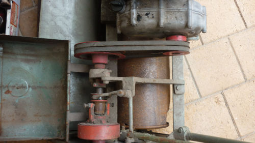

I'll come back to your specific question, Graham: whether the 3.5 hp Briggs 550 series engine would be a suitable direct replacement for the current engine. The answer is no, because the current engine has a reduction gear on its output shaft, to make the output shaft speed suitable for the mower. I'm guessing that the original engine was a thumping old English 4 stroke that did its best work at about 2,000 rpm. Modern equivalent engines, including the 550 Briggs, do their best work at 3,500 rpm, so you need an engine with a 2 to 1 stepdown gearbox built-in. Both Briggs and Honda make suitable engines, but you need to find one. The 3.5 hp output level is, in my opinion, barely sufficient for a 24" mower. You might find it a bit reluctant to climb significant slopes whilst mowing (that is a heavy mower).
The obvious alternative to an engine with a built-in reduction gearbox is to use a pulley on the mower drive shaft (not the engine output shaft) of double the current diameter, and achieve the required step-down entirely in the belt drive, but it is evident that there is not room for the larger pulley, so the reduction gearbox looks like the best option. Note that because your mower uses a belt drive between the engine output and the mower drive, the height of the output shaft from the engine is not an important issue (within reason): all that happens is that the length of the belts may change. However I do not see a mechanism for tensioning those belts, which may be a problem.

Hi Graham, I have made some inquiries for you and sourced a second had left hand rear roller segment for your Supercut.

Step 1: Make a chalk mark on the existing engine's output shaft, and rotate the engine until the output shaft has made one full turn. Note how far you turned the crankshaft to do this. That will tell us the output gearbox ratio. It may or may not be 2:1 - we need to know for sure, to perform Step 3 below.
Step 2: Unbolt the current engine, move it backward 6", clamp it in place, and see how the mower feels with that slight rearward shift in center of gravity. Remember, it has to be reasonably stable, with weight on its front roller, when tilted backward 15 degrees, simulating climbing a maximum slope.
Step 3: If Step 1 indicates you can move the engine backward, that is the solution so you won't need an engine with a reduction gearbox. Source a double V belt pulley of the diameter of the current mower shaft one, one multiplied by the gearbox ratio determined in Step 1.
Step 4: Buy a new or second-hand engine (I'd choose second hand, of course) of about 4 or 4.5 hp, with an output shaft long enough to suit the V belt drive. Cut a piece of 1/4" steel plate that will cover the existing 4 engine mounting bolt holes in the mower frame, and provide room for 4 new engine mounting holes sufficiently rearward to allow the engine's output shaft V pulley to clear the large new V pulley on the mower drive shaft.
Step 5: Weld the plate to the two mower frame lateral rails. Bear in mind that one day, the welds will need to be cut to restore the machine to original condition. Drill the four mounting holes for the replacement engine procured in Step 4. Put it all together and go looking for a 15 degree up-slope so you can see if you got it right.

The only reason to move the engine backward is to leave room for a much larger pulley on the mower drive shaft, without it hitting the small pulley on the engine crankshaft. By the time you put the small pulley directly on the crankshaft instead of it being moved 3 or 4" backward by the distance between the gears in the reduction unit, you've effectively moved the engine pulley forward 3 or 4". It looks to me as if it would hit the bigger front (mower drive shaft) pulley unless you moved the engine backward that 3 or 4" plus another couple of inches because of the larger front pulley.
Yes it does change the center of gravity, but that is undesirable. That is why you have to carry out Step 1, to ensure the mower won't want to tip backwards when you drive it up steep hills.
