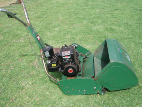

I'm a new member on the forums, picking up my EBay purchased Scott
Bonnar 45 tomorrow - so I expect I'll have more than a few questions as I get it up to speed!! I do already have a 'dumb' question - what does the 'Bed-Knife Buddy' do and how do you use it? I looked at the photos in the prior post but can't figure it out...

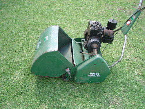

This is my new beast - looking forward to having a tinker (already read through deejay's maintenance post...
Jeff
It looks as if the reel may never have been reground, so you should be able to get a very long life from it before you need a new one (which is expensive). It also has a Briggs and Stratton engine, which is likely to be the original one, increasing the likelihood that your mower has not been used commercially. This again is good news. After you do the basic maintenance, make sure that the reel is not physically touching the bedknife as it rotates. (Don't try to adjust it until you've done some research on the process, though.) If there is no reel-to-bedknife contact, once you've done the basic maintenance you could try using it and getting the hang of it. Once you are through that stage you get to the advanced course: blade adjustment. There is plenty of information on that in past threads here.
