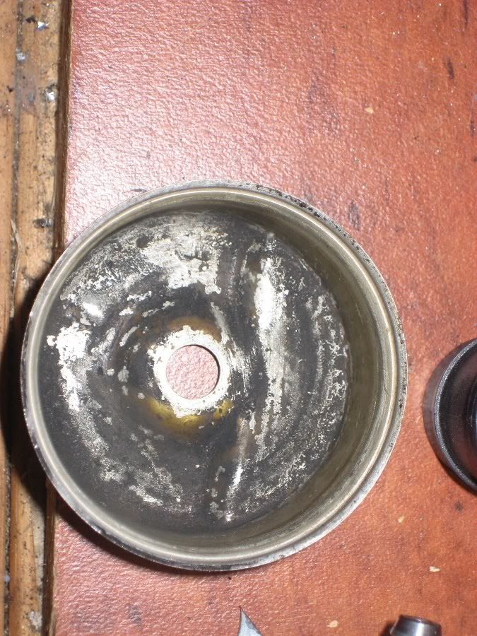

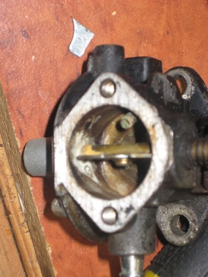

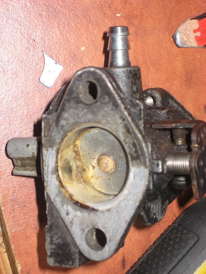

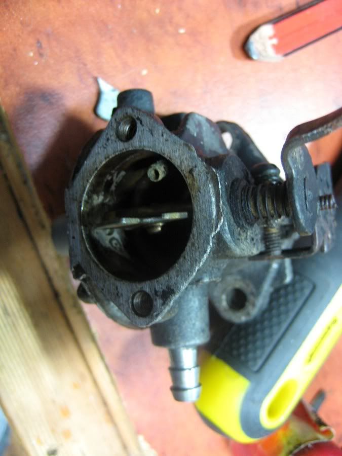

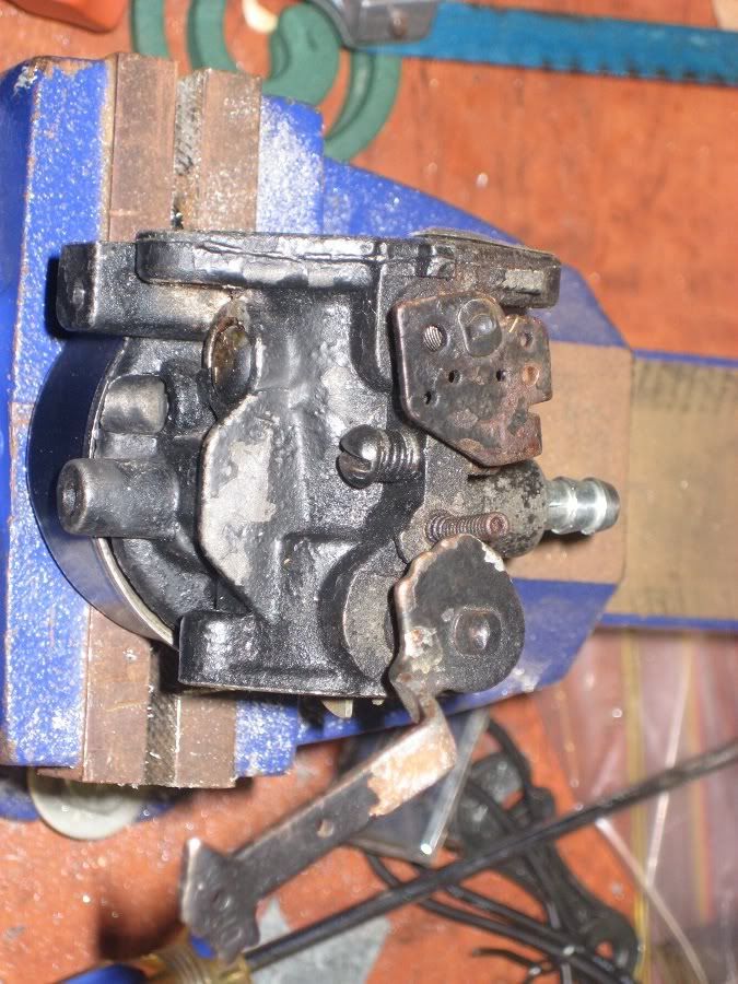

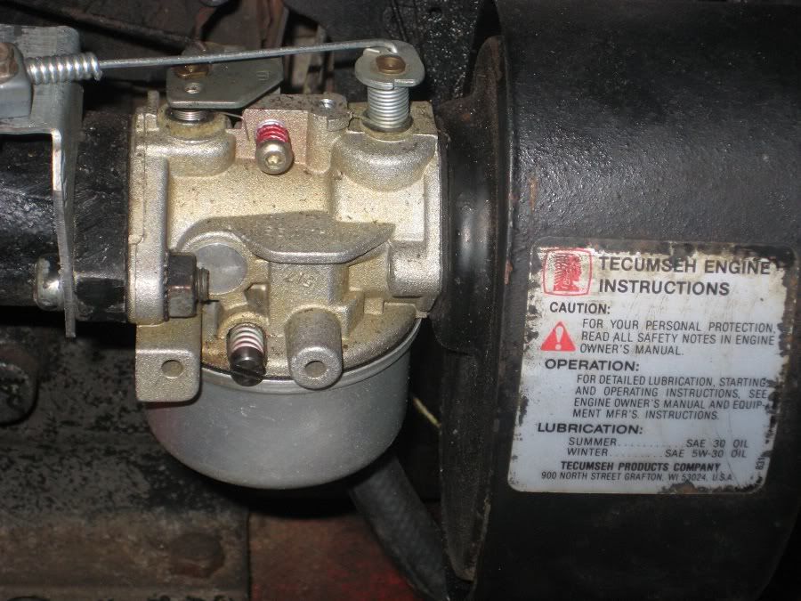

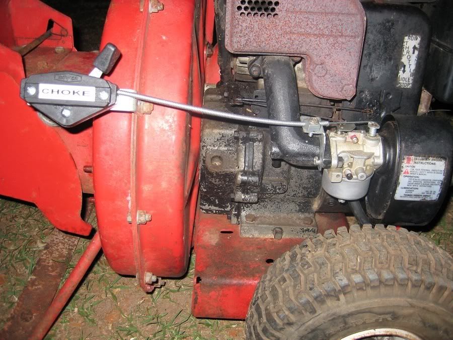

Here are some pictures of the old carb and the new one
Old carb with the direct choke control
Corrosion in the old carb, sorry for some average pics
The new carb and the choke control I dodged up. It bolted straight up and the machine runs great. I just had to make up some quick brackets and on old cable to get it running.
Al
aldot #29356 02/10/11 01:29 PM
That choke setup looks very well done, not dodgied up at all, I have seen much worse home repair jobs before smile
