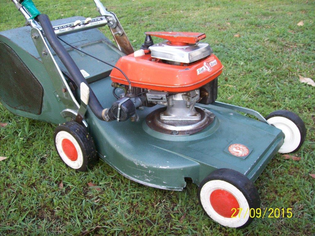

IT'S ALIVE.OK guys and girls.Put my Scott Bonner back together put some fuel in on off she goes.Couldn't believe that somebody would through it out.Here is a you-tube link to it.
[video]
[/video]

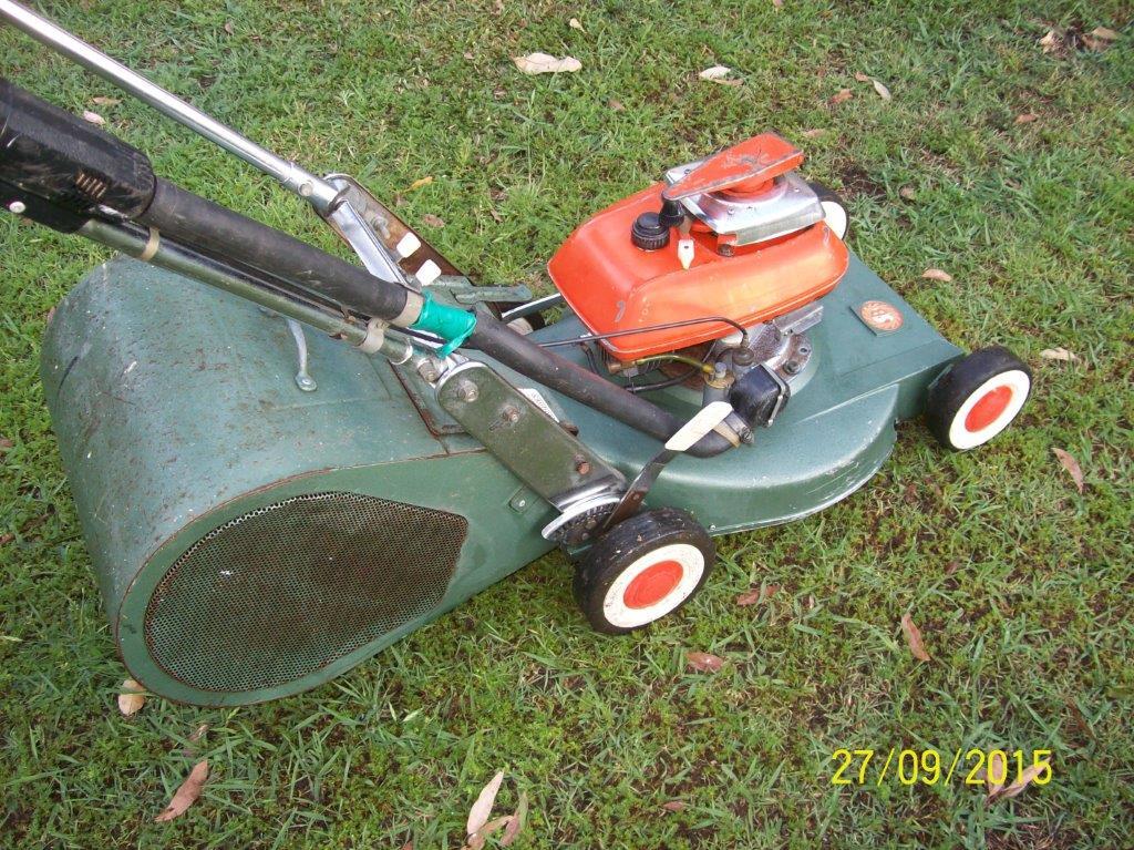

I did notice that before I started it the air tube was broken,big hole.Notice the green tape.I don't know what I did wrong,but I have to fix the throttle as it doesn't seem to work,or maybe that's why it was tossed out.
Have a look let me know what you think.
Good job on getting 'er running...... as to the throttle, maybe the slide isnt going up and down?
Yeah it might be something like that.Unless it's not lined up properly as when it's out of the carby it works.Just doesn't seem to when it's in.I'll have a look in a few minutes.I have some other mowers I need to wreck today.
OK I had a little play around with it.I had the plunger around the wrong way.Now I can adjust the revs.It' seems that I have to do a little adjusting with the cable to get it right,but I'm on the right track now.

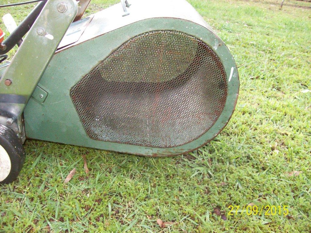

yer blumbly having the tickler the correct way helps i noticed your starter housing is around the wrong way also the catcher is from a 4 stroke 49 0409 tecumseh vk 30 your model is a 49 0206 with villiers 2 stroke cheers steve...
Yeah maybe somebody turned the starter around I'm sure I will be able to turn it around the right way.Now don't be upsetting me with the catcher.How do you know that any way? It looks the same as the the one's I have seen.Also when you look at the paint I would say they have come off the same gun.It has whethered the same as base.I mean from what I have seen the 4 stroke and the 2 stroke used the same base.So why would the catchers be different?
Joined: May 2009
Posts: 191
I think u could be right blumbly about the grass catcher if u think time line villiers then tecumseh metal then poly its my catcher that is not correct its strange tho my 49 has the original spark plug and air filter the tyre tread is not worn still has the lines cheers steve.
Yes well that's all my baby needs is the right air filter box and the right fuel cap.After looking at it the reason why the starter is around the wrong way is because the fuel cap is to big and there's not enough room the release trigger.

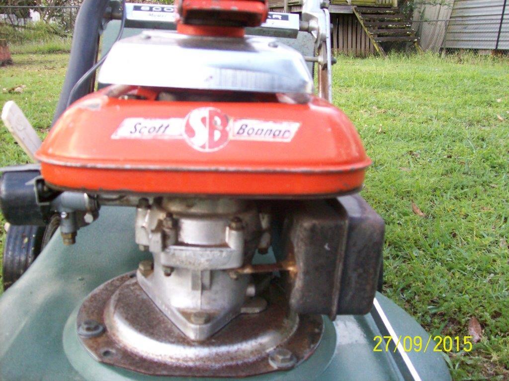

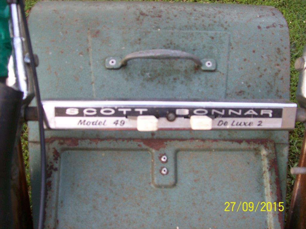

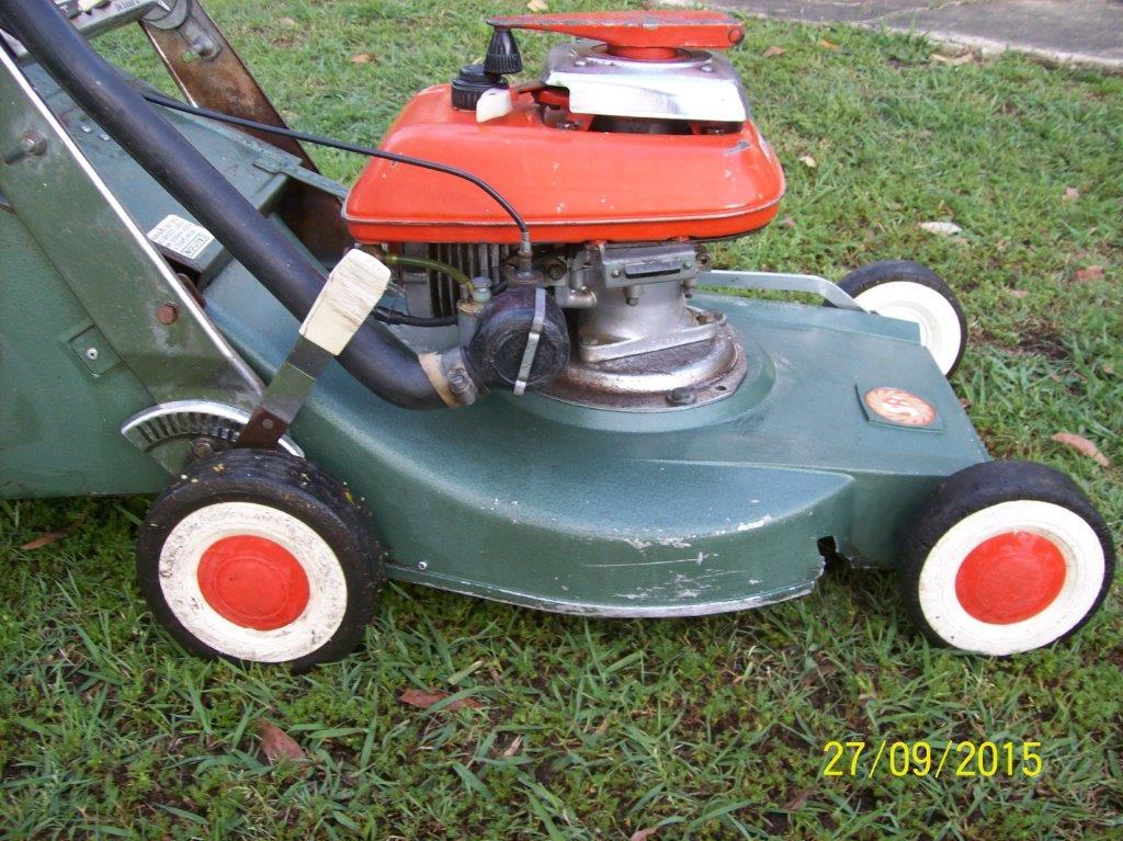

Finally dusted off the cobwebs and gave it a good clean.
Took some better pictures of it to.
Here have a look.

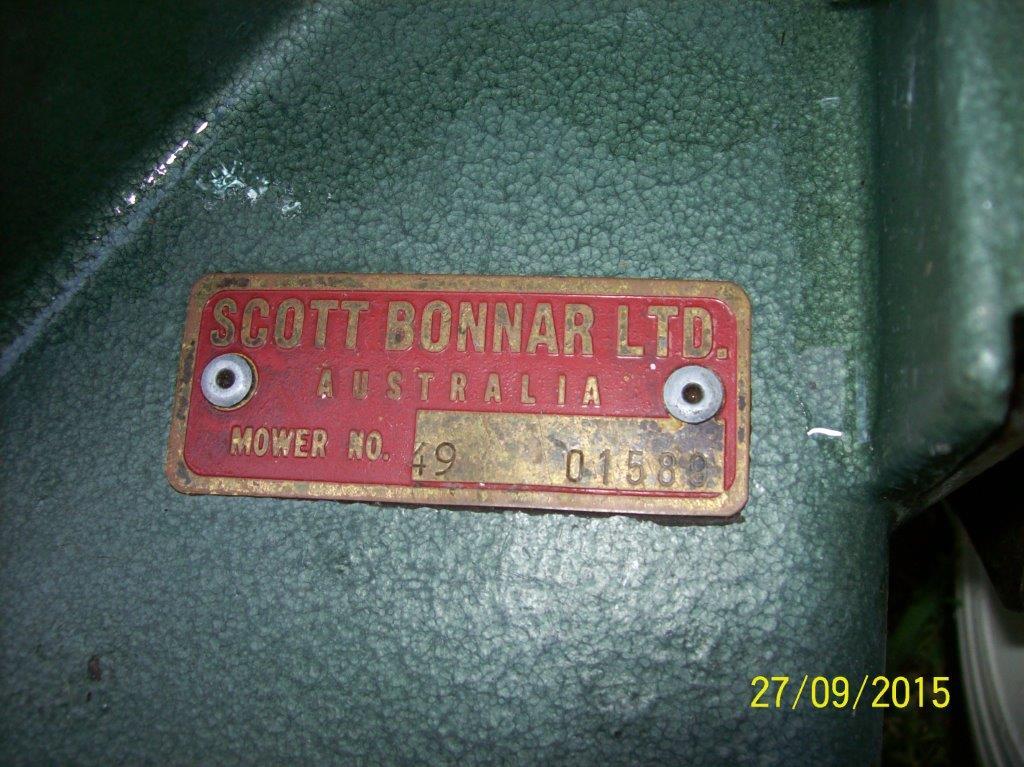

I thought I's add a picture of the model plate as I have found that from a model list this model isn't on that list.
Not sure why but does anyone have any information that could shed some light on this?
The model is hard to read but is is model number 4901589.Most of the model numbers that are listed only have four number after the 49 this one has five.As you can see behind the right front wheel there is a chunk out of.So I started my search for another base,and believe it or not I found one.However I believe it was an original four stroke base.It's model number is 4908706.Once again an extra number.
Does anyone know anything about that model number?

Hello Blumbly
I think I can answer your question about the Model 4901589 & 4908706.
Why do they have an extra digit? Answer: They are not model numbers.
What you have are mower number plates.
In your photo the plate actually says just that. It's a mower serial number.
On some machines, SB included an extra plate with the Model number:-
[Note how the mower no. and the model number begin the same]
So, your machine model number(s) should be interpreted as per
my list in the ODK History Record.
