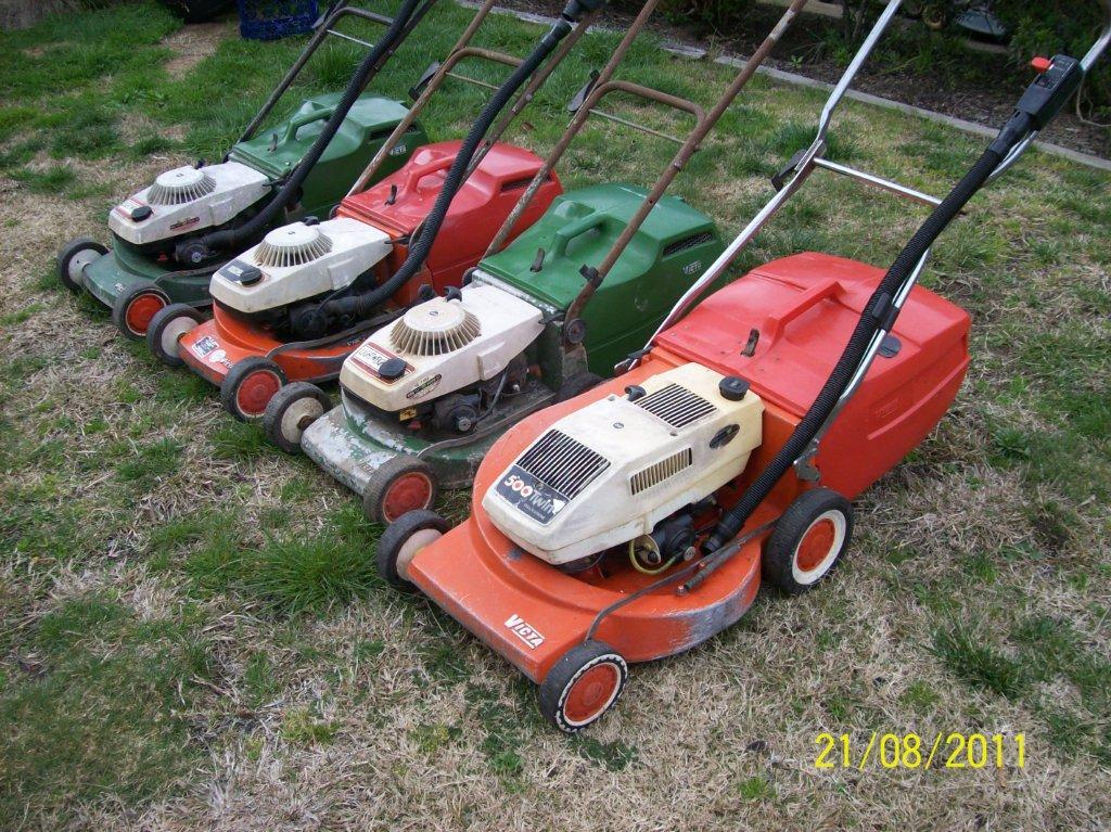

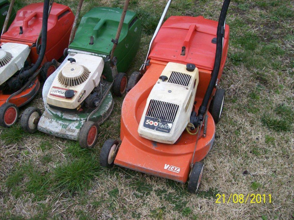

Hi all just thought you would like to see an almost set of the Twin, smaller brother and sister,or maybe around the other way.How do you tell?
They will be a bit happier after they are restored.Will be a while before that is done.There are many in front of them.
I hope you manage to find the other two, particuarly the green supreme, that would add nice balance to the picture.
After looking through what little I can find, I have a feeling the Green supreme is a twin with a revised coil, while the gold supreme is the same as the green, but with hight compression heads, and a suitable adapted muffler.
The coild revision came about due to the high failure rate of the Twin coil, due to this high fail rate, there is a good chance the twin engine you have would count as a supreme engine, as back in the late 70's, if the coild died (whitch it often did) the repair shop relaced it with the new, revised coil.
So many twins are in fact defacto Supremes.

What years are the green and orange ones, which came first and second etc???
Would be good to put an 18" in between them.
Say a G3 sports in with the orange ones and maybe even a series 80 mustang with the green ones. The G3 (VC) mustang probably wouldnt look right as its a different green.

Also when you unload to you-tube you can put whatever name you want.Doesn't mean it's right.Let's just say for example they put 1962.People would go around believing that,but it wouldn't be correct. Al-thought the Lightweight and compact where exactly have the Twin.So much so it even is the same crankcase and cylinder etc.It wasn't released until 1977.It was 83.195cc.They just called it an 85cc.It also had the pointy cap on the air filter housing as well as the twin.So if anybody has any and would like to see them go on the right mower.Please let me know.
