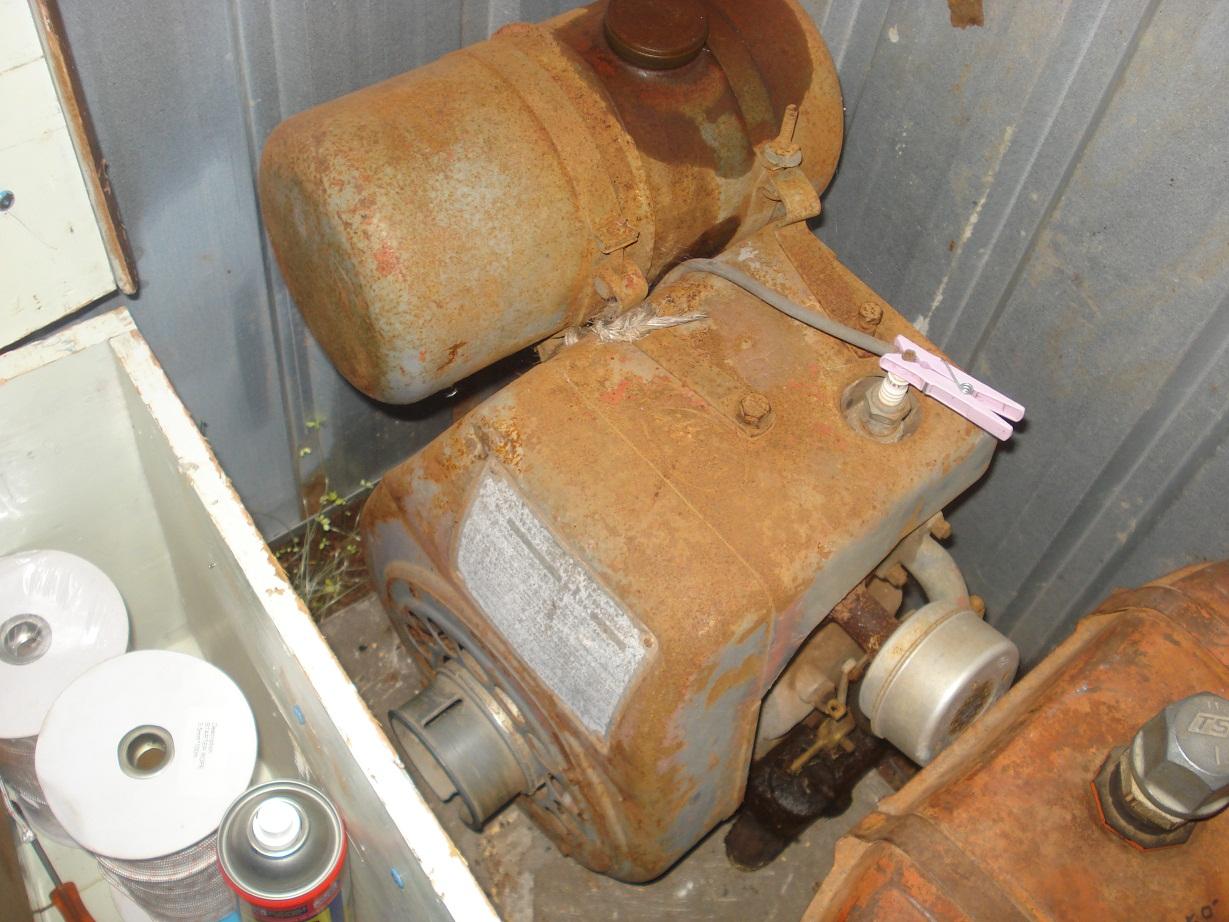

First up is a litle mk10, its a fairly late model owin to the square original fuel tank. I remember buying this with a victa 18 for $70, it did run quite well last time I fired it up....
Second (the orange one) Is a mk12/2 it runs okay, cant remember how much I paid, but a good little engine none the less.
Third the greyish silver mark 12/2, got it last weekend for $30, was completely seized due to a huge mudwasp nest in the pump and cowling, cleaned them bastards out, cleaned and reset the points and ignition timing and it runs like a champ.
Fouth is the big ass rusty mk25, its all there and has good compression. I have never run it. Bought for $10 at an auction a few months ago........
Fifth, a biggish mk20, in very good condition, I have still not run it.
Sixth, a norton villiers, been hacked around a bit but still runs sweet, the big muffler on it makes it whisper quiet.
Seventh, the rusty grey mk20, my very first villiers, was seized solid when I got it, I pulled it apart, cleaned the bore with sandpaper, reassembled, guessed the timing, etc and it runs like new. even with my rough jobat cleaning the cylinder it still uses no noticable amount of oil!
Lastly, a sad basket case waiting for me to put together. I bought new crank seals and bearings, just gotta get time to put it together....

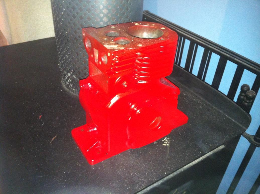

Last week I started work on the mark 12 villiers I bought as a basket case, turns out one lobe on the cam is f##ked, I have a bit of work to do anyway, I do realise I got a bit of paint on the bore and valve seat, all will be lapped, honed and cleaned anyway, with the state the camshafts in it will run, but I would never put it back into 100% use like I would with any other.
This thing was horrible, the sludge in the sump had actually blocked the oil feed hole to the oil dipper well, so one can only wonder how long it was poorly lubricated from.
#46777 22/06/13 05:12 PM

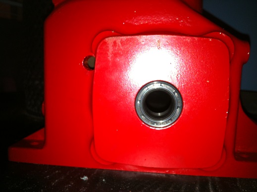

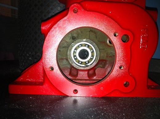

I have started cleaning up the head surface of the block, lapped the valves and refitted, pressed in a brand new main bearing for the output side and a brand new oil seal.
Tomorrow I hope to fit the crankshaft, govenor, cam, etc. as I only have a parts list and operating instruction manual everything is trial and error at what part goes in first.
