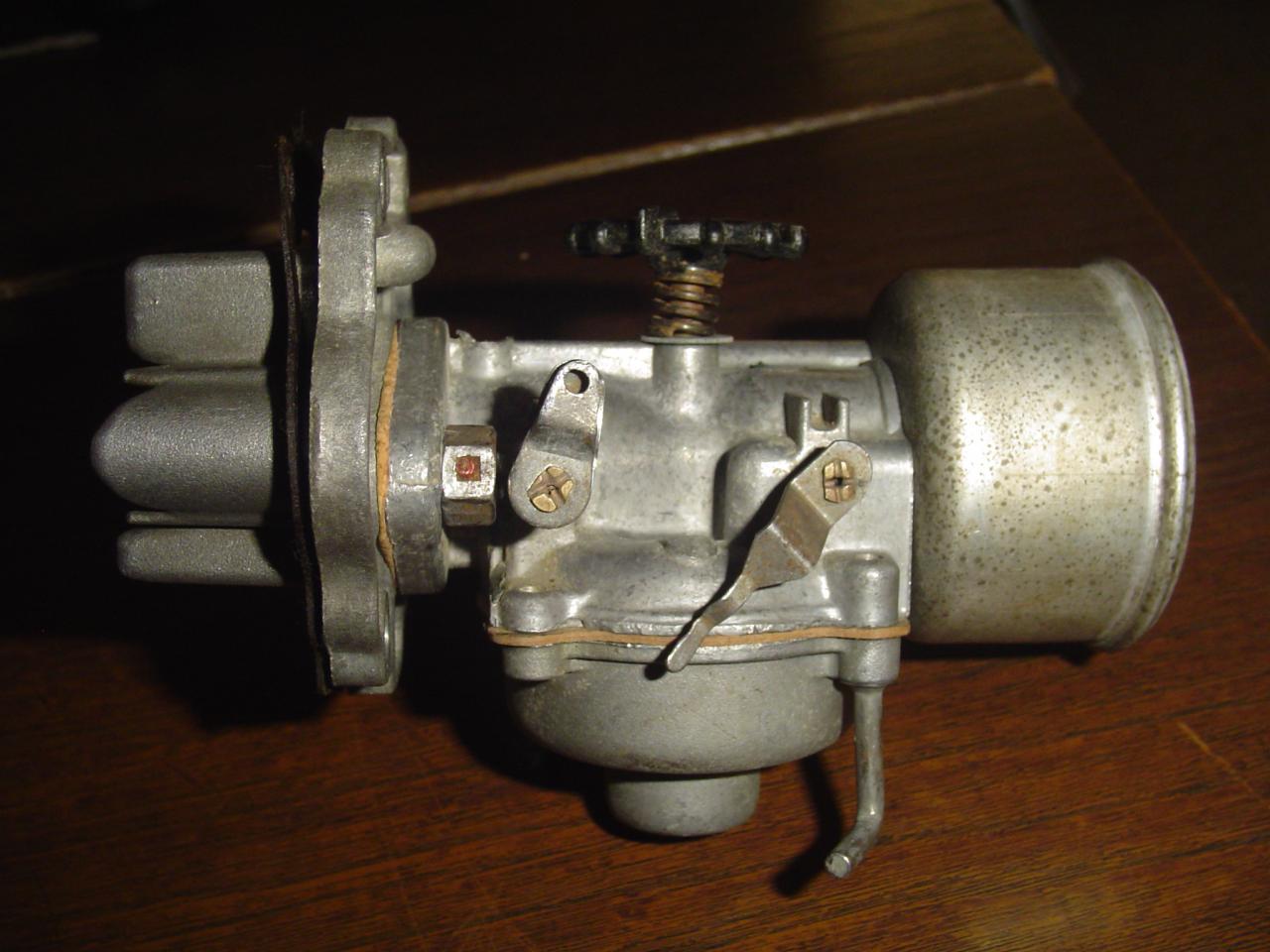

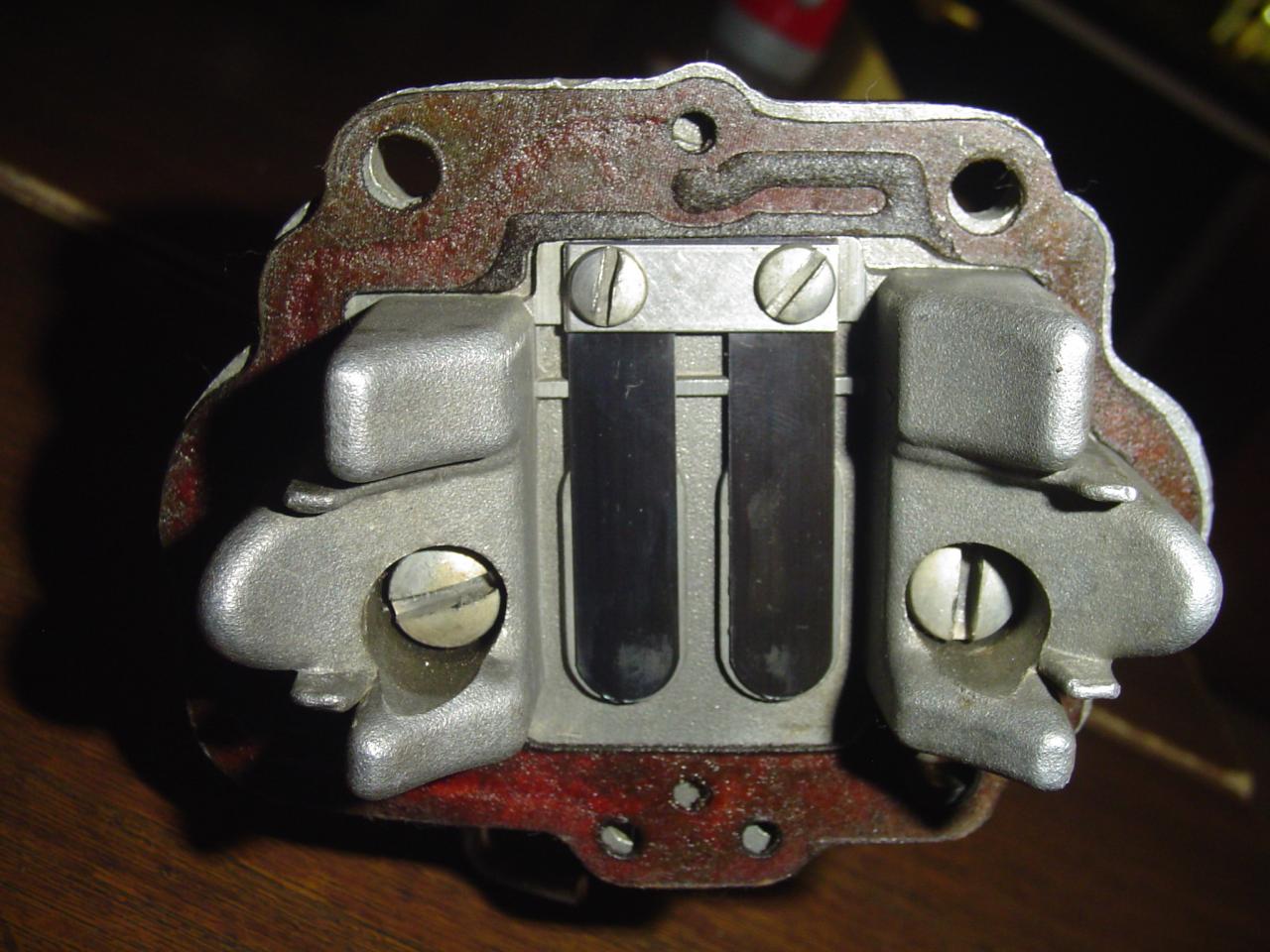

I like the reed valve layout Pete - look forward to getting at least some of the pics onto Outdoorking and discussing it - especially if you have some pics of the reed valve, carburetor and intake system. I'd like to see the inside of the crankcase with the base removed, so we can see how they are keeping the intake area clear during the compression stroke. Hi Grumpy, are you looking at the right mower mate because the reed valves aren't showing in any of the pictures. I just looked through my pictures and i have some of the carby dismantled a bit but the reeds are showing, dont have any with the internals though sorry. ![[Linked Image]](https://www.outdoorking-forum.com.au/forum/uploads/usergals/2011/08/full-4284-2807-carby_before_clean.jpg) ![[Linked Image]](https://www.outdoorking-forum.com.au/forum/uploads/usergals/2011/08/full-4284-2808-carby_before_clean_5.jpg)
Posts: 6,926 Likes: 11

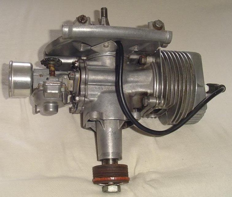

![[Linked Image]](https://www.outdoorking-forum.com.au/forum/uploads/usergals/2011/08/full-2772-2836-iron_horse_2_stroke.jpg) This picture shows the basic layout Pete, with the intake directly into the bottom of the crankcase (there is no piston-controlled intake port with a reed valve engine, because the reed valve does the same job better). The one you've just posted gives us a good look at the reed valves themselves. To complete the illustration of the way it works, I was hoping you'd have a picture of the inside of the crankcase, taken through the opening where the carburetor and reed valves attach, with the piston on the way up, so we could see how much room there is for the mixture to go in despite the crankshaft counterweights being in the way. However if you don't have that picture, that's OK, I'm just glad you captured the ones you've shown us. There is very little reed valve information on Outdoorking.

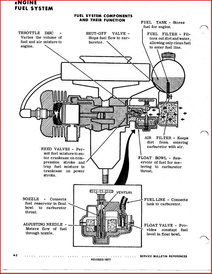

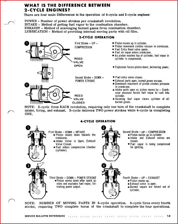

Thanks Pete, what I was trying to get a feeling for, is how the incoming air/fuel mixture gets into the crankcase, because the crankshaft counterweights are passing the reed valves at the time it has to happen. As the diagram shows, because the reed does not open very far (it has to bend, not pivot, to open at all), the main limitation on induction efficiency is the small opening area of the valves, not the presence of the crankshaft counterweights: ![[Linked Image]](https://www.outdoorking-forum.com.au/forum/uploads/usergals/2011/08/full-2772-2876-reed_valve_diagram.jpg) I've said before on Outdoorking that reed valves are great for improving scavenging, especially at low speed, but they really mess up the volumetric efficiency. Nice for a low speed 2 stroke, though, because it helps it run more smoothly.
