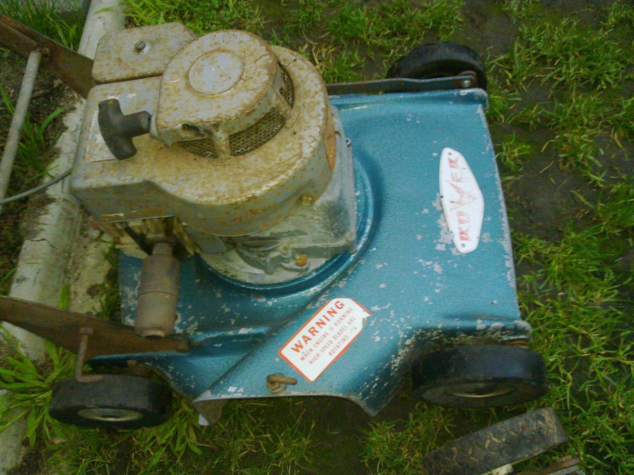

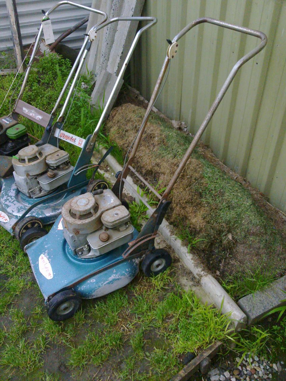

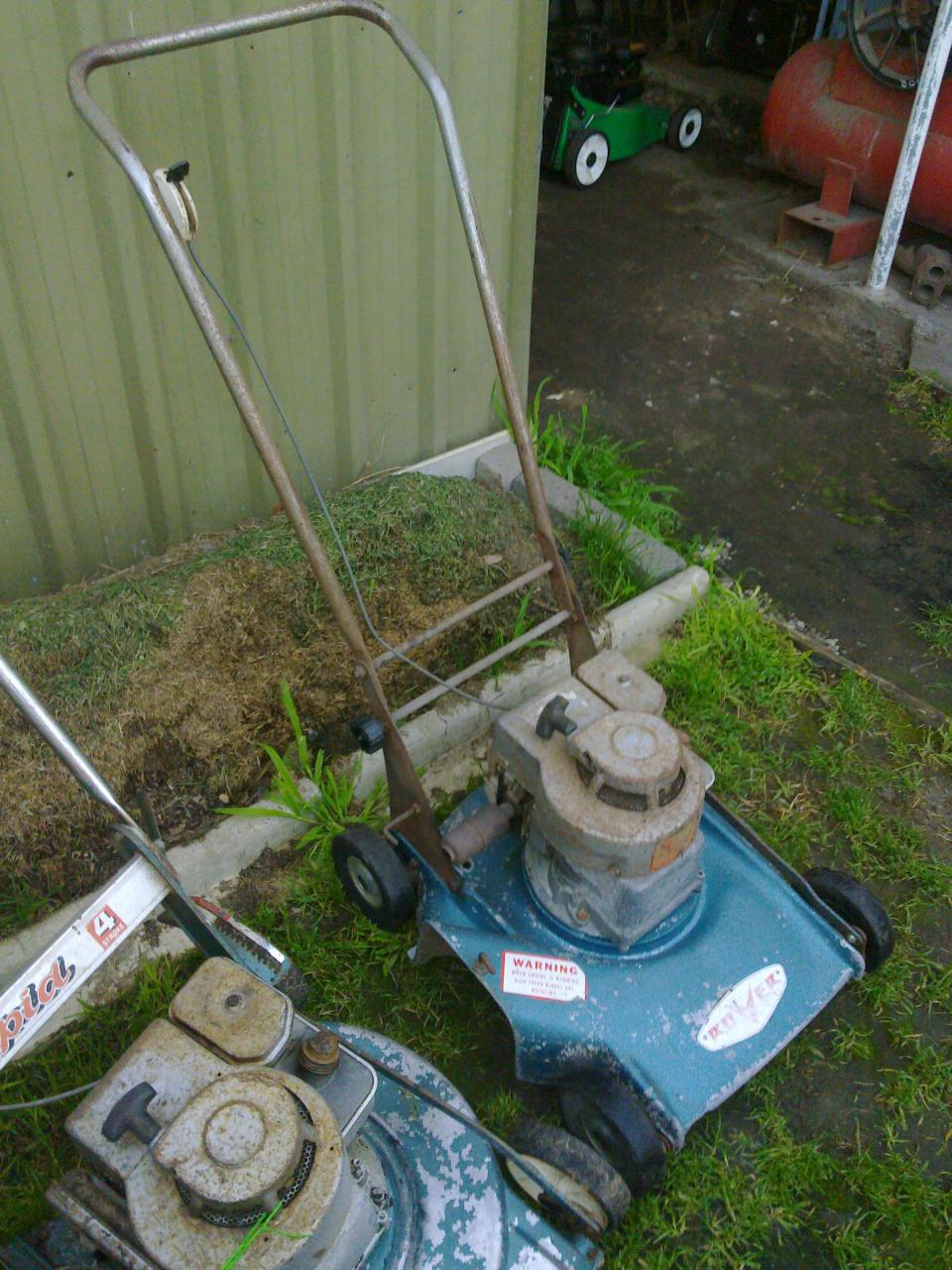

Another recent find is this old Rover with a Villiers on it.
I have another Villiers engine that came with it to pillage for parts (or possibly swap)
Also another base, depending on the condition of this one (the other base is in the last pic!)
I'll keep everyone posted on the restore, and get some photo's up soon of the spare engine!

the blue mower is a 1962 rover royal,i have one ,unfortunately the plastic handle badge is broken .
the rover diamond badge on the chassis has the production year on it
Thanks for that steve, I will have a closer look at the base, and see what is there!

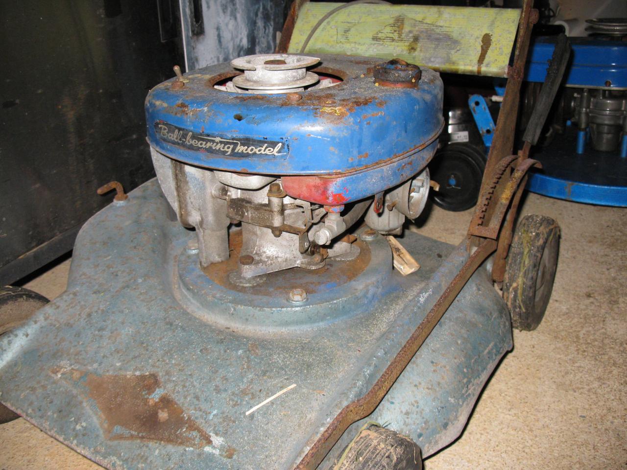

Here are some more pic's, including the second Villiers engine, and the spare muffler, sadly, the intake it snapped on the spare engine, however, that can be replaced!

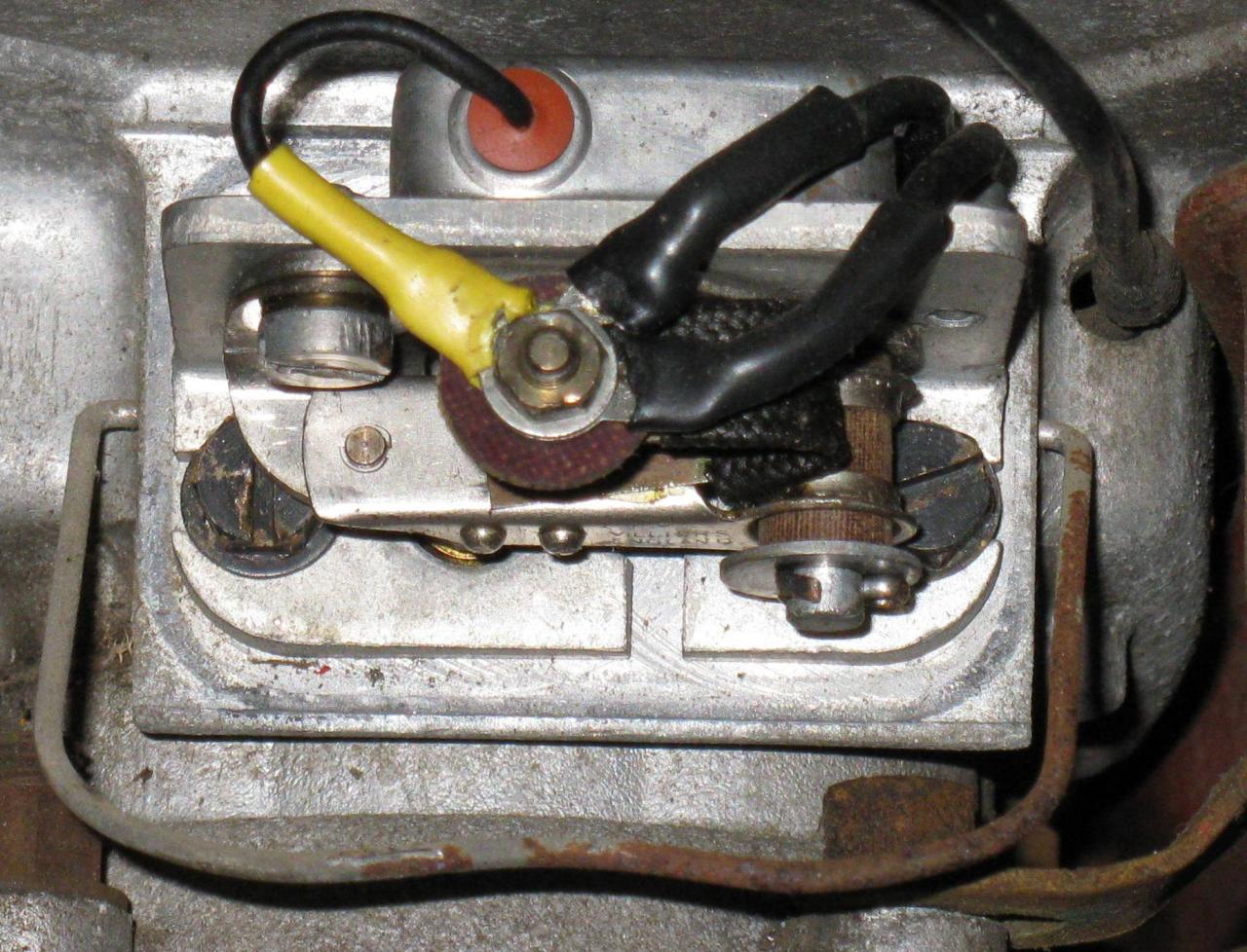

That electrical box (cover held by wire clip) appears to be a crankcase magneto. I haven't seen a Villiers like that, as far as I recall. From the layout it seems it may be a purpose-designed vertical crankshaft mower engine, which implies it would be no earlier than late 1950s. It will be interesting to see just what that engine is.
I'm sure you would have seen one of these before grumpy...It is a 4HP Villiers "Torque Master" 2 stroke without its brass fuel tap and glass bowl filter. My Dad had one of these engines on a "Pace" back in 1959.

Hi grumpy, I've done a bit more research on this engine...The "Torque-Master" is 98cc capacity and from what I have read is only 2 HP and known as the Villiers Model 7F engine. Here is a pic of the Pace, same as the old mans, with this engine fitted.

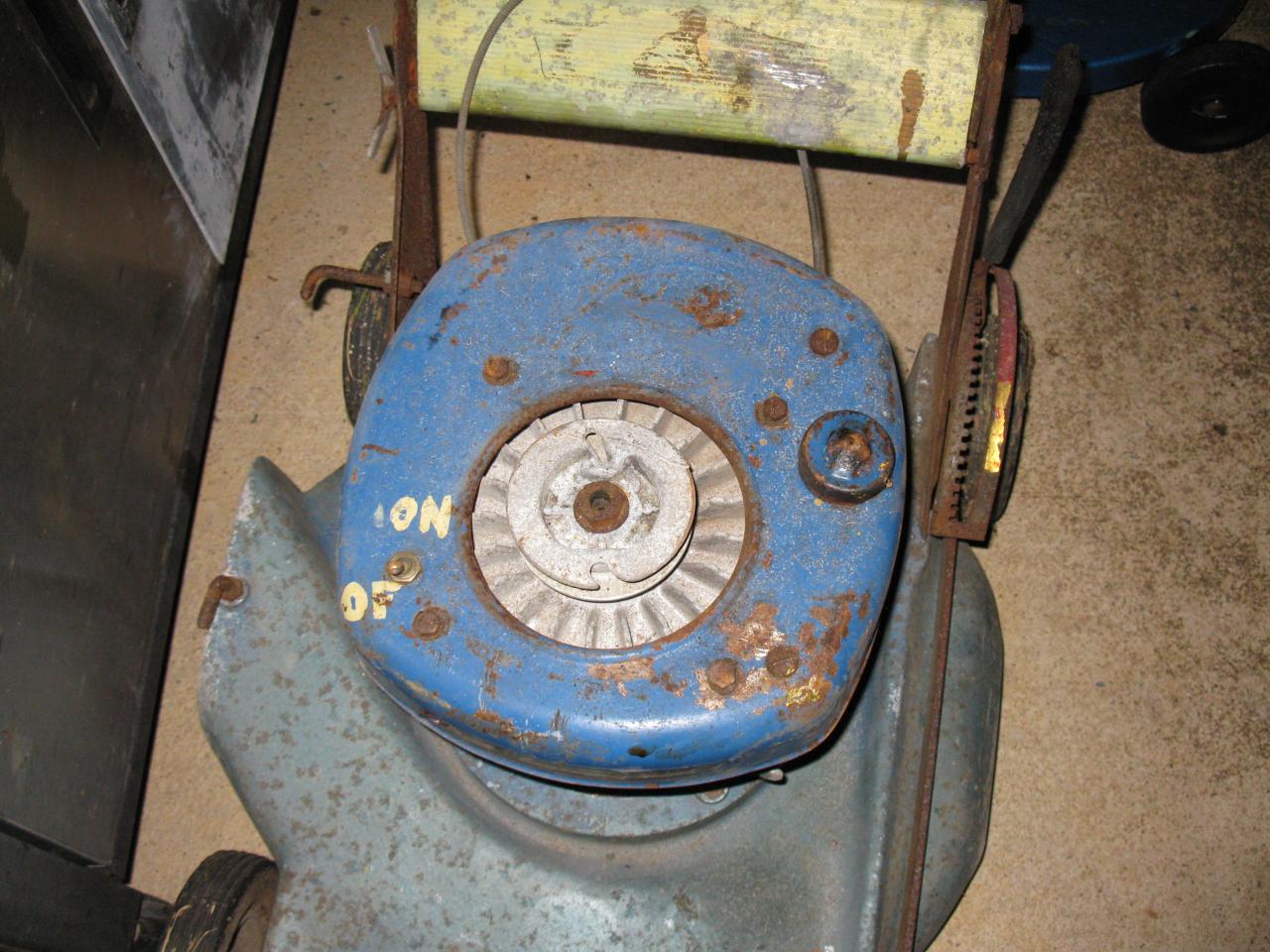

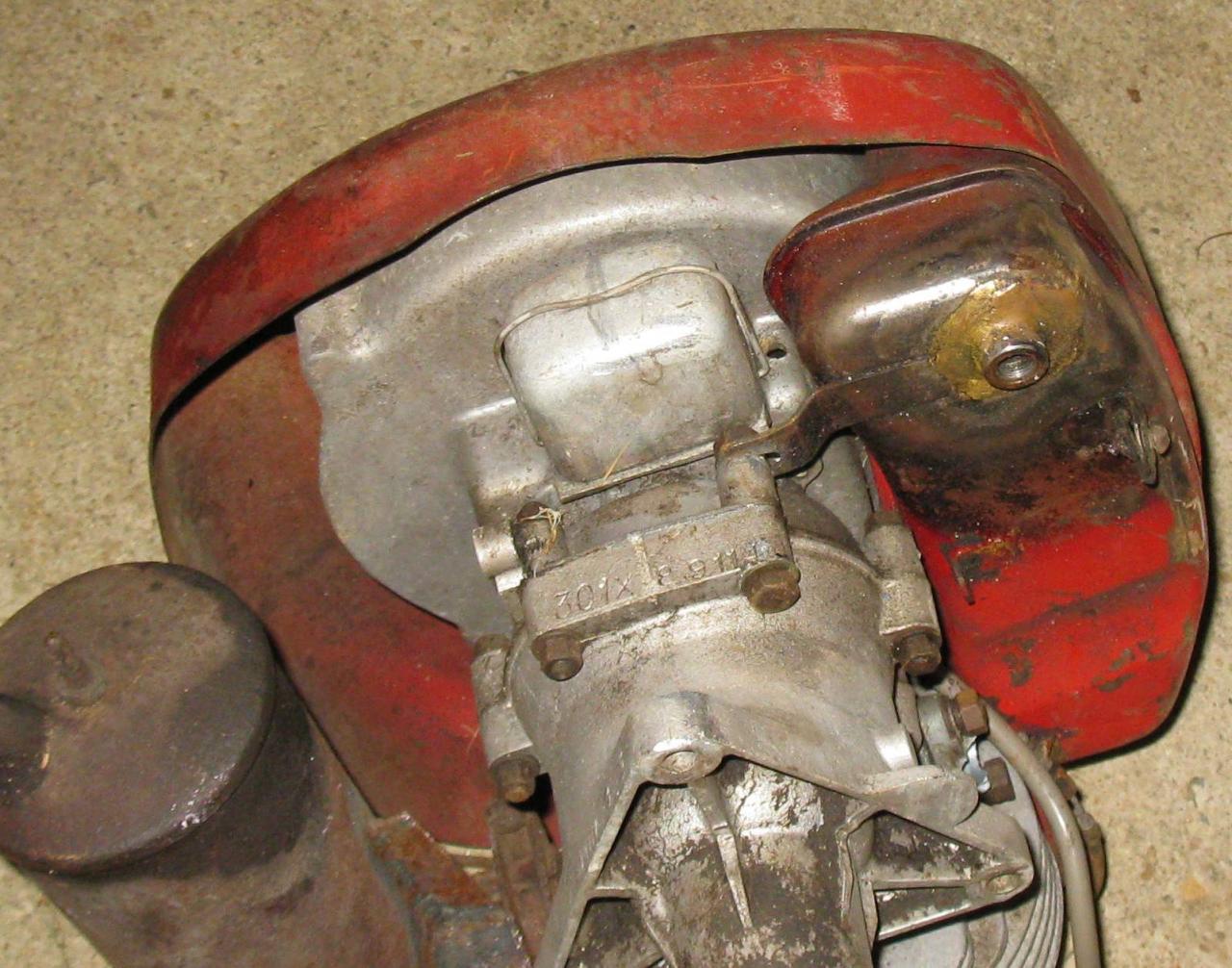

Here are the two serials, the first is the blue engine, the second is the red.
[IMAGE 1 CORRECTED IN REPLY FURTHER DOWN]
I don't know if these have any particular meaning.

Here is what i have heard back RE; my parts enquiery.
hello tysen, i am assuming the engine is the same one that is on the outdoorking forum. if so, then the rope
pulley on the blue engine is the correct one, as is the existing fuel tap. i think your mower engine is earlier than the one in deejays photo. if your engine had the recoil set-up then there would have been two extra holes in the cowling.all my books say that the early engines had the rope pull set-up. the on-off switch does not appear to be original as they usually had a switch on the side of the engine.the 7f engine had several different carbies with
different air filters.if you can get the carby model, stamped on the carby and let me know i might have the correct filter. it will have b12, b12/1 b12/2,b12/5,s12.hope this helps you.
regards john,
I will see if the red engine is any different, as it does not have the pulley, so maybe it was recoil.
And I will also get those carby numbers across to him, see there to go from there.
____________________________________________________________________________________________
UPDATE:
After sending him the serial numbers, I received this response
tysen, the first numbers are the spec number which gives you the parts fitted as
different manufacturers required different spec on their equipment,eg- 77x and 301x.the remaining numbers are the engine numbers.i dont have any specs on engine
77x, as my information starts at no. 100x. engine 301x should have the following
parts fitted. e135au, throttle control spring,c408au fuel tank,d380au fuel filter bowl
tap, d411au crankcase. so the lower half of the crankcase may be different than the
blue engine. regards john

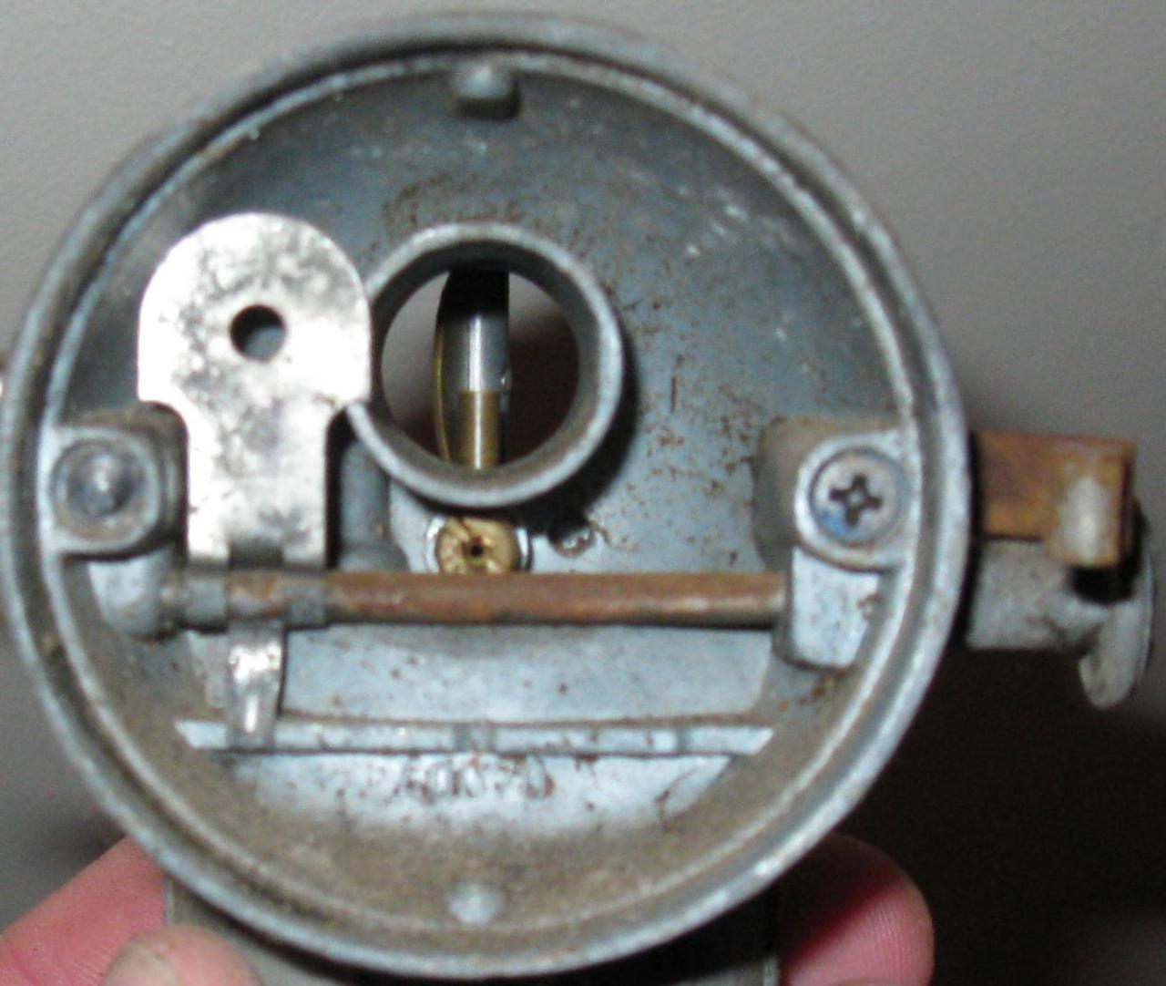

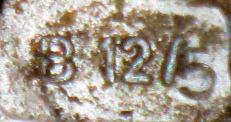

I pulled the carby off the blue one (Someone seems to have forgotten to tell villiers that the first two little piggy's died because they forgot to make their carburetors accessible!)
Its a B12/5

Here are a few more shots of the carby smile
The last photo is the numbers stamped under the choke assy. inside the intake flange.
And here is some more detail to that magneto Grumpy, It's quite a unique one!
The first three pictures are taken of from the Blue, while the rest come from the red (cowl was easier to get off)
While the cover is reminiscent (although smaller) of the Lawn Cub, the coil still sits under the flywheel, the box at the front holds the breakers and condenser. Although, as you can see, the magnet is not housed in the flywheel, but in its own separate wheel.
