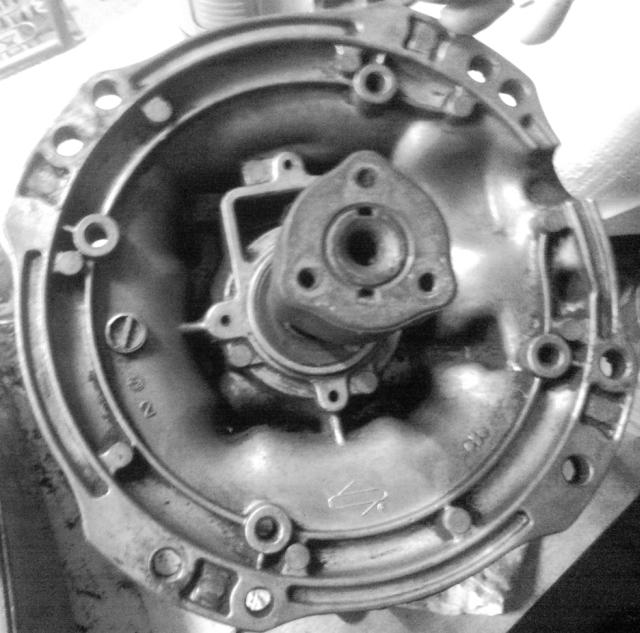

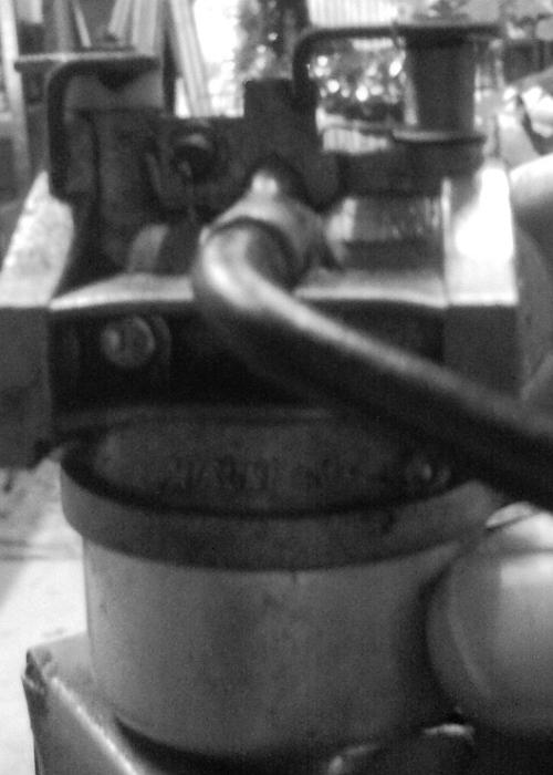

Ty, I can't see from those pictures whether it has a reed valve. I've listened to a couple of Utube videos of them, and they idle implausibly well for a port-controlled engine, so I wouldn't be surprised if they are reed valve. You can work it out from where the intake port is located. If it is very, very low on the cylinder, or directly into the crankcase, it will be reed valve.
We might see pictures that show where the intake port is located, or show the intake system dismantled, at some point.
Meanwhile I've read on the internet that the engine was simply a Komatsu that Briggs marketed for a while (1987-1991). It is unclear whether Briggs actually manufactured or assembled the Komatsu engine themselves for a while during that period. The Briggs code dates Ian's as August 1988.
In fact, that would be 23/08/88 would it not?
In which case that mower is 23 years old, in one week!
Looking at the model code,095722, would that follow the normal procedure?
If we exclude the leading zero (maybe used to ID a 2-stroke?) that would be 9ci, Base 5, Vertical Shaft, Float Carby, Mechenical Gov, Sleeve bearing, Recoil starter.
Yes, your code reading is correct Ty. The generation would be 6, not 5, because they started with zero, not 1 (e.g. the famous 60102 engine was first generation). The people who invented the Christian calender made the same mistake you just did, by the way: the inventors started with the year 1 instead of the year zero, so in fact the third millenium started in January 2001, not January 2000, and all of the parties were a year early. It was mildly amusing at the time. However they were apparently several years out with their estimated starting point for the calendar anyway, so I don't suppose another error of just one year was of much importance.
I think it probably was indeed 9 cubic inches, and I've read that it was 5 hp - Komatsu's idea of mild lawnmower tuning was perhaps a bit more aggressive than Briggs' would have been, but it idled very nicely and two-stroked smoothly under very slight acceleration, so I'd say it was a success. I don't know how it would compare with other Japanese two stroke mower engines such as the Suzuki. I suspect it would be a lot easier to get parts for the Suzuki.
The leading zero on the model number might have meant anything, I suppose. I didn't manage to figure out with certainty whether Briggs ever assembled the engine in the US. If they didn't, I don't see how they managed to have a full manufacturing date on the engine, since the whole date string would have had to be stamped in Japan and it wouldn't have reached the US until weeks or months later. On the other hand if Briggs had built it they'd have had the line/plant designators on the end of the date string, and they aren't there, which suggests it was assembled in Japan.
There is a quote from the current Stratton family member on Wikipedia, saying that the venture with Komatsu was not a success because the strength of the Japanese currency (Yen) made the engine unaffordable in the US. Their 10-year agreement only ran for 4 years.
Posts: 10
Soap Dodger
if a hammer doesn't fix it, the problem must be electrical
Ian, the KDC on the base of the cylinder may mean Komatsu Dresser Company, which was a joint venture between Komatsu and Dresser, intended to supply very large mining haulers. If so, I don't have any idea why it would be on this product.
I take it the rectangular port is the intake. It is not especially low on the cylinder, and has a definite cut-off on the lower side, so it looks like a piston-controlled port to me. Does it have a reed valve in between the carburetor and that port? If not - that is, if you can see straight through from the air intake side of the carburetor to the cylinder when the throttle and port both open - it is a port controlled, crankcase induction 2 stroke like a Victa, Villiers, etc. (it just runs better than they do).
It appears B&S only stopped using the engine because the strong Yen made it too expensive - I haven't seen any suggestion that they were unhappy with the engine itself.
Briggs and Komatsu got together on this engine. Theres a whole story about it on Wikipedia.
I would say that these engines were made in a KDC factory.
