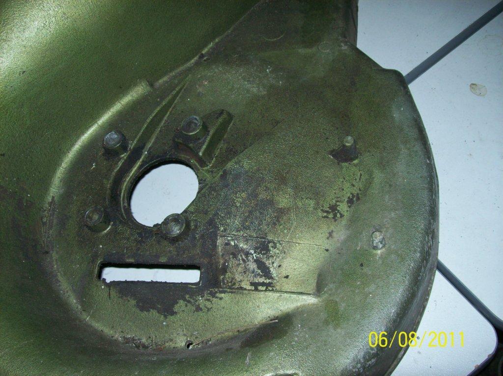

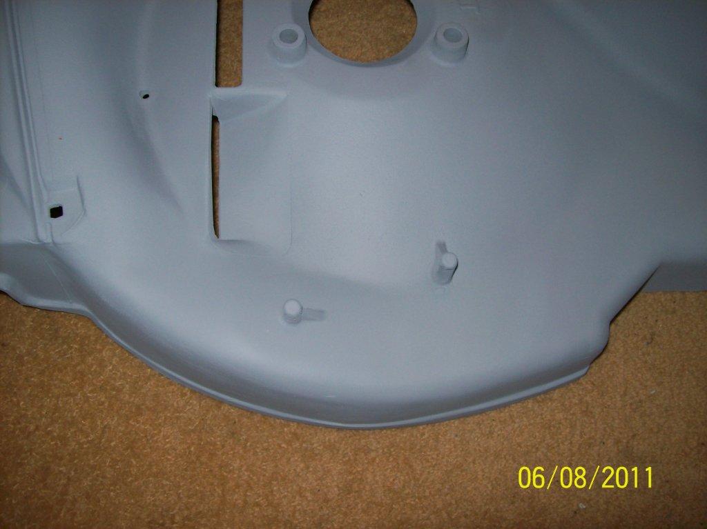

Ty I thinking I may have found a different's between Mark I,II and III base's.On the Mark I & 2 where the height adjuster spring attaches to the base.There is just the one pin coming off the base.On the Mark III there is that one pin as well as a guide pin as well.Here let me show you.
As you can see here they have only the one upright pin for the spring.The very dirty one is my original Mark I.The one with the crack on the side.The other one was my first VC the Mark II.
Now these ones have the two pins.Now the one that is still semi green you will remember that is the Mark III that I picked up last weekend.The grey is the one that I got from you.So can you remember if it was a Mark III.I'm thinking from my investigation it was.
Ok, The two bases that you have already started are the MKI & MKII Bases.
The base that does not have the Guide post is the MKI Base i gave you, The one with the post, and the I cast near the engine mounts is the MKII you first started with (right back at the begining!)
The new base, from the coast is a MKIIIB base, it was cast in the same mold as the first series of VC-160 Auto Drive, But does not have the cut out for the belt to pass through, however it does have the spacing for the belt to run around the pulley, and other casting marks for the Auto.
There is another type of base, the normal MKIII, or MKIIIA, it has the same engine mount area (no belt space) as the first two, but is a MKIII base. I have one here for you.
The MKIIIA also had a slightly different cowl to the MKIIIB, the MKIIIB has a smoother lip around the hole for the starter, While the MKIIIA cowl, is the same as a standard MKII Cowl, wich still shows casting indentations for the starter cover used on the MKI
I'm not sure I completely followed you there.I think I got confused.The base with the guide post is the one I got of you.It also had the letter I between the engine mount bolt holes at the back of the base.I'm sure I posted pictures of them in the other VC topic.The one that is now closed.Also when I looked in my photos of the Mark I & II when I first got them I can clearly see no guide post.That's what I trying to work out.From what I can see here that one does appear to be a Mark III base.As the other one I have here is almost the same.There are also some little different's under the base.It looks to be more about strengthening the exhaust hole.My problem is I can't really use a Mark III base to do a Mark I or II.It wouldn't be right.So that's what I'm trying to find out if it is a Mark III.If it is I may have to cut the post off so at least it would be visually right.
The one with the I and the post is a MKII, it is a later MKII, cast in the later half of the MKII run.
The one with one post is the MKI i gave you to replace the cracked MKI one you already had.
The MKIII you have is actually an MKIIIB, as it has the belt runner for the Auto Drive.
The later MKII's and all MKIII's had the guide post.
