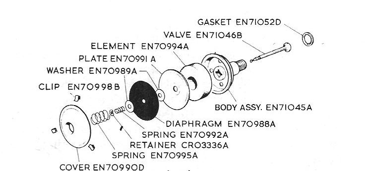

Heres a diagram, there are some minor changes in later models, but its a good representation!
Of course you wont be able to pull it apart like that if its a sealed one.
New one is about $28 or so.
Or you could just whack an old plug in the hole and plug the vacuum line.
Not to mention, if its a sealed one, there is no retaining clip, the end of the poppet is simply machined down to lock it in, so you cant even get by with the plug out at the end.

thanks guys mine is the sealed one im going to plug it up and make sure this thing is going to run i havent had time to do anything with it for a few weeks now....
