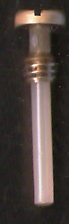

Thats a good point Joe, I compleatly forgot about that, and its likely that Goliath has the wrong jet (Considering the LM was well after the Twin.
The corect jet for a 170cc Victa Twin is Part No. CRO03459A
This is a G4 Jet & Tube Assembly, and is identified by the chamfer on the edge of the screw head.
I beleive the 125cc Jet has a ring cut into the face of the screw head, and the 85cc has either a ring on the outer edge, or a ring on the face and a chamfered edge.
Also, the lower spring (the small one) is different, for the 170cc its identified as 1.06" long, and has 5 1/2 Turns.
I will see if i can find any of these parts floating around.
The 85cc lower spring is 9/16" and does 2 turns.

The Jets we have been discussing are the screws that hold the plate on, i put pics of them on one of the other pages. For your mower, it should have a G4 carby, Not an LM, as the Main Jet (the big brass screw) for the 170cc engine, was only ever made for the G4 Carby. Here is a picture of a G4 Jet ![[Linked Image]](https://www.outdoorking-forum.com.au/forum/uploads/usergals/2011/06/full-5013-1600-full_5013_1527_g4.png) and here is a diagram of the 170cc screw head (side on) and the normal one. ![[Linked Image]](https://www.outdoorking-forum.com.au/forum/uploads/usergals/2011/06/full-5013-1601-screwhead.png) You want the first one, with the chamfer. Looking at the pictures of goliath you have posted, the new carby you have on there has a 160cc jet, however the one it came with has the corect jet, looking at the pictures on page to, with the jet and float on top of the mower. As for the needle, i beleive either is fine.

No, you need the G4 body, because you need the 170cc jet, witch will only fit a G4 body.

Also, i just checked and i have a G4 for you, you will just need Goliath's jet and spring.
And in a stroke of luck, i noticed that one of the G4's i pulled of a VC-160 (Not supposed to be there in the first place) had the chamfer on the jet, so i whipped it out and measured it, and yep, 170cc jet!
