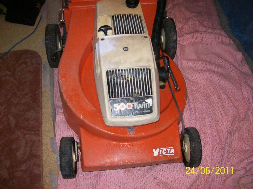

Hi all just thought I'd share the excitement.As my Victa 500 Twin Cylinder was picked up by the courier today.Looking forward to it's arrival.It's a funny thing I wasn't sure if I wanted one, now it's on it way I'm all excited.Will post up pictures when it arrives.Do have some pictures now but there not great pictures. If you'd like to see them I could put them up.

Nice one Blumbly!! Yes put a piccy up that would be great. Where did you score the twin and what courier are you using to transport it?

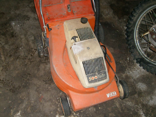

It was on eBay but it didn't sell for the price he wanted for it.Not saying it wasn't worth it.I mean from the condition I seen it would have been worth $300.I just wanted to get this a little cheaper.The seller was happy and so was I. ![[Linked Image]](https://www.outdoorking-forum.com.au/forum/uploads/usergals/2011/06/full-5048-1473-1.jpg) ![[Linked Image]](https://www.outdoorking-forum.com.au/forum/uploads/usergals/2011/06/full-5048-1474-2.jpg) ![[Linked Image]](https://www.outdoorking-forum.com.au/forum/uploads/usergals/2011/06/full-5048-1475-3.jpg) These are the pictures I have,but when she gets here I'll give her a good scrub and see how she looks then.Then I take some pictures and post them up.It' coming from a place called Gunnedah.Which is about 80km's from Tamworth.It's being transported by a courier mob called e-go.Don't know if that's a good or bad thing.I have had dramas with them in the past.I think there part of Hunters express.Don't worry it is insured.I paid $200 for it I guess if she gets here in the two pieces it left in I will be happy.Like I said before wasn't sure if I wanted one,but now I have one on the way I'm quite excited.
Posts: 2,738 Likes: 6
Looks like quite a nice one too!

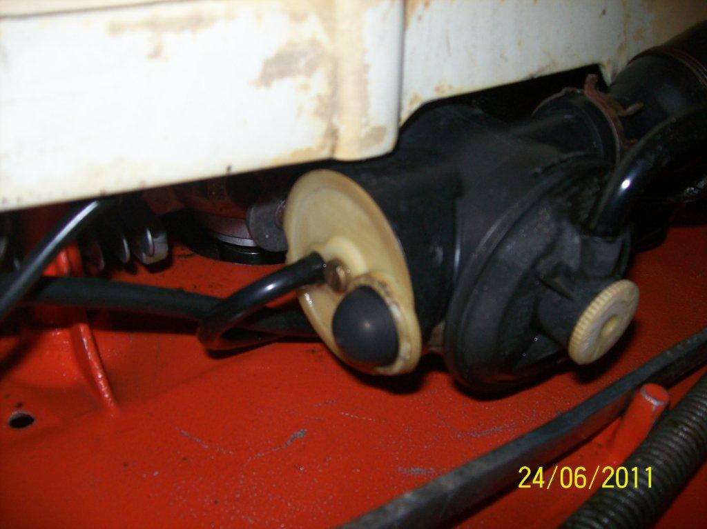

So what are the different's between these carby's? I'm only new to these carby's more use to playing around with older ones.Like on the victa 18's

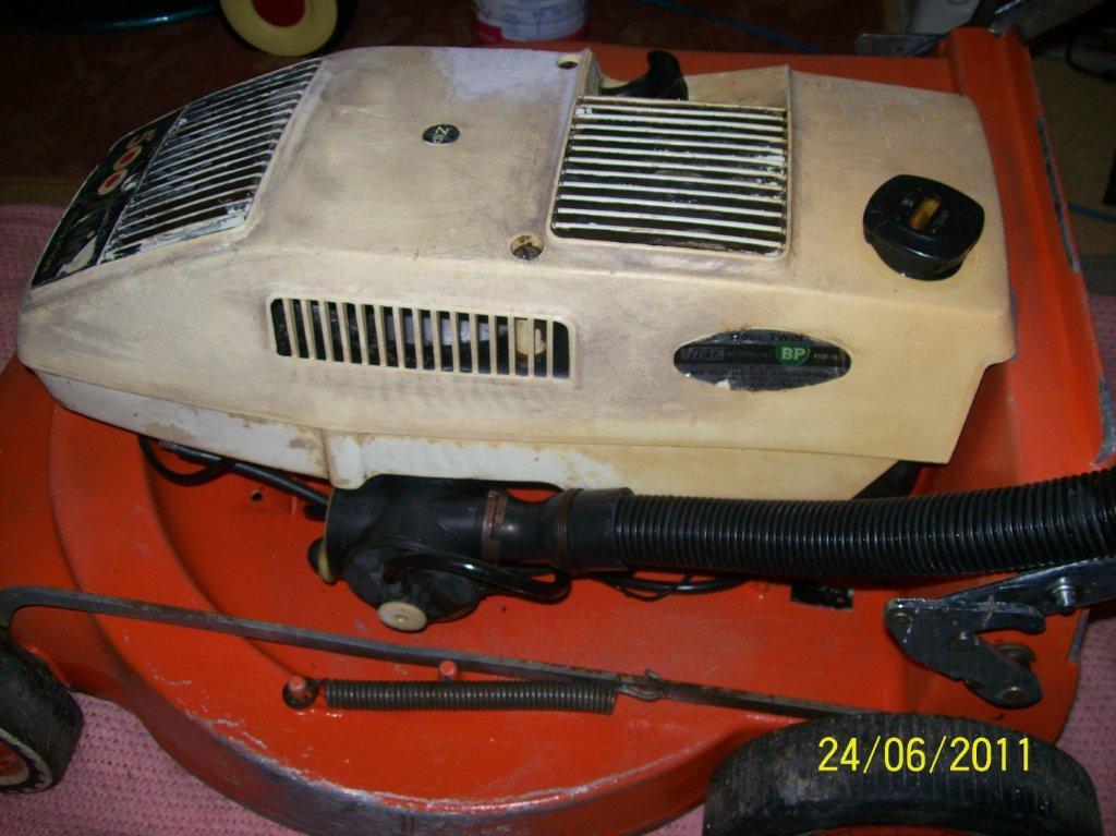

Awesome my twin arrived today.Haven't taken any pictures after the first scrub down.I will do shortly and put them up.[Censored] they are big,sat it next to a victa 18 when I got it out of the box.It dwarfed the poor 18.Certainly will need a clean.Does any body know what the best cleaning product would be to use to clean the cowl?

The filter box itself is standard to that era, right into the early 90's i think, when they put the 'stages' along the control run, the difference is the end cap, the 500 twin originally had the pointy cap on the end, i will put up a pic when i find one. EDIT: Here we go, I forgot i took this one, its the correct sticker. ![[Linked Image]](https://www.outdoorking-forum.com.au/forum/uploads/usergals/2011/06/full-5013-1526-img_0454.jpg)

Bugger my doesn't have that at all.I don't suppose you have a similar one you don't need that I can use? As I guess let's face it, it would be very very hard (if not impossible)to find one now.
