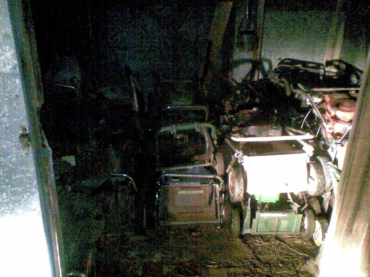

Up until now I have kept myself tied to the Victa 2-stroke engine, however I am starting to take interest in expanding my hobby, I will soon be taking delivery of two (at least) mowers with Briggs 4-strokes, as a general guide (I will be able to be more specific once I have the engine numbers handy) what are relatively common things to consider when choosing a viable project with these engines, and what might be some common faults.
At this point I know; mower one has a white brigs engine, with the old 'Straight up' pull starter, and the spinning metal vent on top, it is on a brown Jupiter Jester base. Mower 2 has a red brigs engine of the same description I believe, but I have not had as good a look at this one.
Again, once I have them I will be able to be more specific, at this point I am just wondering what I may be up for with these two (freebies) and what might be good things to know when choosing them, before I spend any money on a brigs that is not worth the trouble.

Ok after doing the same, fixing 2 strokes, then moving on to 4 strokes due to demand from the uneducated ive got a few tips i can pass on.
First up, grumpys trick for starting them. Invaluable. You wont see me publish it but its a bit of info i pass on to anyone who buys one off me.

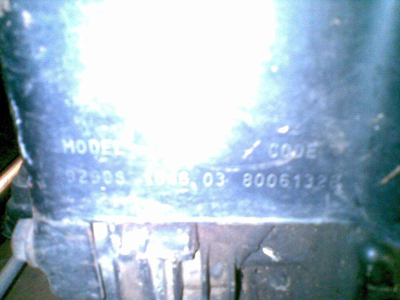

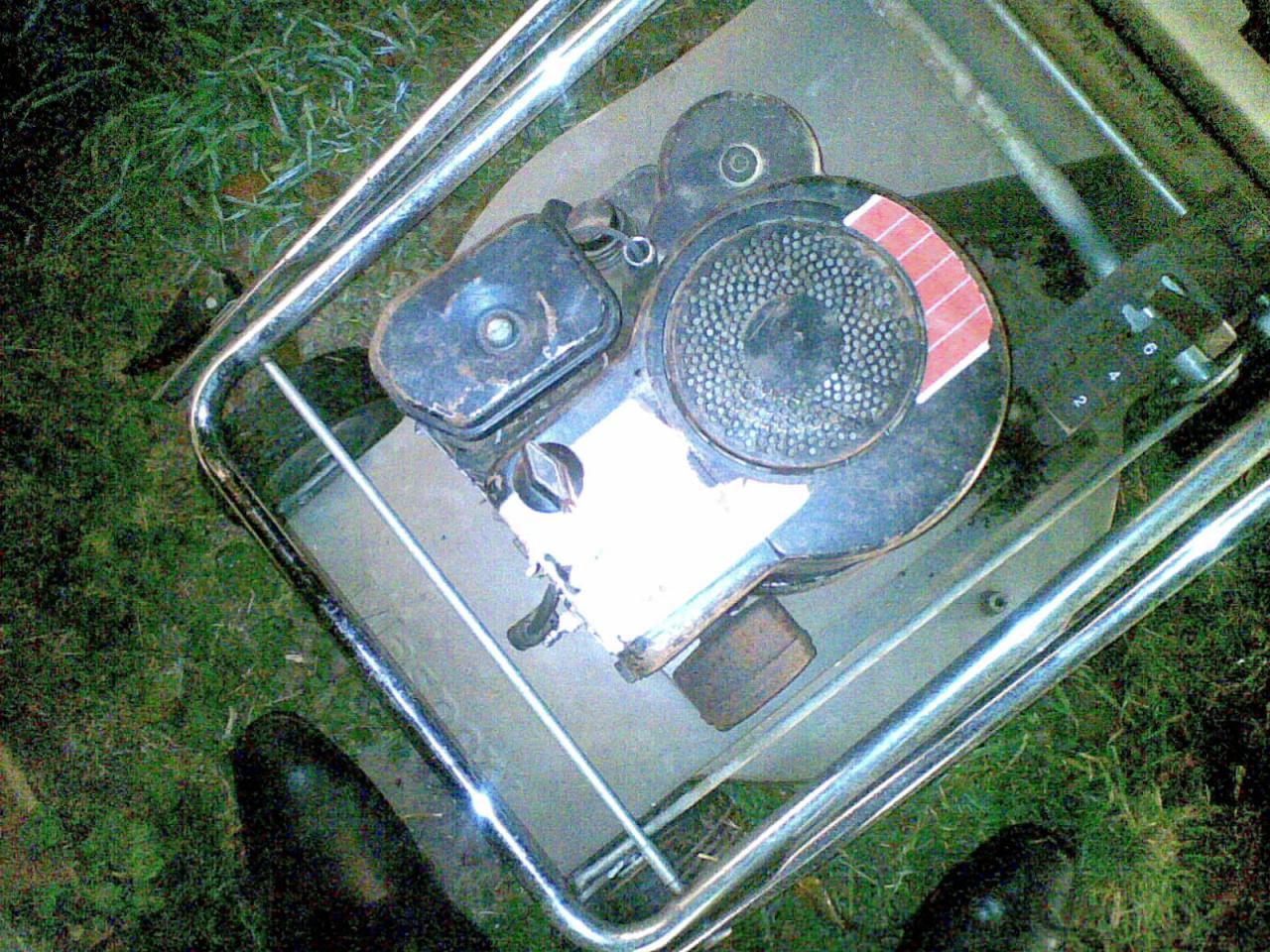

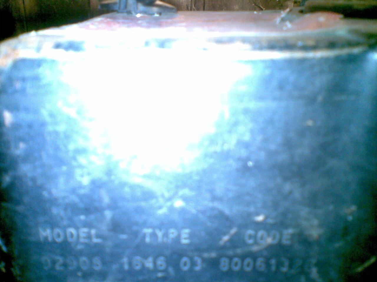

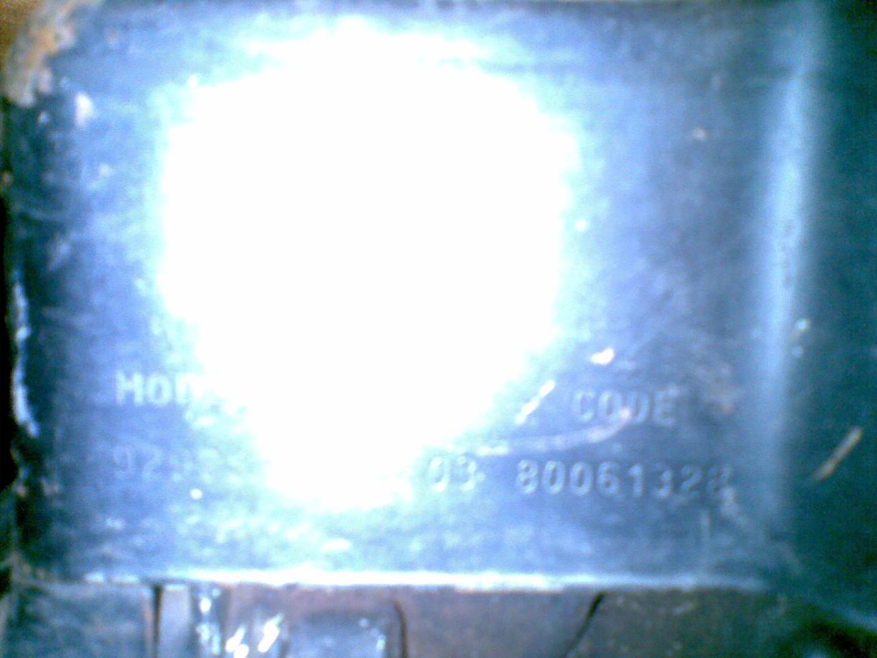

Well i just remembered i took a couple of photos from the Masport (i forgot i had done this, it was very late when these ones arrived), there not great, but i make the number out to be:
92905-1646 03-80061328
the thing that really got me was the throttle control is a knob ontop of the blower cover.
Heres the pics i have (there not great)
A 92905 is a 9 cubic inch (148 cc), third generation design, with a vertical Pulsa-Jet carburetor and plain main bearings: all is well so far, it is one of my favourite engines with my favourite vacuum-type carburetor. However the final 5 means it has a 12 Volt electric starter only, no recoil starter. With the vertical pull starter shown in your photo it would be a 92908. With its manufacture date of 13 June 1980, it will have breaker points inside the flywheel. It should have the automatic choke, which makes it the easiest to use and sweetest running of the small Briggs engines in my opinion. Personally I prefer a snorkel air cleaner, but the foam type you have is more common.
I had the identical engine on an identical mower, I still have the engine but it looks nothing like that, the cowlings, starter, ignition were all trash so I installed everything from a 2005 model briggs. Only thing I dont like is there is no dip stick.
I have a 1982 one and it has a dipstick, Joe, so that may be about when they made the change (much the same time as when they switched to Magnetron ignition). My 1982 one happens to be a 92508 though (Vacu-Jet carburetor instead of Pulsa-Jet), and by 1982 they had reduced the maximum governed speed of the vertical crankshaft engines to 3,000 rpm from 3,500.

When i went an had a look at it today, yep, 92908, It needs oil i beleve, and if i can get this one going its on the keep list, how do i make sure the oil level is right?
