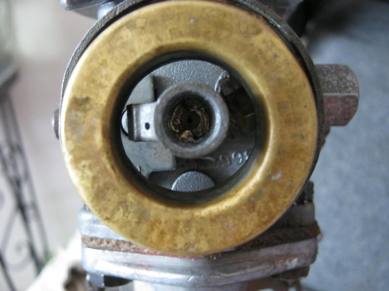

Hi,
Does anyone have a carb that will fit this mower as the previous owner has striped out the internal thread for the bowl nut and main jet so now the bowl bolt wont catch
carb is a Walbro 50 but Kirby Lauson made there engine under license from Tecumseh so maybe a Tecumseh carb will work.
I have hunted high and low emailed every man and his dog in USA but no joy.
So i was hoping that since its an Ozzy make engine maybe someone in this forum can tell me where i could buy one from in oz
thanks
Pete

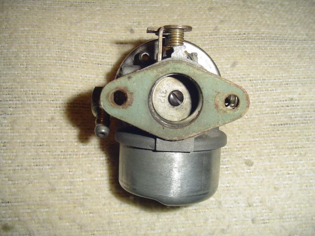

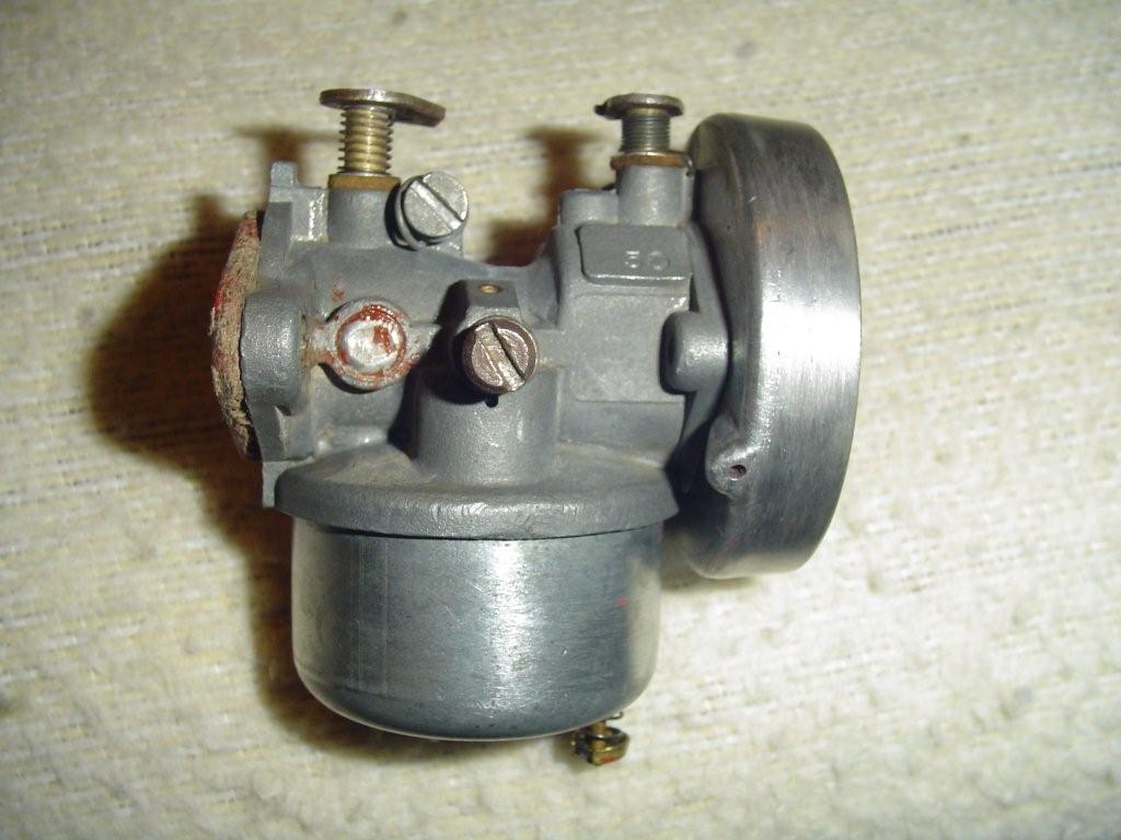

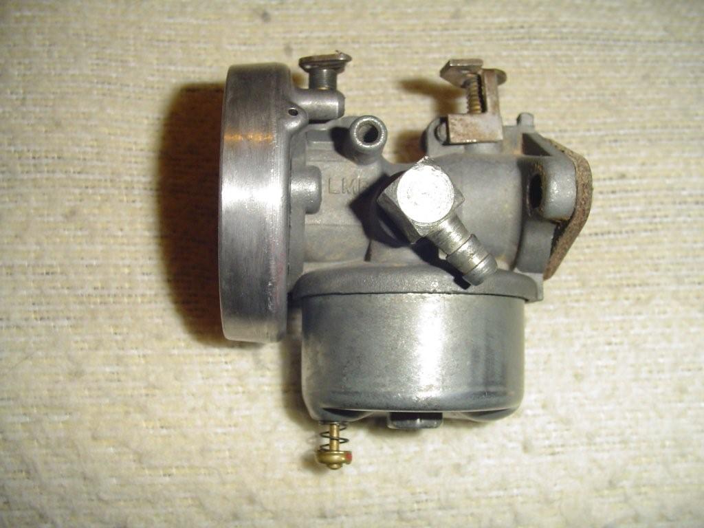

Can you post a picture of the carburetor, complete with air cleaner, Pete? Someone may have an old mower laying under four feet of pig manure in the back of the house-paddock, and not recognise the description, but that air cleaner is very distinctive - and I think the carburetor is the same for both horizontal and vertical crankshaft versions of the engine, if it's the one I'm thinking of.
Joined: Nov 2010
Posts: 106
Good one Grumpy four feet of pig manure jeez i hope they clean it first lol. [Linked Image]
Nice pictures as usual, Pete. That looks as if it is the standard carburetor used on all of the old Kirby-Lauson and Tecumseh engines fitted to so many mowers here in the late 1960s and 1970s. So, does anyone have a defunct Kirby-Lauson, or a carburetor for one, that they aren't planning to use again?
I will keep an eye out among my junk i have one on a whole motor i dont want to separate with but may have one at dads place in a box.
i reckon a prime carb from a recent tecumseh would be a close fit if all else fails.

Hi Bob,
The bowl bolt doesn't have a jet. right beside where the bowl bolt goes in is a tiny inlet jet which exits just above the main jet which is underneath the bowl bolt.(see on the left of the bolt shaft in pic attached)
I'll have a look at those TVS90 you mentioned.
If i can score a body of a carb same as mine then i might be able to swap over the linkages.
Thanks for the advice Bob
Pete[Linked Image]
