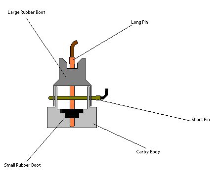

Now, take the small pin, and feed it through the smaller holes in the side of the larger boot, and the cut-out port, this will hold the boot in place, and run 90-degrees offset to the first contact. This pin should be fed from the bayonet side of the carburettor, to the end-cap/diaphragm end of the carburettor, at a diagonal. (In the below image, the boxes in the background represent the carburettor, the smaller one is the end-cap, and the black dot in the middle is the longer contact)

I noticed the diagram i have above for the top view of the complete assemly has the cros-contact a little off angle (Is not actialy 90 degrees to end cap)
could not find a clear enought photo handy, but here, hopefully this will complete the pictire, what you should see when done.
