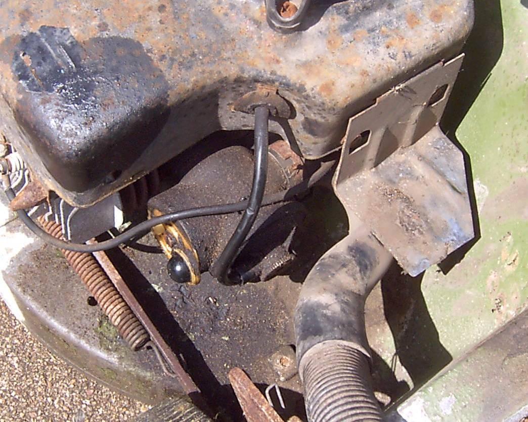

Hi to everyone ,i have a old mustang victa,im in need of how to adjust the throttle ,it runs almost full throttle ,have got manuals from library and can not figure out how to adjust throttle speed is it a L4 plastic carby?i have been on you tube but can not seem to find anything have aattached 2 photos of mower ,any ideas What carby is it from photo please[Linked Image]

the big kink in the snorkel wont be helping matters. originally this would have had a primerless cap and had the carby mounted the other way around with the snorkel facing out to the left side.
you could try moving the throttle lever to the other side of the handle bar and cut a new hole in the cowling for the snorkel to run through.
if it turns out the cable is damaged one from a newer victa should fit.
