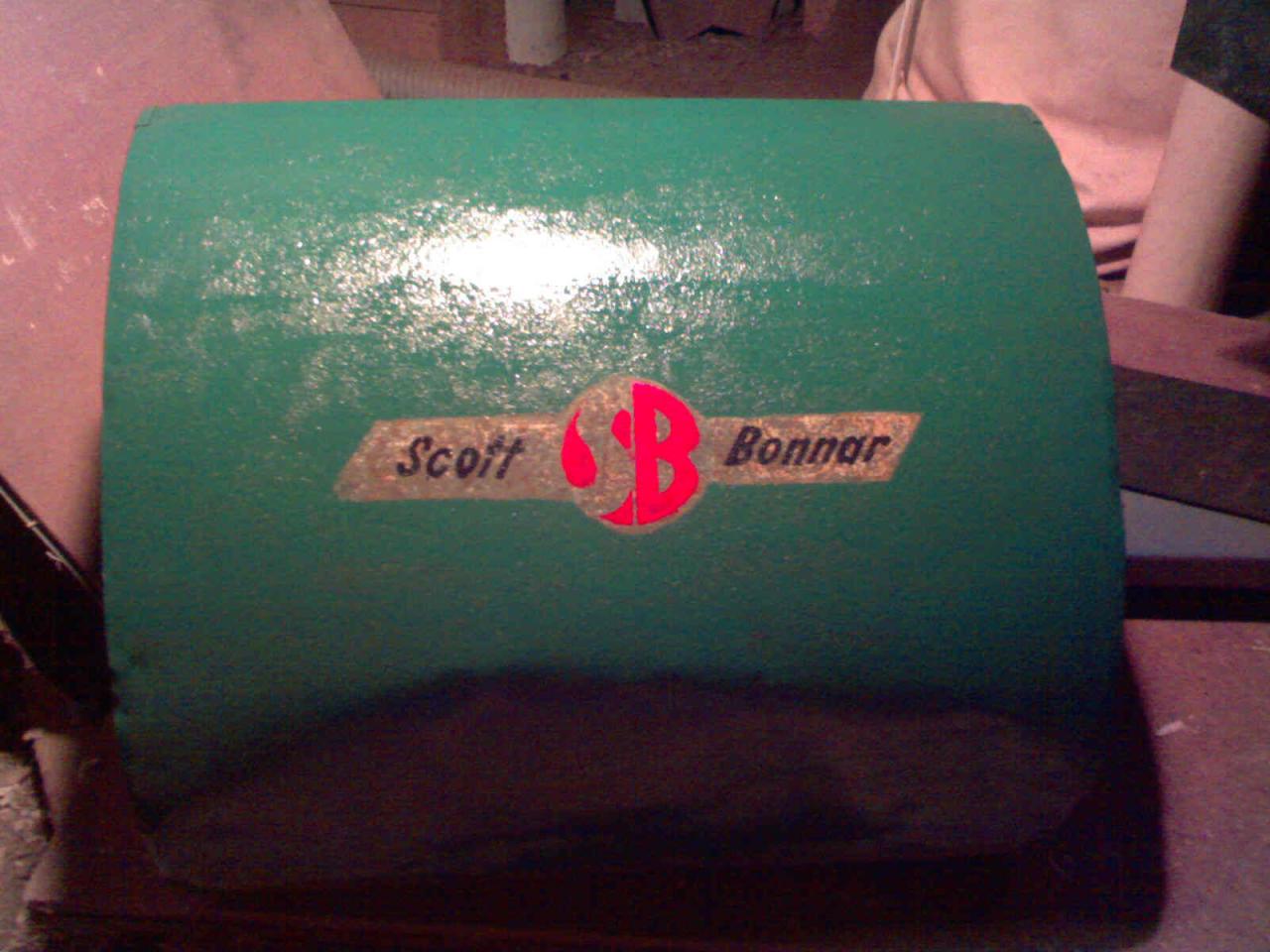

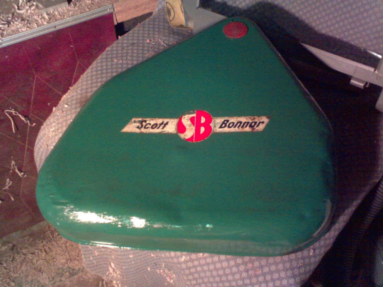

Here's a couple of progress photos from redoing the paint job/decals: So far just started on the chain case cover and the catcher. I've done the black Scott Bonnar writing, and the red bits in the SB logo thing on both. (Needs a bit of fixing up on the catcher which I'll do when I do the white, had to pretty much guess where everything used to be on that). Also applied a first coat of green paint. Probably could use some panelbeating too but I'm not too concerned about that at this stage. ![[Linked Image]](https://www.outdoorking-forum.com.au/forum/uploads/usergals/2011/04/full-4829-875-sb_33_chain_case_cover_1.jpg) ![[Linked Image]](https://www.outdoorking-forum.com.au/forum/uploads/usergals/2011/04/full-4829-876-sb_33_catcher.jpg)
Posts: 6,362 Likes: 11
Good work there Kelsey, It will look great when you finish, It will also give you many hours of mowing pleasure.

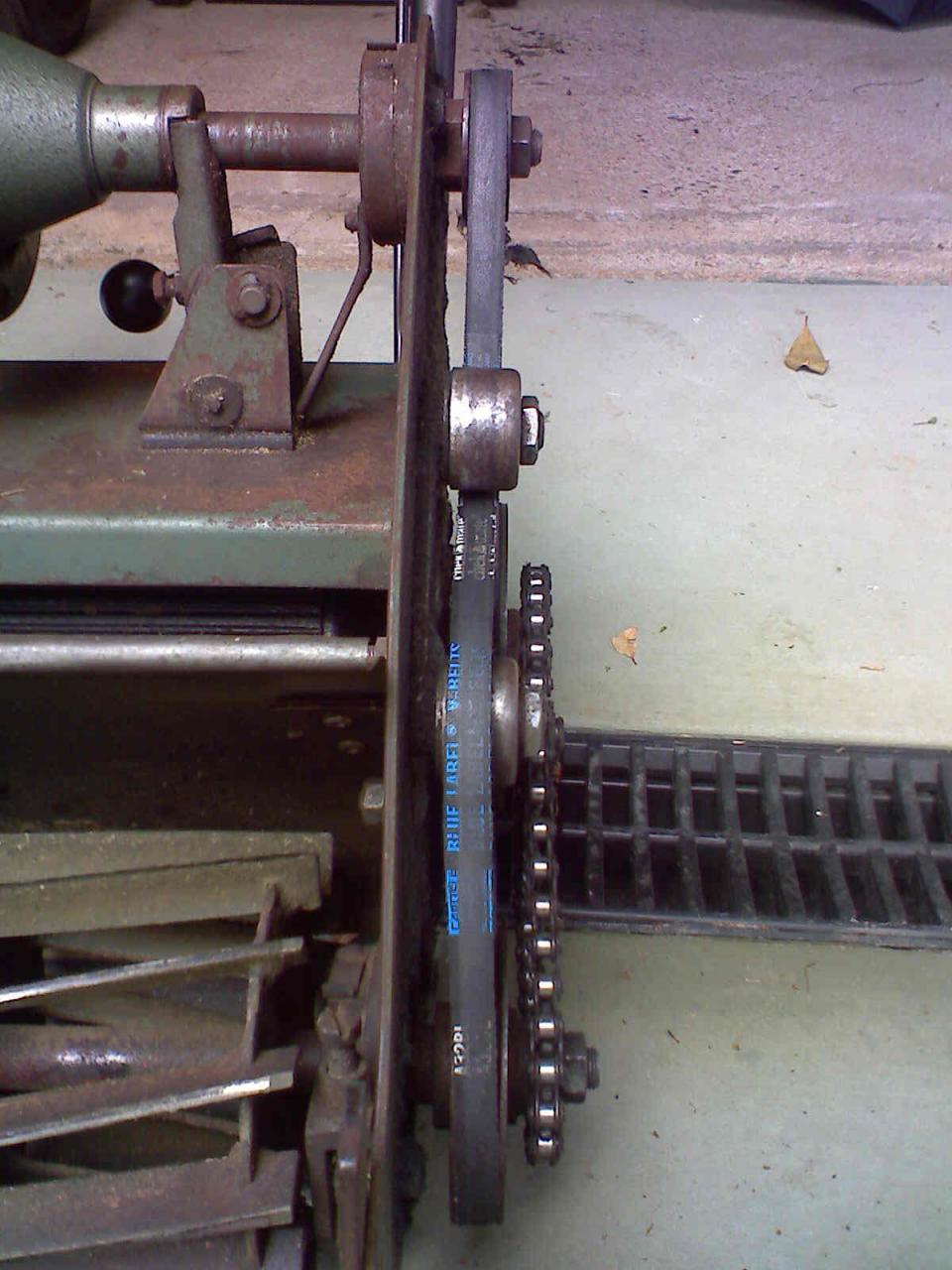

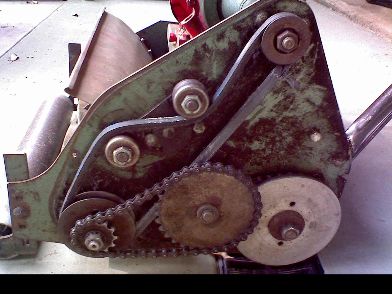

I've got a couple of pictures.. hope they help. ![[Linked Image]](https://www.outdoorking-forum.com.au/forum/uploads/usergals/2011/04/full-4829-897-sb_33_pulleys.jpg) As you can see on the second one, the belt/pulleys and chain are out of whack a bit. Also, the shiny part on that cylinder blade stops before the end of it, I noticed that the cylinder doesn't line up flush with the edges of the bedknife, so I'm just gonna take it all apart and get it all lined up properly.
Posts: 6,926 Likes: 11

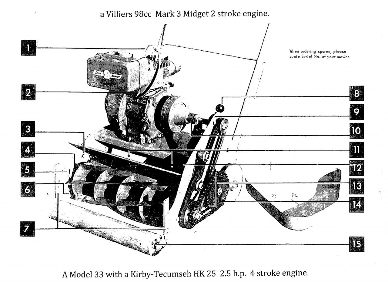

It does look as if the belt pulleys have been incorrectly assembled. The illustrated parts list shows two different configurations for the model 33: 330026, which was chain drive; and 330413, which was belt drive. Yours is obviously 330413 since it is belt drive. I am doubtful that the large hex nut on the inboard side of the top (engine shaft) pulley belongs there. Also, there are parts on the inboard side of the cutter pulley that don't seem to belong either. It looks as if someone may have deliberately spaced the two pulleys outward for some reason, but the two idlers may not be cooperating with this. I suggest you look carefully at the illustrated parts list and assemble your mower exactly in conformity with it.

Thanks Grumpy, I have had a look at the drawing, and it appears that hex nut on the engine shaft pulley is there, but on the cutter pulley there's nothing on the inside, so perhaps that could be the problem. Time for some investigation on the actual machine I think.
Kelsey, my reading of the chassis illustration for model 330413 is that there is no component inboard of the engine shaft pulley until you get to the other side of the mower's sideplate - the next component is No. 37, the Engine Shaft Washer. The point is that on the illustration it is on the inboard side of the side-plate, not the outboard side. On your mower it is on the outboard side, with a large nut that I haven't found on the illustration so far.
Hi Kelsey and grumpy, Have a look at the cutter clutch (engine shaft) pulley illustration (increasing magnification).. Component number 147 and I think you'll find that the large "hex nut" is, in fact, an integral fact part of the pulley. It is there to assist in pulley removal...you can get a spanner on the 2 long flats to hold it whilst undoing the nut. It well may be the same for the cylinder reel pulley... Kelsey, are there 2 long flats on the lower pulley? IMO, I think the probs may well lie in the cylinder reel bearings being shot....possibly the engine shaft bearing may need replacing as well. This would account for the uneven wear on the reel and not lining up on the bed-knife. This would make adjustment of the reel to bed-knife clearances impossible.
So the pulley is keyed to the shaft, and has two flats on its inboard side so you can hold it with a spanner while you undo the retaining nut on its outboard side. That means the pulley is drawn onto the shaft as far as possible, until it hits a shoulder on its inboard side. Since the inboard end of the pulley is just about up against the shaft bearing (attached to the side plate) the lateral position of the top pulley has to be right. And the two idler pulleys seem to line up with the top pulley, they just don't line up with the bottom pulley. And the problem with the bottom pulley's location may be that the reel's axle shaft is out of position: too far toward the pulley side of the mower. I don't know what is causing that, but it probably needs to be lifted out and its components and their sequence compared with the illustration. I can't tell if Component 148, Cutter Pulley, has something inappropriate on its inboard side or not - from the illustration I don't think there should be anything between it and the inner ring of the reel bearing.
