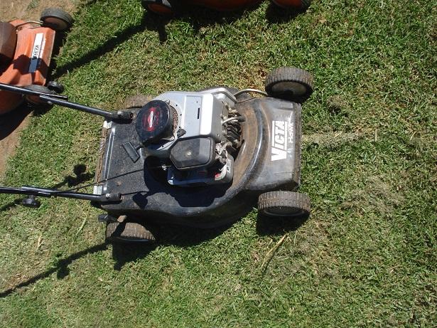

Got this morning from a garage sale a almost new 06 manufactured victa hawk mower for $20, nothing was wrong with it apart from the old owners had kinked the throttle cable and forced the lever to move causing the lever to move but not move the cable.
Anyhow got it running sweet, and mowed my back yard with it, I had just moved some stuff down the side of the yard and went to attack this tall grass with it when there was a loud clunk and the blade plate came out chasing me with a great deal of speed.
So after looking at thwe broken bolt and everythign else (this mower is so new the original blades are still like new) the bolt looks like it has been stretched like a peice of blu tack possibly from overtightenening in the factory or maybe a manufacturing fault with the bolt.
thankfully the disc only just missed my foot and stopped safely off to the side of the mower. Now just to get the other half of the bolt back out of the crank laugh

I have always worn boots after a few years ago when I ran over a glass ashtray and embedded glass into my foot. attached is photos of the bolt and the mower...[Linked Image]
#22719 28/03/11 01:32 PM
As you said, Joe, that bolt has necked down - it is not a brittle failure, and it was tensile rather than bending. At a guess, it was either way too tight, or it had missed the heat treatment process and was a soft bolt instead of a high tensile one. It would be possible to find out which, by doing a hardness test on the bolt, but I think the latter is more likely from the look of it. Soft bolts neck down more than high tensile bolts, before failing in tension. Most likely the bolt was soft and was already necked down after being torqued up to the level that would have suited a high tensile bolt.
Another triumph for Chinese quality control? However, it is more than 4 years old - hopefully things have improved a lot since it was made.
#22720 28/03/11 02:54 PM
5 years old, only got it since i could feel the rotating assembly is perfect and the oil is crystal clear.
just have to get the rest of the bolt out now, have never had any luck with easyouts, only ever broken them leaing tool grade hardened steel to drill though after they snap.
#22722 29/03/11 01:16 AM
Joe, ezyouts are not the answer to all prayers, but they can be useful when the bolt was not tight to begin with. In this case, it looks as if the bolt stretched and broke due to pressure under the head, so the stump of it should not be tight in the crankshaft. It is different when the bolt breaks torsionally: on tightening due to bottoming in the crankshaft thread, or on loosening due to being rusted in. When that happens, there are much better stud extraction methods. The weakness of the ezyout is that it expands the threaded stump when you try to extract it, because it is conical and has a left hand thread of its own. The harder you try, the worse the result. It is important to be gentle applying the torque, and if you find it won't move, change immediately to plan B.
Incidentally when you drill the stump to install the ezyout, you'll probably find out whether the bolt was soft. Drilling a soft bolt and drilling a six-stripe bolt are very different experiences.

Took it to my father today to get the bolt out, the boss had cracked on the crank so he pulled it off and got the rest of the bolt out fairly easily! will be refitting a new boss and bolt tomorrow smile
#23088 17/04/11 03:33 AM
You might check that the crankshaft thread is OK before you try to assemble it Joe - that bolt had stretched way out of pitch, so the crankshaft thread might be stretched as well. Usually if the damage is minor you can just clean it up by running a tap into it.
#23090 17/04/11 03:55 AM
it had stretched in the non threaded part that goes through the boss and into the blade plate, ill post a pic of the other half of the bolt that came out freely later on if I can find it.
#23094 17/04/11 04:46 AM
By coming out freely it demonstrates that it broke due to tensile failure, not by bottoming or seizing in the thread. You should be able to tell rather easily with a file-test whether it was heat treated or not. Everything seems to point to it having bypassed the heat treatment process, thus causing the failure. A very small error, and at least it was an external part and thus easy to fix, but a major safety problem. I hope they are heat treating all of their blade plate retaining bolts by now. It isn't a failure mode you'd want to have happen to you more than once.

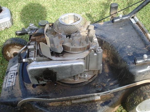

Funny story following this up, I just fitted up another blade boss, brand new bolt and washer and started it, pics are going to follow this chinese manufacturing excellence.
#23096 17/04/11 05:20 AM
I think from now on even if a chinese motor seems fine to me I will just pull it apart and sell it as parts, I should still get $60 n parts off this machine but I could have got over 100 if it was running right.
#23100 17/04/11 05:45 AM
So the flywheel came apart and that caused some collateral damage?
If the governor was working, it must have blown the flywheel at only 3,000 rpm, which seems just about inconceivable unless it was cracked. Also, that isn't the normal pattern of a bursting failure, it looks more like a crack propagation failure. Is there any way of knowing if there was a visible crack before you ran it?
And are you sure it is a good idea to sell parts that may turn out to be of the same quality as that bolt and flywheel? Both of those failures were capable of causing personal injury.
#23101 17/04/11 05:49 AM
the carbs and magnetos are pretty good on them its the acrual mechanical parts that seem to have troubles. It was running at a little higher than idle (around say the 2500 mark) it appears there is fine cracks all over the underside of it, also the keyway seems fractionally larger than it should be. if the flywheel has been avle to vibrate a little bit over time I guess it could have split it.
All the castings are very crystalised compared to the older engines also. This frame is a candinate for a decent australian 2 stroke engine and giving it a good run before finding a new home for it.
#23125 19/04/11 03:49 AM
Joe, the quality of the flywheel casting comes into question, but I think there's also a possibility the flywheel retaining nut was over-tightened and the flywheel was split at the hub before it even left the factory. The radial split just propagated when the engine was run. So, the flywheel might always have been split, and the main question is whether it split because it was overtightened, or because it was a lousy casting, or both.
