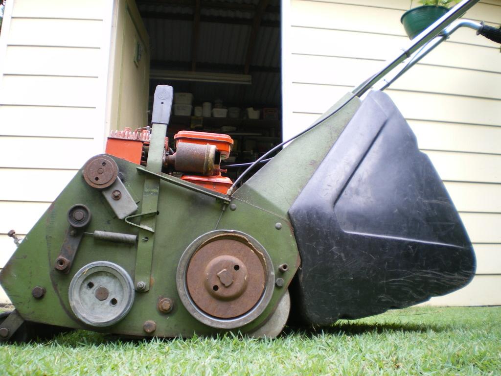

One last question, does anyone know how to remove the reel pulley?
I know it's on a left hand thread and have removed the bolt by jamming the reel and using the special tool I made for the clutch replacement, but the pulley is still attached and cant see how, and dont want to force it.
I need to remove the pulley to get to the bolts to remove the reel.

Kempe, you need to unscrew the pulley from the axle of the reel. As you said, it is on a left hand thread, because otherwise it would unscrew itself just from the belt drive torque. You have to make a special tool for the job: two bolts of the right size and the right distance apart to fit the holes in the pulley, attached to a piece of flat steel maybe 1/4" to 3/8" thick, about 15" long, by means of two drilled holes. You will have to hold the reel from rotating while you unscrew the pulley, probably with a piece of wood pushed through it (don't use metal, obviously).

Have done that Grumpy and have the bolt removed and the pulley rotates in both directions independant of the reel.
When you restrain the reel and unscrew in a clockwise direction it unscrews the bolt, not the pulley.
Do you know if the pulley just pulls off?, I have tried to gently persuade it to no avail, but being a bit cautious till I know
[Linked Image from i56.tinypic.com]
Hey Kempe,
I think it should just pull off. I've attached a close up of the other side of the pulley you're trying to remove. I can't remember it being tricky at all. It looks like it's just a tight fit. There was a spacer ring between the pulley and bearing. As it can rotate I would say its just worn into a slight groove. Like yourself though I'm no expert and just learning as I go. I would wait from some advice from the experts but I suspect a gentle hit from the inside should push it out - if the reel is out of coarse. Be carefull, I would hate to think my advice could end up making things worse!
I wouldn't think it's appropriate to include snippets from the manuals section as it's a paid subscription but I had a look and it tends to reiterate my first comments. There's no surprise parts in there except for that ring spacer.
Kempe, it looks from Pauly80's photos and information, and from the illustrated parts list, as if the pulley is pulled slightly onto the end of the reel's axle. If so it should come off easily with two screwdrivers under opposite sides of the reel, levering from both sides simultaneously. Do not apply a lot of force, or you'll damage the aluminium pulley. If it doesn't come off with simple screwdriver pressure you will need to screw a longer bolt into the thread until it bottoms with its head clear of the pulley, and use a gear puller to pull it off. As Pauly80 said, it should come off quite easily, and once it's slid about 2 or 3 mm it will fall off.
If you find you are needing to use a puller and seem to be applying a fair amount of force stop and come back to us, because we will have missed something, but I doubt that will happen. The bolt is the retainer for that pulley, and with the bolt removed it is only held by a short fitted section intended to ensure it is centralised with the reel's axle.

Still can't get the pulley off but don't have access to a puller and back to work on Monday so no time to play with it.
On the back burner till spring unless I suddenly get a loan of a puller.
Kempe you can use a slide-hammer puller instead of a gear (screw-type) puller. It should come off so easily that it wouldn't matter which you used. From Pauly80's pictures and description your pulley may have developed a groove in the wrong place at some point: it seems it should be a push or light press fit, but it may have been run without the bolt fitted, and has spun on the mating component until it became a bit loose but won't come off because of the groove. Pauly80 suggested this possibility a few posts ago. If that has happened, the hub of the aluminium pulley will have to get reshaped slightly for it to come off at all, but it should only be a shallow groove in a soft, cast aluminium component so a bump or two with a slide hammer, or a light pull with a gear puller, should get it off.
If this diagnosis is correct, you will need to touch up one component or the other with a file before you put it back together, so it doesn't give this problem again. Be careful, though - it sounds as if it has already spun enough to have become slightly loose where it should be a fairly tight fit.
