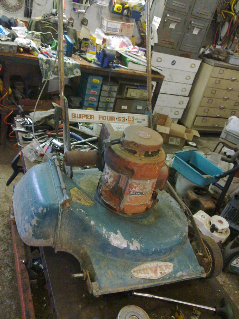

Dragged the super 4 into the shed and had a look at it. Got good spark and no compression. Well i didnt test it, it feels like it has none. No clearnace on the inlet valve. Inside the fuel tank looks bad.
Dont mind the mess.

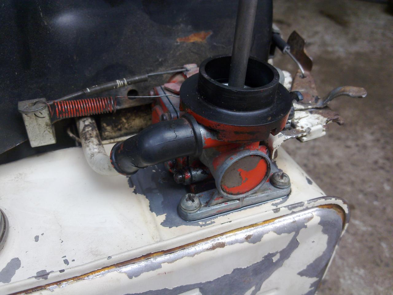

Put the cleaned out and kitted carb and tank back on the white motor and it started up straight away and runs pretty sweet.
But, the carb is leaking. I am hoping its from the gasket between the carb and the tank. I re-used the old one. Should i just cut a new one out of gasket paper and fit it dry?? Or put some non setting permatex on the old one?? Or get the genuine part??

I don't recognise that carburetor on your white 5 hp Bob. Is the gasket between the carburetor and tank actually a fuel pump diaphragm, like on the pulsajet? If it is, you will need a new one, and no messing about with gasket goo. If it's just a simple gasket like on the vacujet, I tend to put them back on with a bit of non-hardening goo if they are only moderately trashed (no breaks anywhere, just some surface roughness). However I'm a notorious cheapskate. If you goo them, you'll destroy them next time you take them off, so it's only a temporary solution.
That carb is the same as the one on the black motor.
Not that different to the one thats on the I/C motor.
Its only got the small diaphragm under that side pannel.
I might have a go at gooing it up.
If all else fails ive got the part number. lol.
I was thinking of going past the Mower place down in Altona North this morning. They have lots of random gaskets etc, thats from kits that have been split up and stuff thats been jumbled about etc.
Bob.
If you use a new thin cardboard gasket and put it on clean dry surfaces, with maybe a little engine oil on the gasket itself, in my experience you can usually dismantle and reassemble it repeatedly without damaging it. However any trace of other substances on the surfaces and the gasket splits (delaminates) when you take it apart. Of course it depends on the quality of the cardboard.
I have a roll of propper gasket paper here.
The old one looked OK. It busted through the screw hole, left front looking at it in the picture above. Think i will just try cutting a new gasket.
