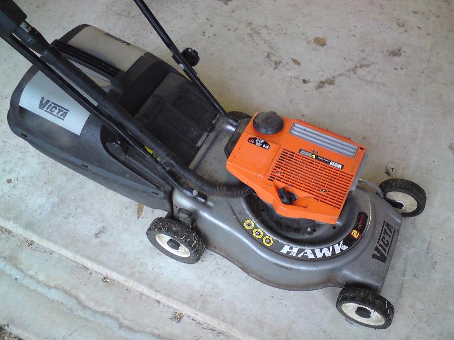

Well I tapped the starter holes that hold the top cover on and bought some suitable stainless bolts, purchased a new decomp valve and threw it all together. I pilfered the top cover and fuel tank off of the bung mower I bought as I prefer the larger fuel cap orifice of the older tank, plus the fuel cap has the fuel/oil ratio stamped on the cap should the sticker ever peel off.
I noticed it was a bit smokey when the seller fired it up for me so I mixed up some fresh fuel with the Shindaiwa 2 stroke oil I exclusively use. It fired up first pull and I was away. After the smoke cleared and with my ears buzzing I mowed a small patch and decided it passed it's first test. I'm in business.

aldot, if you use the correct oil to fuel ratio and a decent spark plug, it shouldn't smoke once it burns the carbon out of the muffler. There is a guy lives near me who runs an old Victa wreathed in blue smoke - it must be 16:1 or worse. He's happy, and he gets the lawn mowed - but whoever inherits that old mower from him will have a horribly carboned up exhaust port and muffler.

The muffler off the dunger is as clean and dry as can be! I guess the straight fuelling had something to do with that. After I finish this job I will pull the muffler and check the exhaust port.
It did stop smoking after about 20 seconds.
I will see next time how it starts now that the new fuel and oil is through the system. The old mix would still have been in the carby this arvy.
