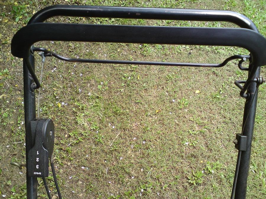

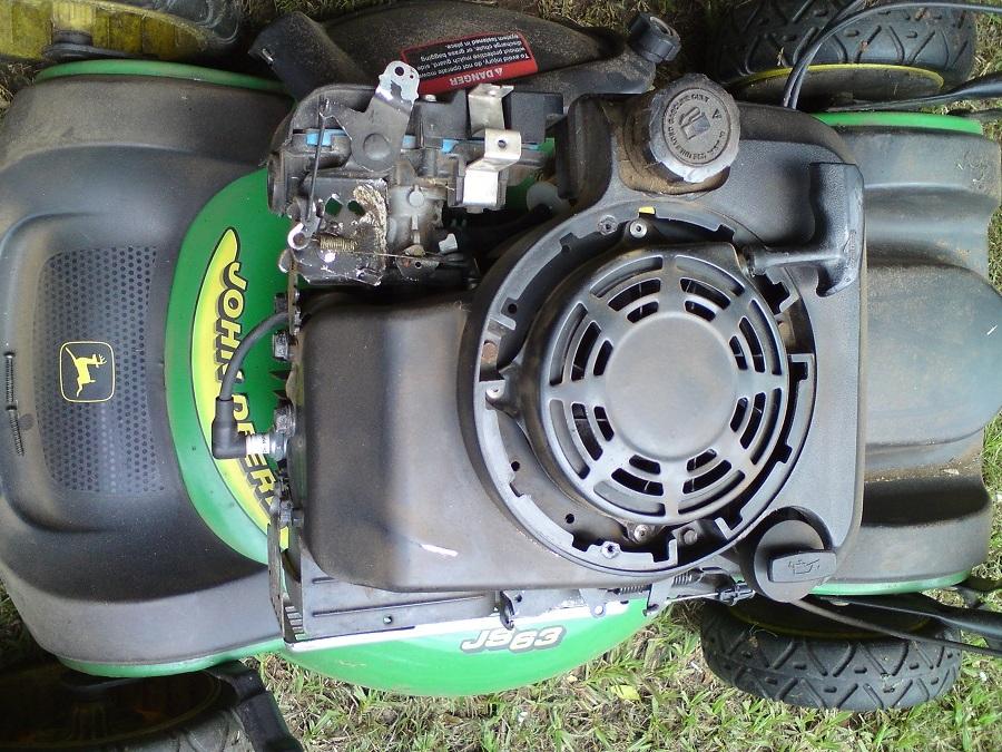

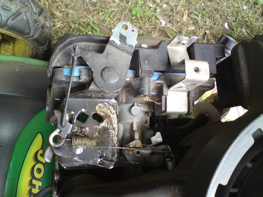

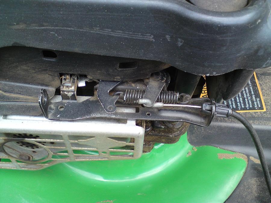

Grumpy here are some pictures
with engine cowl removed
carby linkages do not move at all
this is the mechanism which stops the engine when you release the top bar on the handle bars. Walking speed is controlled by a 3 speed gearbox.

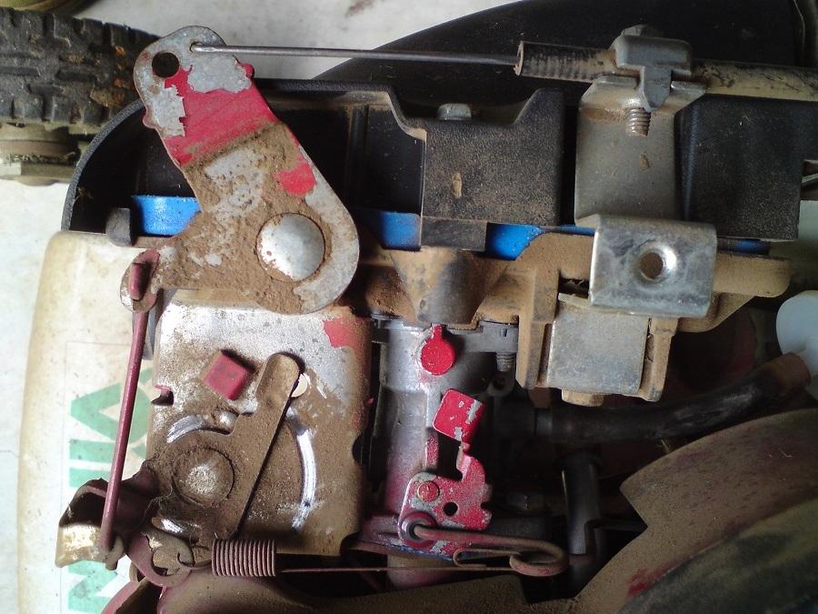

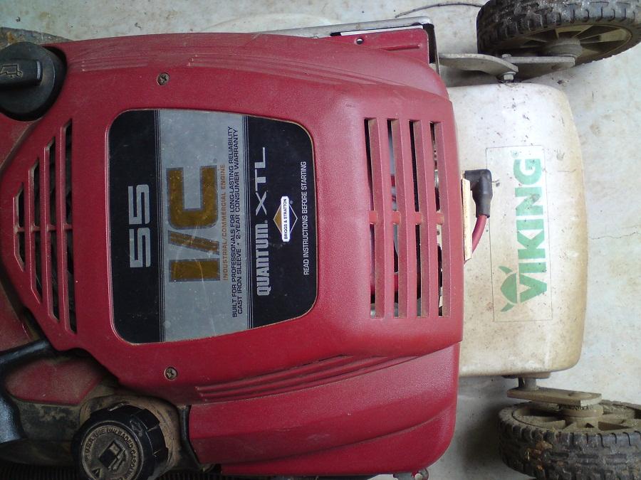

This is the setup I am used to on my old mower
aldot #21044 06/01/11 10:36 AM
Your first picture seems to show a normal speed control linkage, with the cable missing. The bracket that holds the cable outer is there, and the bell crank that connects the cable inner to the governor spring. The mechanism is the same as on your I/C Quantum engine. On the John Deere there is something that looks like wear marks on the paint on the bell crank where the cable would attach. Are there any signs of a screw having been in the screw-hole for the cable anchor, to the right of the speed control bell crank?
Does your John Deere dealer say it is not supposed to have a speed control?

John Deere lists no throttle cable for that model.
Just on closer look, the cable holder screw mount has no thread, just a hole. The throttle mechanism had a tab folded back preventing any movement. I grabbed a set of long nose pliers and folded it back and presto, it idles nicely.
Now to source an old cable and hand throttle mech.
aldot #21048 06/01/11 01:40 PM
That's what I'd do aldot. I think it will last longer that way, as well as being more pleasant to use. And I agree, if the cable outer anchor point has never had a thread tapped in it, it hasn't had a speed control cable fitted - JD made it without one.
