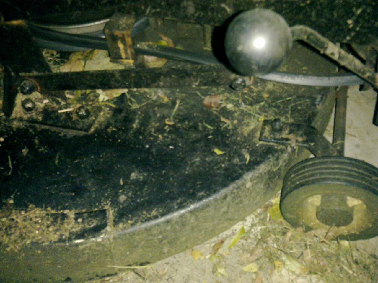

Hi there. I have only recently purchased this ride on and noticed that the front of the mowing deck is about 1 and a half inches closer to the ground than the rear when parked on a level concrete surface with the deck lowered to the ground but not touching of course.
There is a bolt on the upperside of the deck that sits about 2 inch proud and it isn't connected to anything. I was wondering if it is supposed to be connected to something? Is there a way to adjust the deck?
The sides are supported by chains and appear to be level.

aldot, can you post pictures of this please? As far as I know there is no workshop manual for the mower - only an illustrated parts list that isn't much help here - so we need to use either people's prior experience, or just inventing a solution. The pictures will enable others who have similar mowers to tell us how their decks are supported at the front. Obviously you have to end up with the deck level - it is just a matter of what the missing front support should look like.

![[Linked Image]](https://www.outdoorking-forum.com.au/forum/uploads/usergals/2011/01/full-4279-221-04012011231.jpg) Mine looks like this, sits fairly level. The plate on the left connects to a chain. 1 on each side

Thanks Mattrob. I didn't get a chance to take snaps due to light but I did measure it and the sides are dead level but the front has a definite lean. One of the Greenfield mobs, (ringing today for clutch prices) said that all the decks lean to the front. I'll snap some shots with a ruler in place to give a better indication.

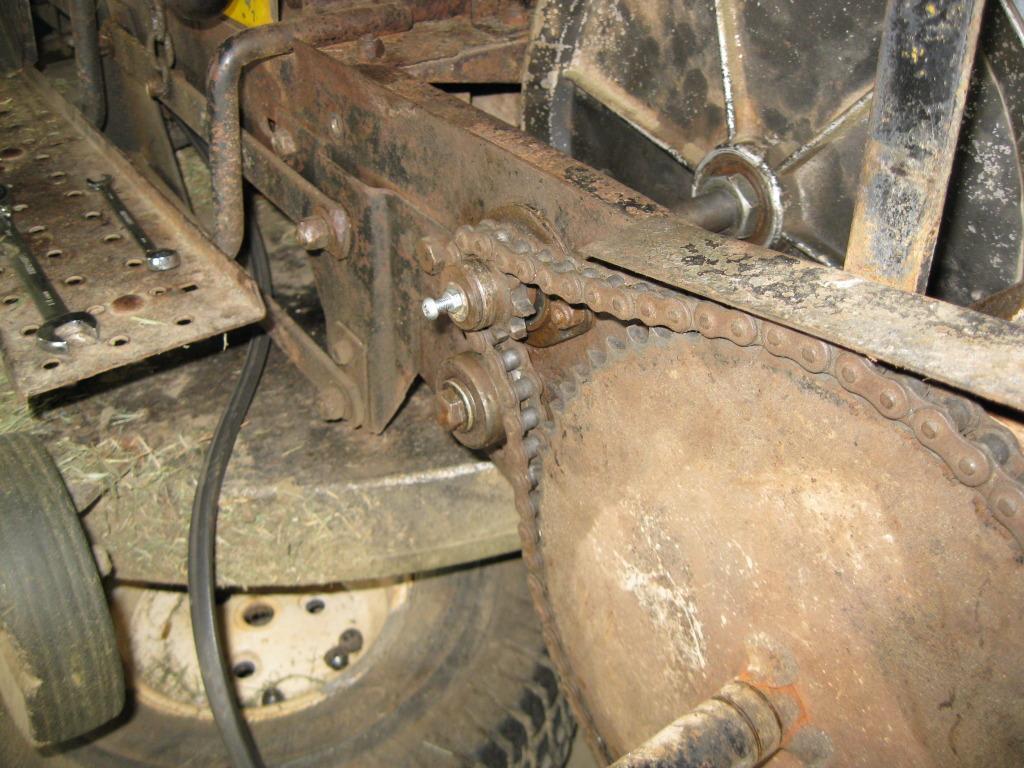

Hi Grumpy, here is a picture of the old sprocket Got my bearings mixed and posted this in another thread. I was going to wrap the new chain and see if it fits sung down into the sprocket. I don't want to ruin a new chain but $250 for a sprocket welded to a bare shaft is a bit rich.

As far as I can tell that sprocket has never slipped: the points would be rounded if it had. The points do not seem to be undercut either, so it doesn't look badly worn and hopefully the chain will fit it fairly well. That is often the case with very large sprockets: you'd wear out a whole bunch of the tiny ones before you had to replace the big one. So, I won't be surprised if you find your chain fits it like a glove, but please go ahead and make the check, then tell us the result.

This picture, re-posted from Dave's thread, shows the idler. It is mounted directly below the small sprocket. ![[Linked Image]](https://www.outdoorking-forum.com.au/forum/uploads/usergals/2011/01/full-2772-279-full_2772_126_img_0437.jpg) Does your mower have this idler?

Hi Grumpy, no it doesn't have that idler. If you look at that picture and see the flat bar weled above the large pulley, mine has a 4 inch strip of that directly where the idler is in that picture. It protects the chain between the sprockets from rubbish. I'll try and grab a picture.

Hi folks here is the picture of the sprocket set up on my Tractor 11 VE. There is no idler pulley just this shield. ![[Linked Image]](https://www.outdoorking-forum.com.au/forum/uploads/usergals/2011/01/full-2772-376-dsc00453.jpg)

Thanks aldot. We still don't know if Dave's idler was original equipment, or a modification by a previous owner.
